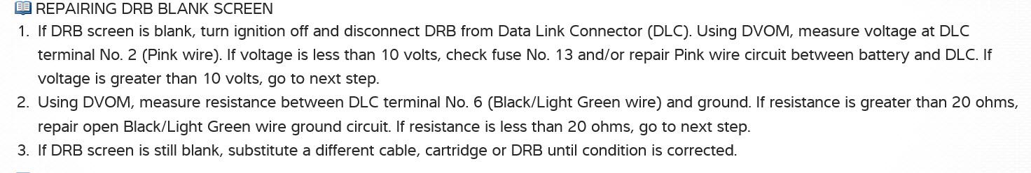

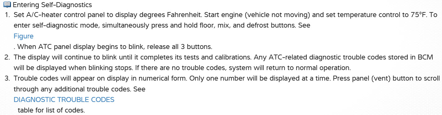

check with first picture then if screen is no longer blank follow second picture.
