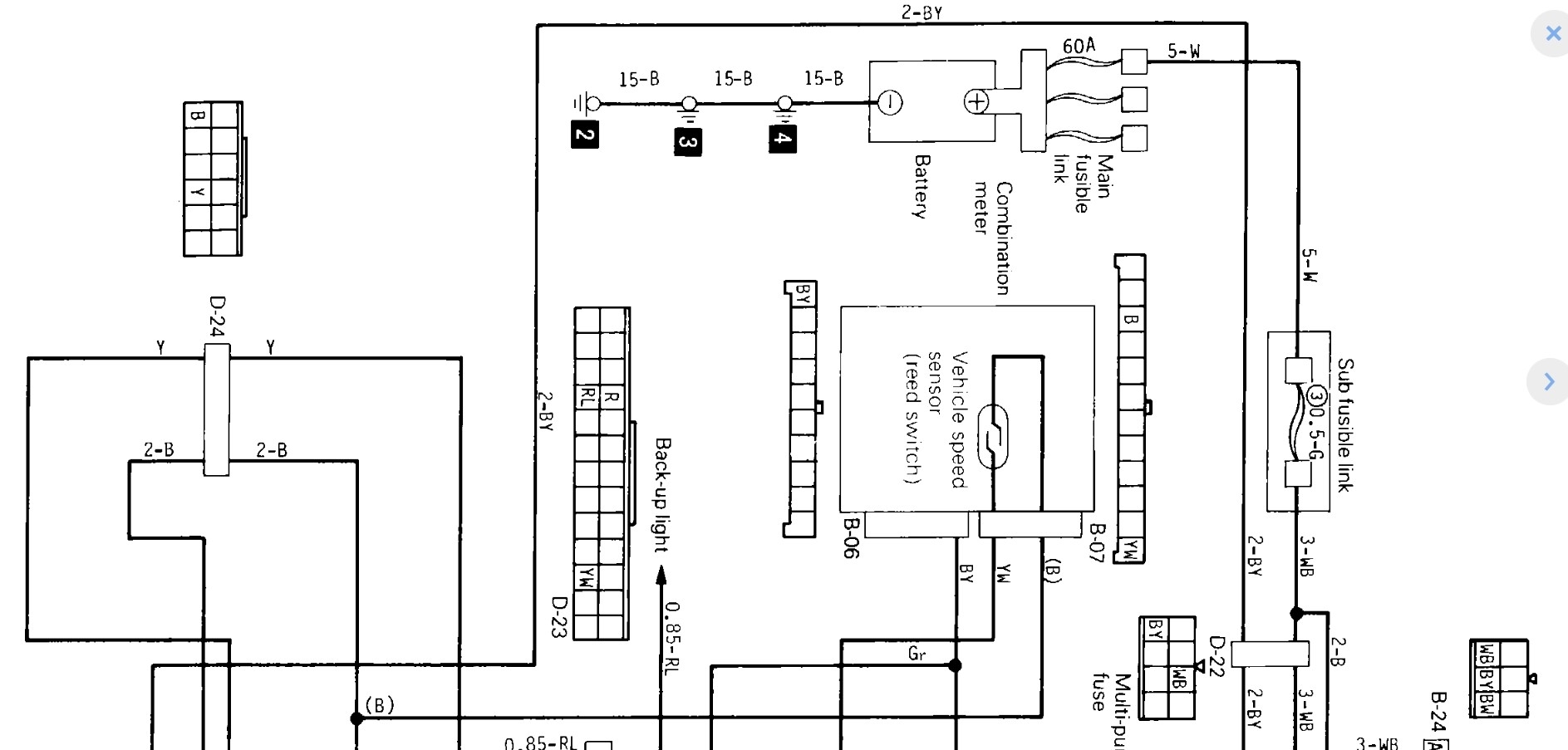

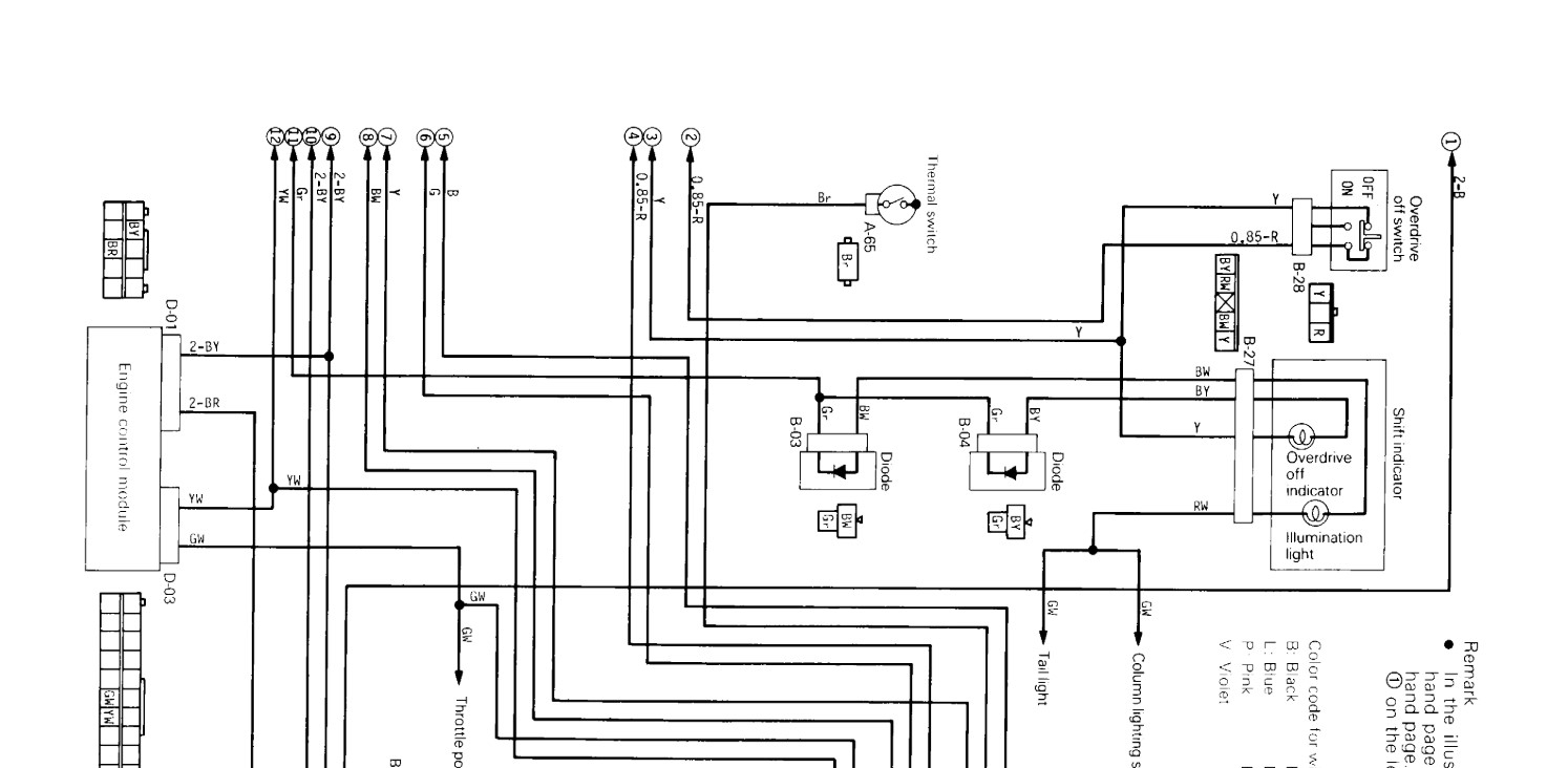

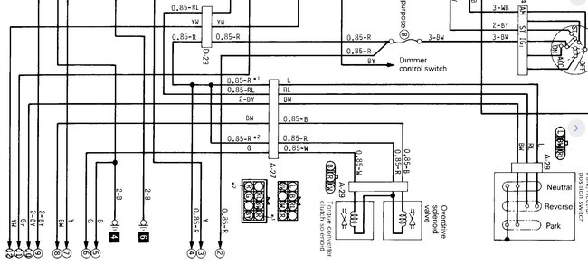

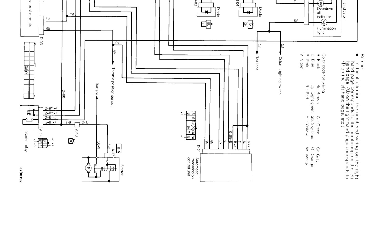

Looking for pinouts for rpm signal and TPS to gearbox controller it has a 26pin plug part number on controller mr145308.

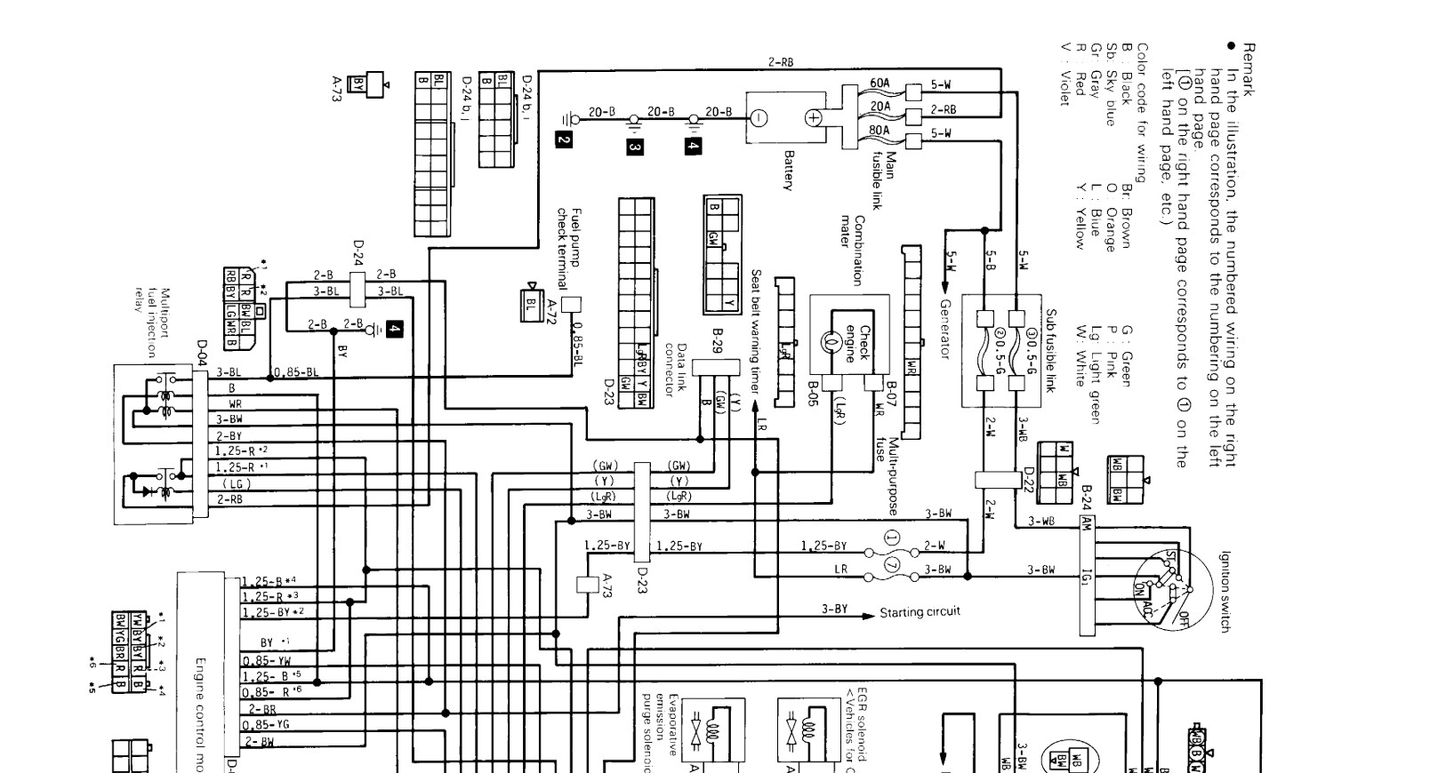

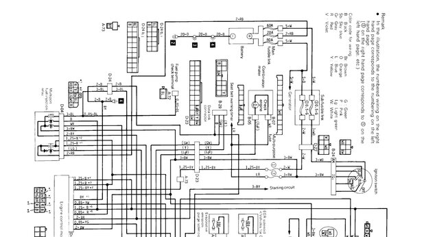

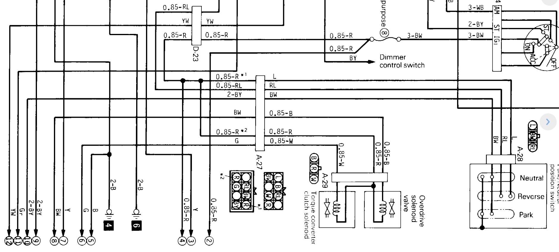

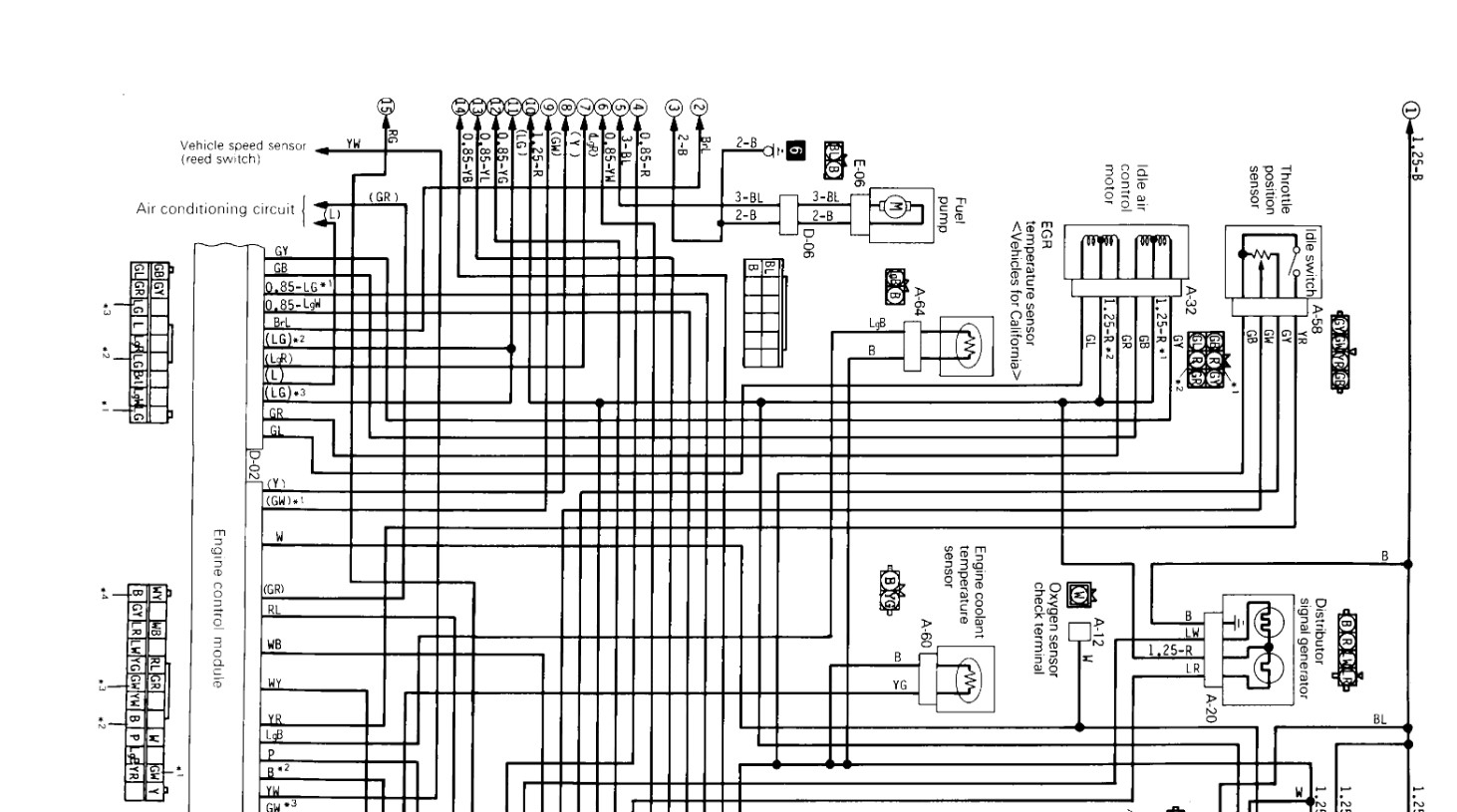

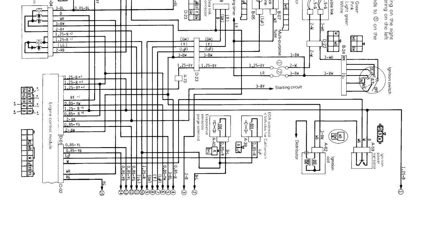

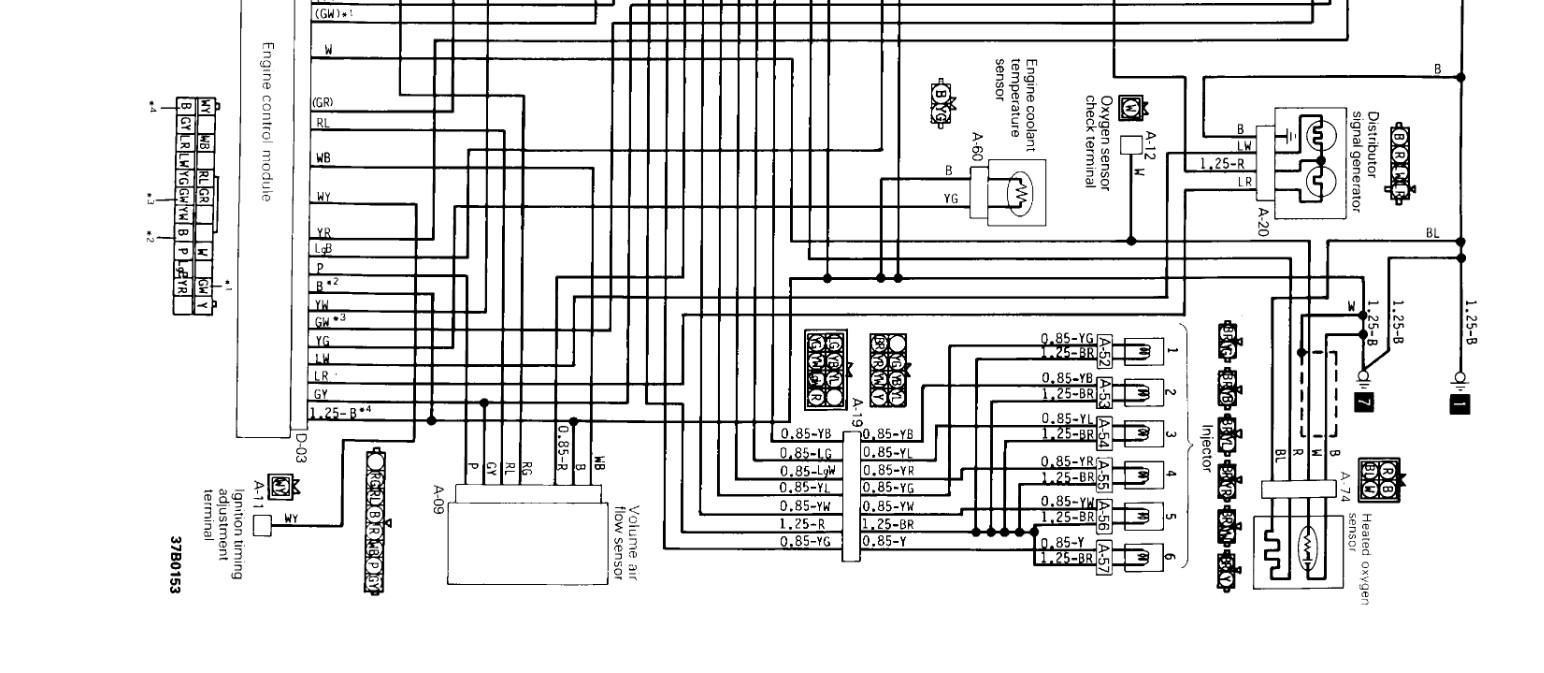

Well I have been digging around and this is the only thing I've really found. These are for the Mighty Max in 1995 with the low emissions and automatic transmission. The first 4 are transmission. Last 4 are engine. However, it was being sent to the US so things may be different.
