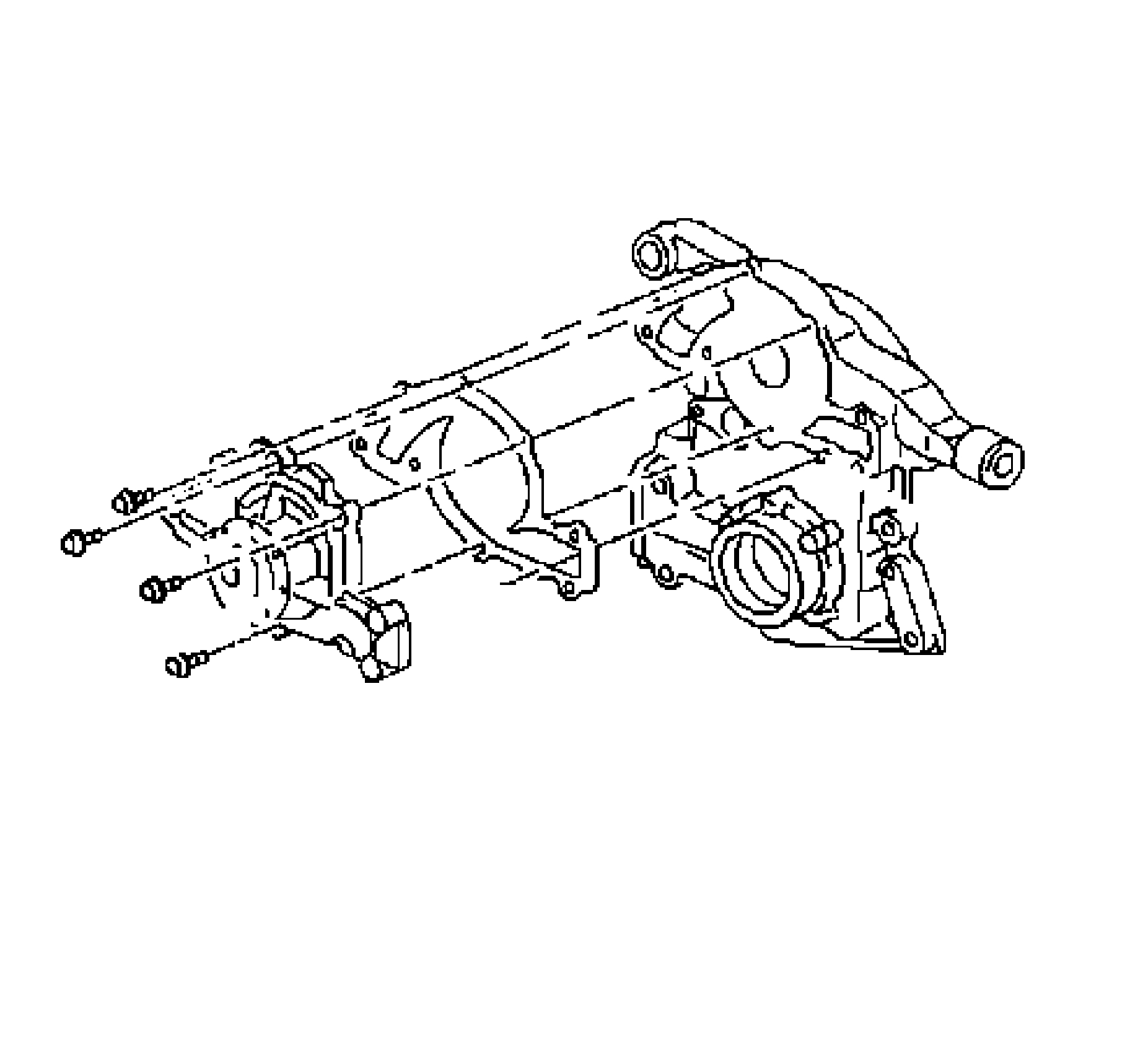

If you find the tensioner is bad, here are the directions for replacement. Picture 3 correlates with these directions.

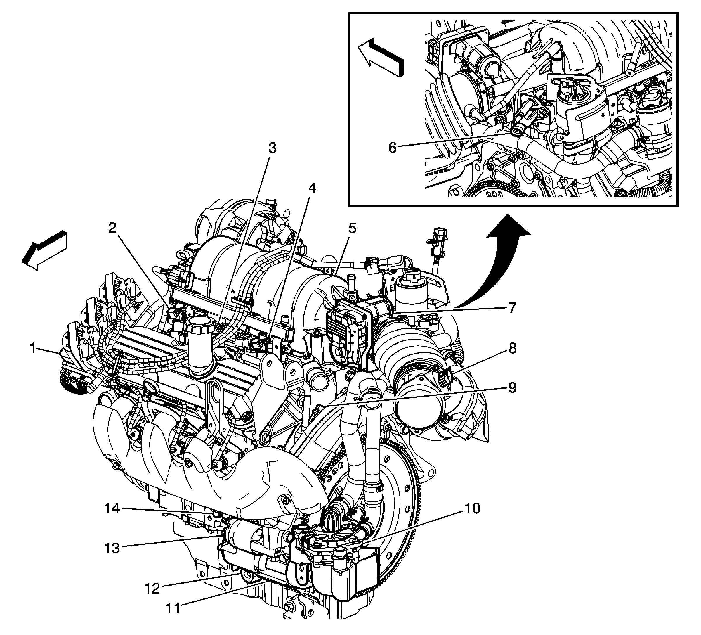

Which is where?
Dec 25, 2018 at 10:58 PM
Hi:
It's number 9 in the picture.
