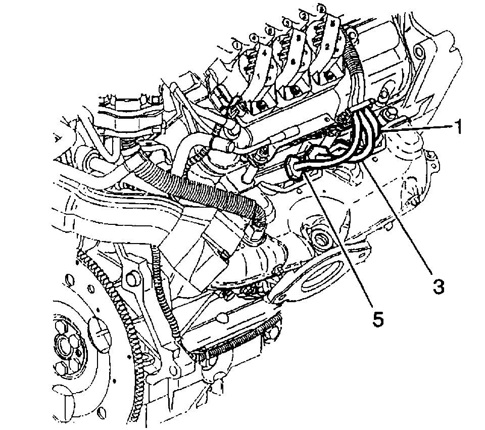

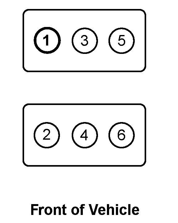

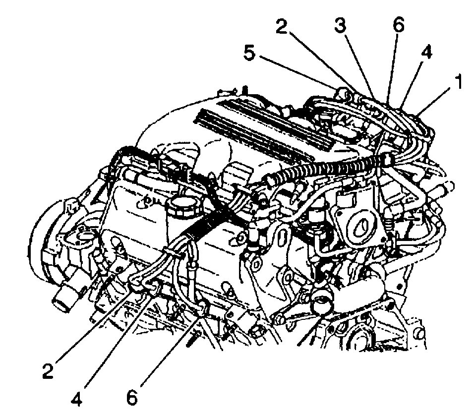

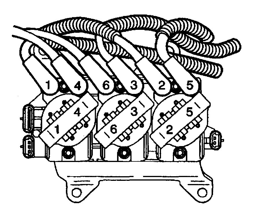

Your information was very helpful in confirming the wiring connections.
