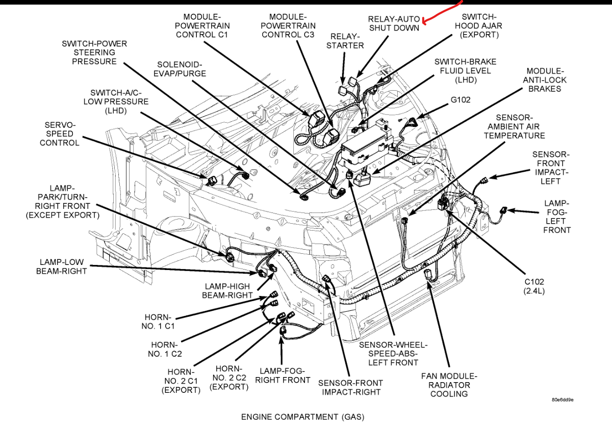

Need to know where the ASD relay is located. The actual relay not the fuse. I was told they're 2 separate things... Is it on the driver's side firewall?

The auto shut down or ASD relay is located on the firewall on the driver's side. here is a guide to help test it and the location specifically in the images below.
Check out the images (below). Please let us know if you need anything else to get the problem fixed.
