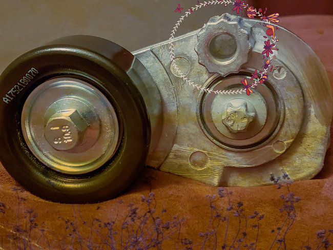

I have a pulley tensioner pictured with a circle around the question for clarification is this where I release the tension so I'm able to remove belt in the mean time? thanks.

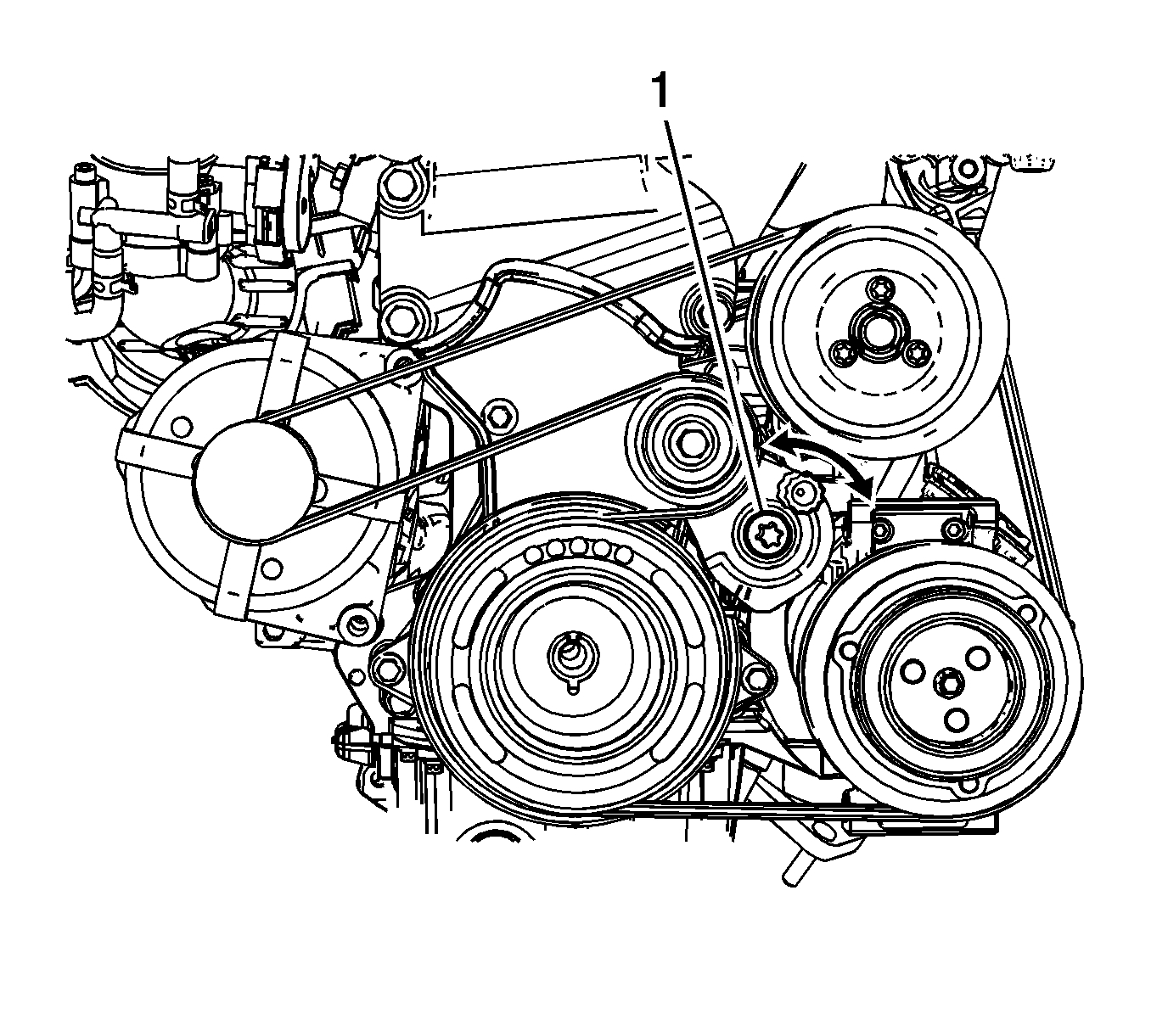

Yes, that is correct. Here are the specific directions for belt replacement.

1. Rotate the tensioner star-nut (1) and remove the accessory belt.
2. Remove the power steering belt. Refer to Refer to Power Steering Pump Belt Replacement (See: Drive Belt > Removal and Replacement > Power Steering Pump Belt Replacement).
Installation Procedure
picture 2
1. Install the power steering belt. Refer to Power Steering Pump Belt Replacement (See: Drive Belt > Removal and Replacement > Power Steering Pump Belt Replacement).
2. Rotate the tensioner star-nut (1) and install the accessory belt.

Okay, I'm confused by the pictures. Both pictures have a number one with a line drawn down to bolt, that bolt is what keep the tensioner assembly locked and secured to the block. Then I see a two headed arrow. My question is, the picture I have up loaded with circled around 12 grove nut looking thing is the where my socket will hook up to release the tension.
Jun 6, 2019 at 8:06 PM
Yes, that is correct. Basically, the tensionier pivots. Move it away from the belt to release tension.
