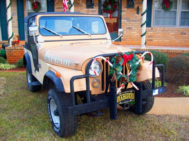

Back to my opinions, I run aluminum wheels on my CJ5, I check my lug nut torques about every three to four months. For some reason they sometimes will get a little loose. I cannot see compounding that possibility with even more mechanical's to be involved.

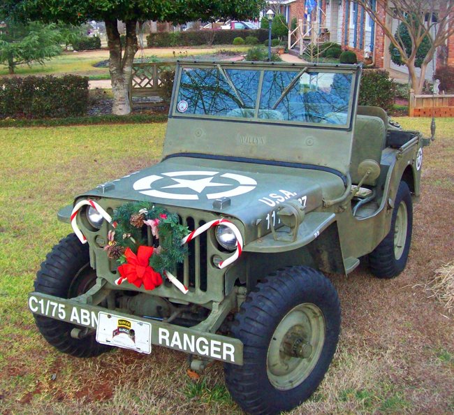

I also cannot "see" going wider, I can squeeze my Willy's into/through some tight spots, even a bit wider my CJ5 can do some squeezing too. During mid CJ production they widened the axles even more, and ever since it looks like everybody wants to widen more and be a Hummer. It is easier to squeeze through the woods than to run over them!
