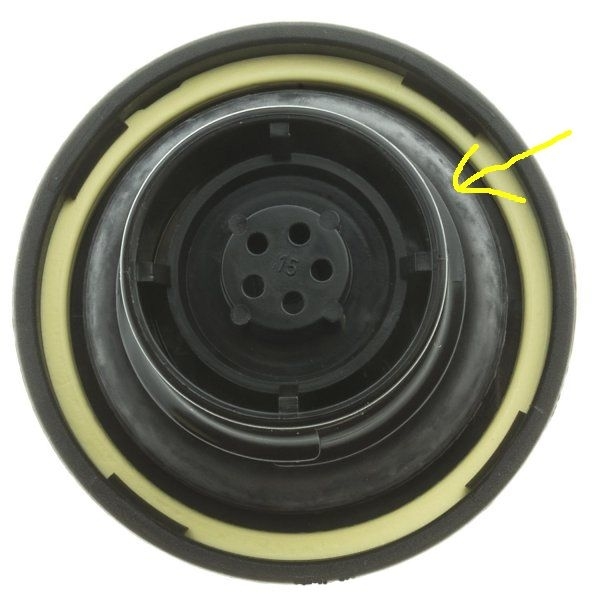

It is possible to test the cap, however the time it takes for a shop to test it would likely exceed the cost of a replacement cap. To look at it visually you want to look at the rubber gasket marked with the arrow. It should be soft and pliable with no cracks or damage. Then look into the filler neck for any rust or dirt in the area the cap seals. Rust or dirt there will cause a leak. I have done a band aid repair on them if they are rusty, you use some fine scotch brite material to scrub the rust away then put a couple coats of paint over the rough area.
