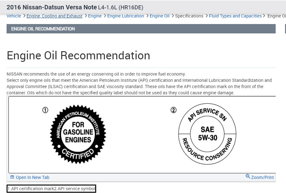

So, if you are changing it every 5K miles or up to 1 year, you are fine. However, a heavier-weight oil is questionable. Remember, the heavier the weight, the longer it takes to move it. Most engine wear happens when it is first started and oil is starting to pump. The manufacturer recommends 5w30 (see pic 1) for this vehicle, so although heavier-weight oil shouldn't hurt (especially if you are in a hot environment) it really isn't needed.

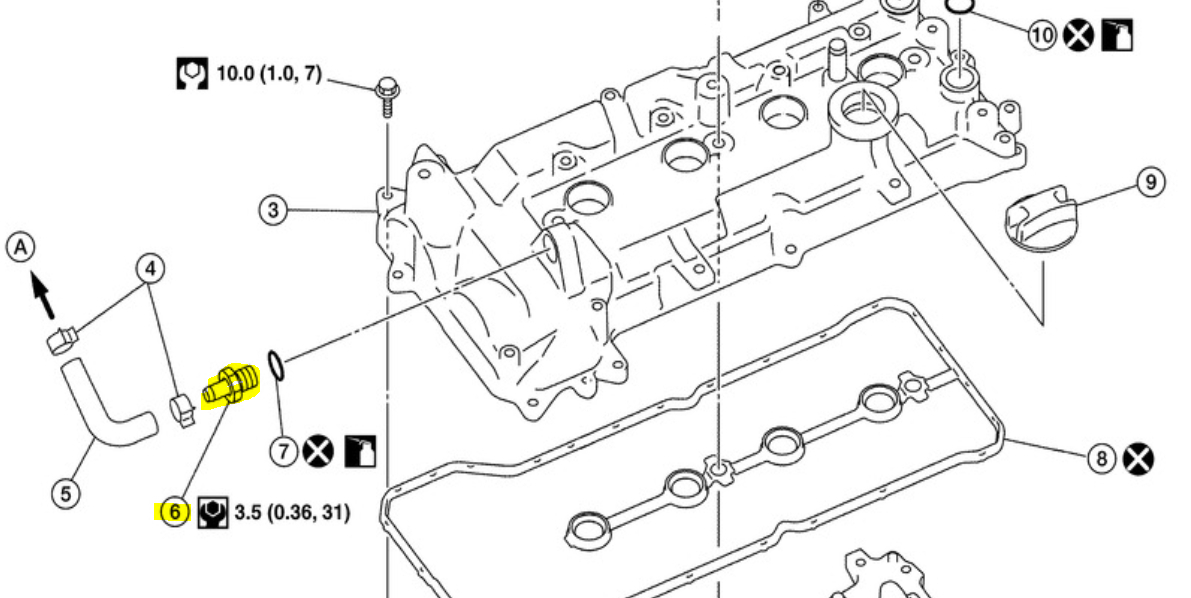

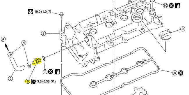

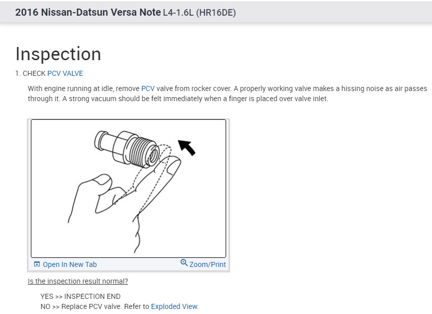

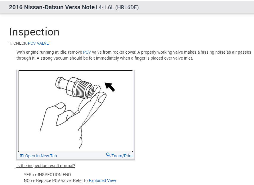

Also, you mentioned the PCV. If it is plugged, it will increase crankcase pressure and moisture to develop in the engine and oil. So, make sure it is in good condition and there are no leaks. See pics 2 and 3 below for testing and location.

Thank you JakobAndNickolas, I forgot to mention that I live in Central Florida and the temperature there never drops below 25 Fahrenheit or -4 Celsius and I have heard that 10W oil is good for temperatures as low as 0 Fahrenheit or -18 Celsius while the 40 weight oil cushions the engine better than 30 weight oil when the engine is hot, and Florida's lowest temperature ever is -2 Fahrenheit or -19 Celsius which happened in Tallahassee in far North Florida in 1899, and I heard that 5W oil is only needed when the ambient temperature is below 0 Fahrenheit or -18 Celsius, I have a question about the PCV valve diagram or graph or composite sketch, it shows the valve cover is being removed, do I need to remove the valve cover to access the PCV valve? Because when I looked at it in the engine compartment I saw that the PCV valve is external and externally attached to the valve cover and all I might ever need to do is pull the PCV hose clamp, PCV hose, and unbolt the threaded PCV valve and PCV valve O-ring style gasket, thank you in advance for enlightening me and informing me JakobAndNickolas, Alexander Stathas
Aug 8, 2023 at 1:53 AM
Hi Alexander, the PCV is external. The pic I have is an exploded view that takes everything apart. LOL And I'm a little (lot) north of you in PA.

The PCV won't cause engine failure, but it will cause a rough idle if there is a vacuum leak. As far as the heat is concerned, keep in mind, the under-hood temperature is much higher. With the vehicle being 9 years old, it could have dried up or cracked, so take your time and inspect it.
If you want to check for vacuum leaks, here is a link that explains how it's done:
Aug 9, 2023 at 8:37 PM
