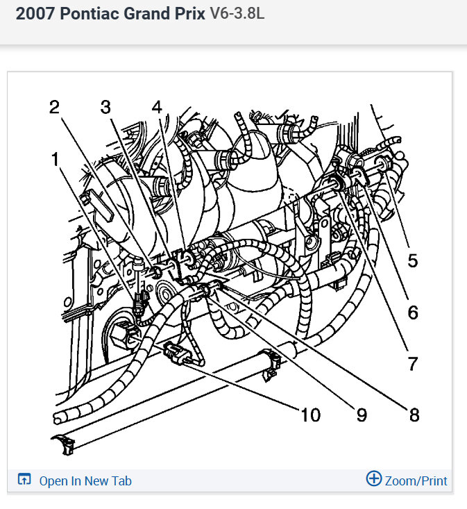

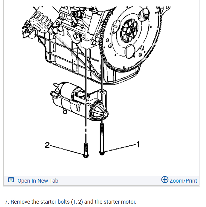

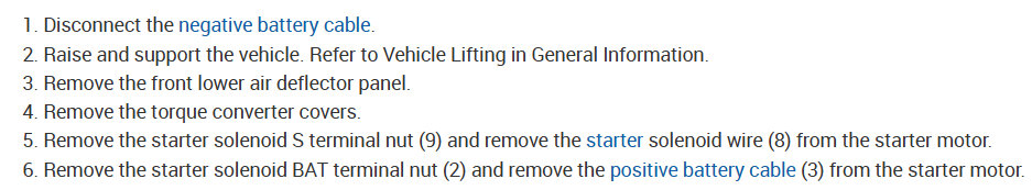

It sounds like the starter wiring is not correct or touching the block or ground somehow. If you can upload an image if the starter solenoid wiring, I can check it out for you, also it could be a defective starter motor. Here is the correct way to install the starter in case you need it. Check out the images (below). Please upload pictures or videos in your response of any problems so we can see what to help you with.
