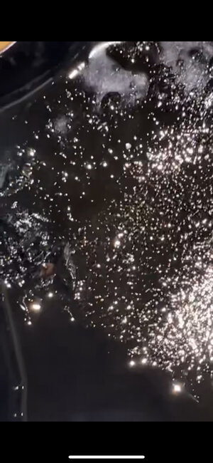

The oil pressure light was and has not been on at any time. Below is a picture of the shavings in the bottom of the oil pan.
Apr 19, 2023 at 9:07 PM
That doesn't look too promising. Have they inspected the engine oil pressure solenoid? Also, how did the original turbo fail? In other words, did a bearing fail?
