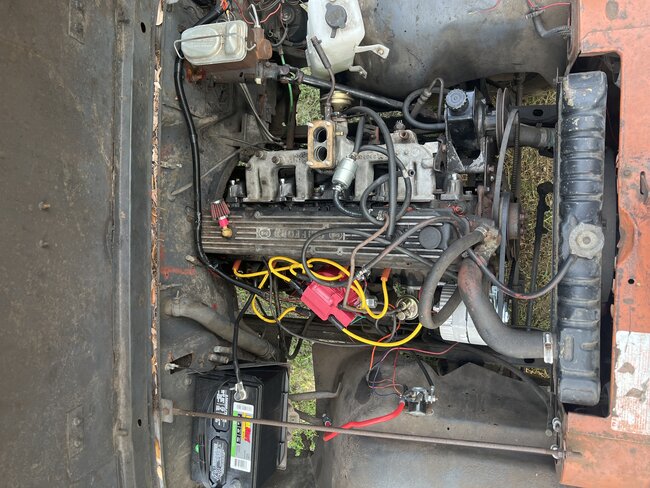

Can you send some pics all over the engine with the breather removed?

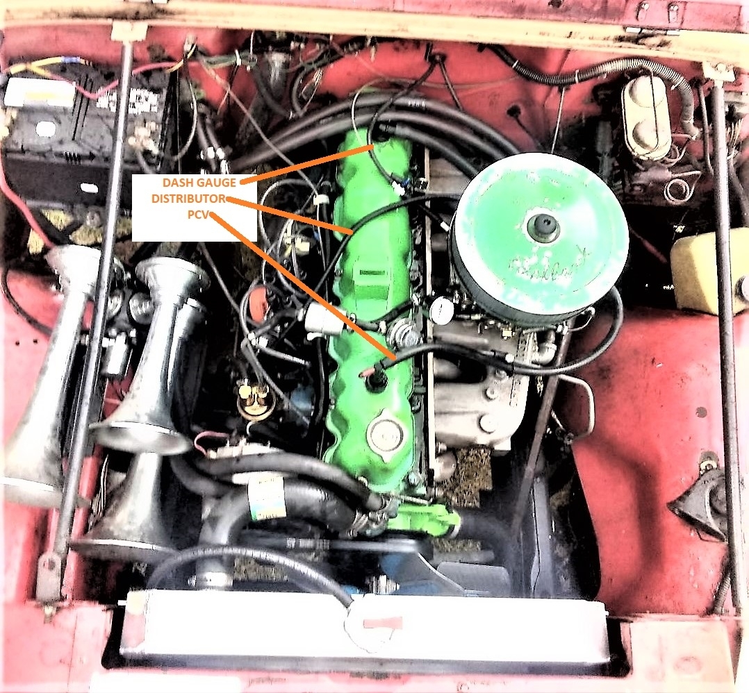

I would love to know all of the vacuum locations as well.

Another thing I only have like two vacuum lines, one from the distributor and one from the valve cover to the carburetor. This can't be right from the more than a dozen I have seen on previous diagrams.

More pics?

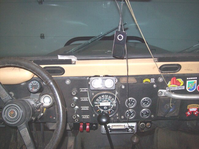

and what is that Dash Gauge for?

Do you have all of the vacuum ports plugged off that are not in use?

More pics ! Especially top and driver's side

Make sure it is not sucking air somewhere! Cap/ plug/ etc any open lines.
Here's my "Dash Gauge"---it is not a must at all!
I have it to diagnose my Goods or Bads, or tuning! (It's usually goods)
Mine is The 1st scenario in the video!
https://www.youtube.com/watch?v=NrnzD7PgoHI
Here's my dash vacuum gauge---it's the top right one over the cigarette lighter

i need to get u a picture of the engine bay again if i cant find one tonight i will take one tomorrow when the sun is out. i want to thank u for helping me try to get my ride running , i know im missing out on some fun . i havent been able to really take it out since i got it.
