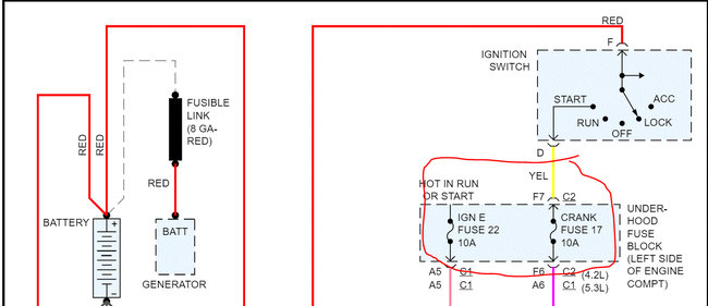

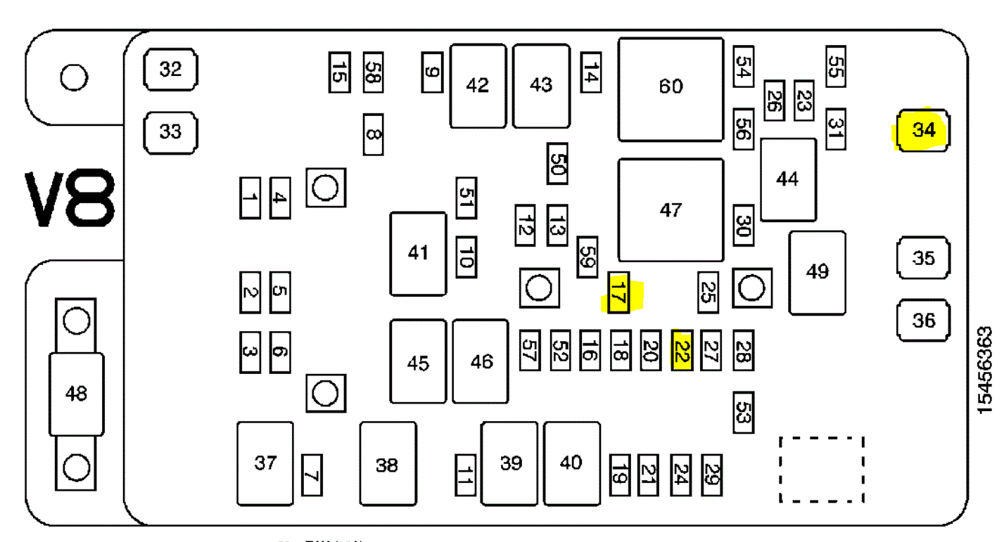

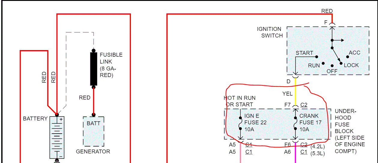

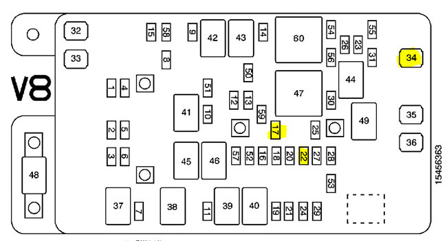

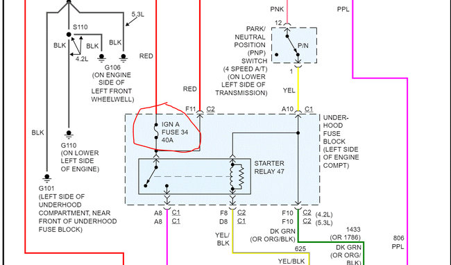

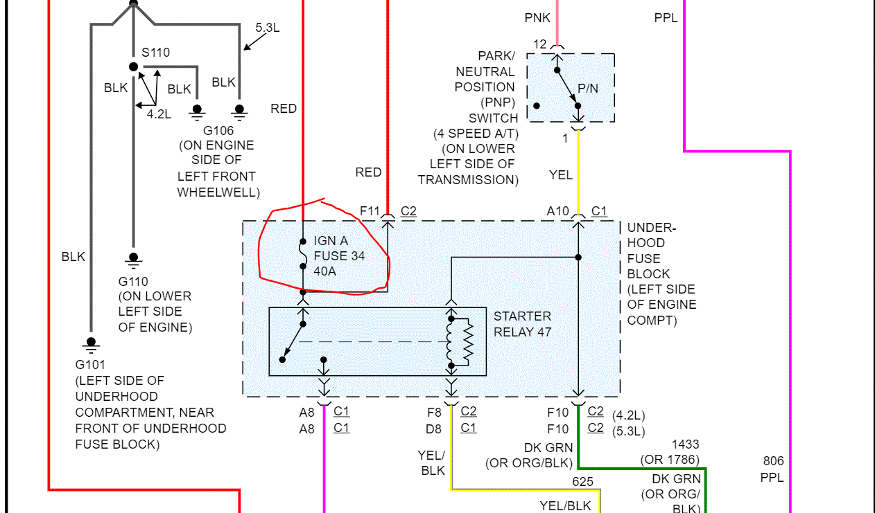

I need you to check three fuses. In addition to checking the fuse condition, confirm there is power to them. Here is a link to help with that:
See pics below for fuse identification and location. I highlighted the ones to check in the under hood fuse box.

There is power going to 34 and 22 and not to 17.
Aug 4, 2020 at 5:40 PM
Fuse 17 is the crank fuse. It should have power when the key is in the start position. You will need a helper. Or, have you already checked it that way?
