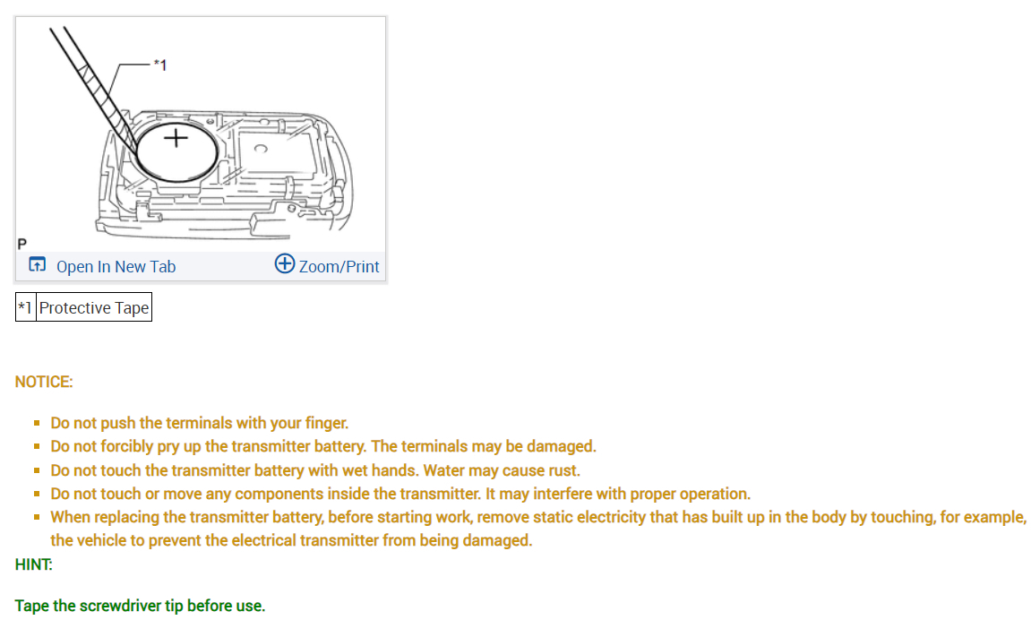

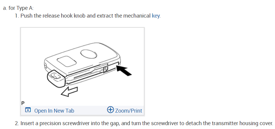

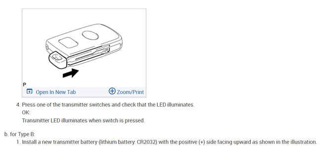

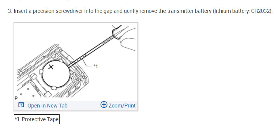

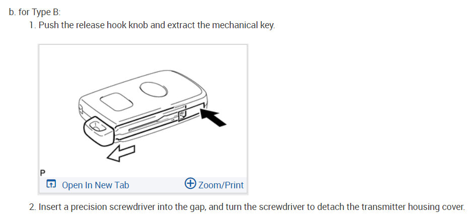

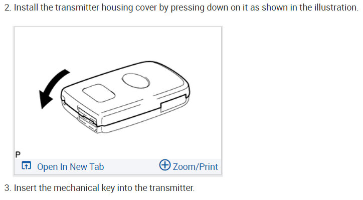

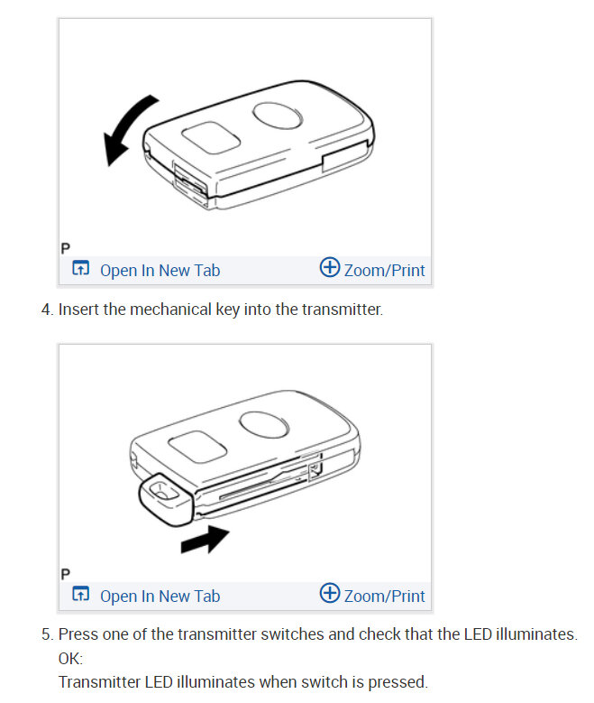

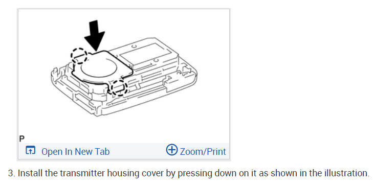

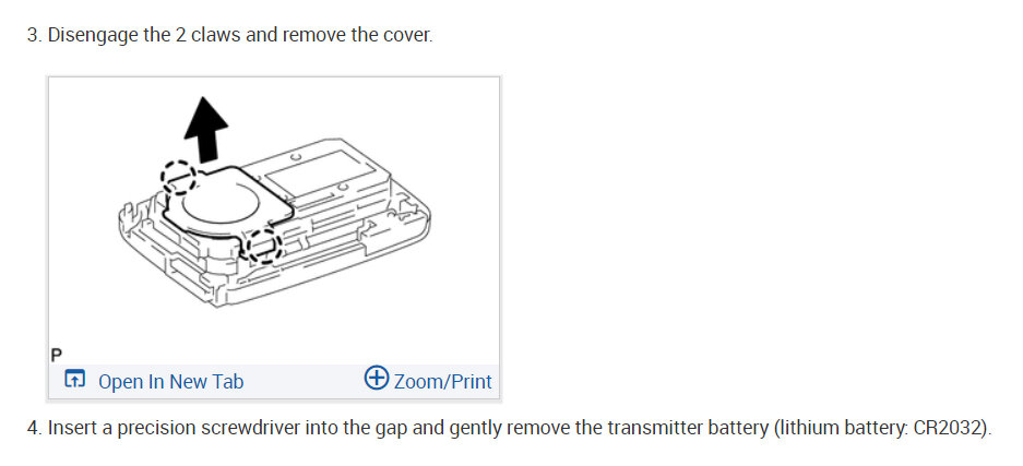

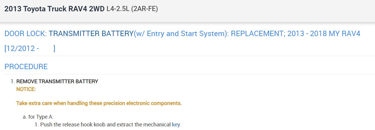

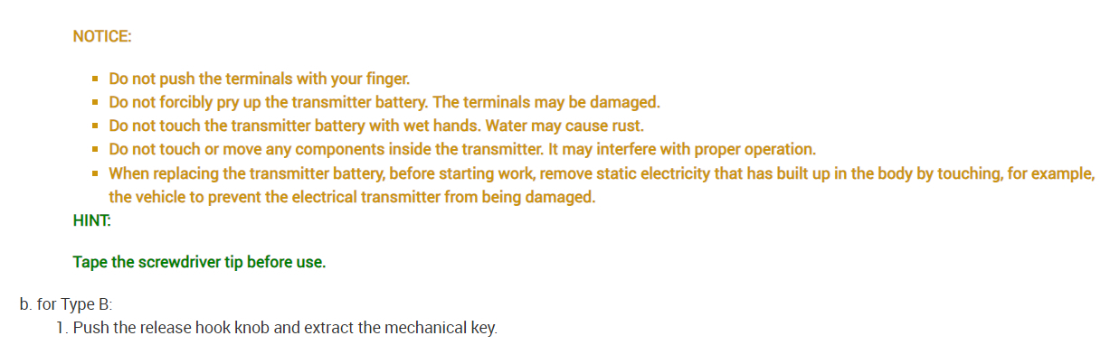

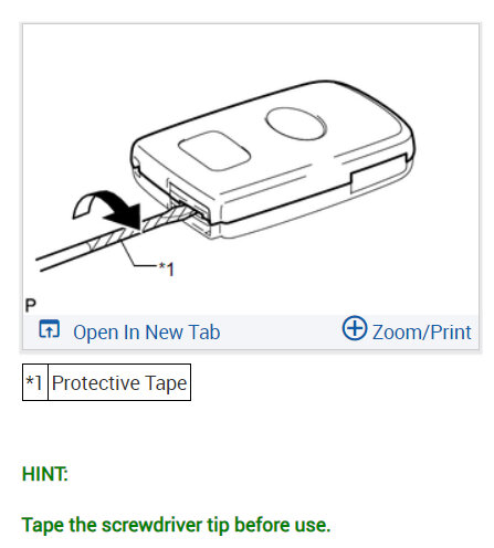

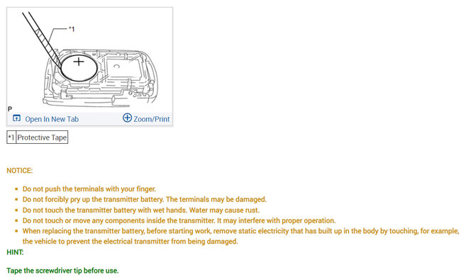

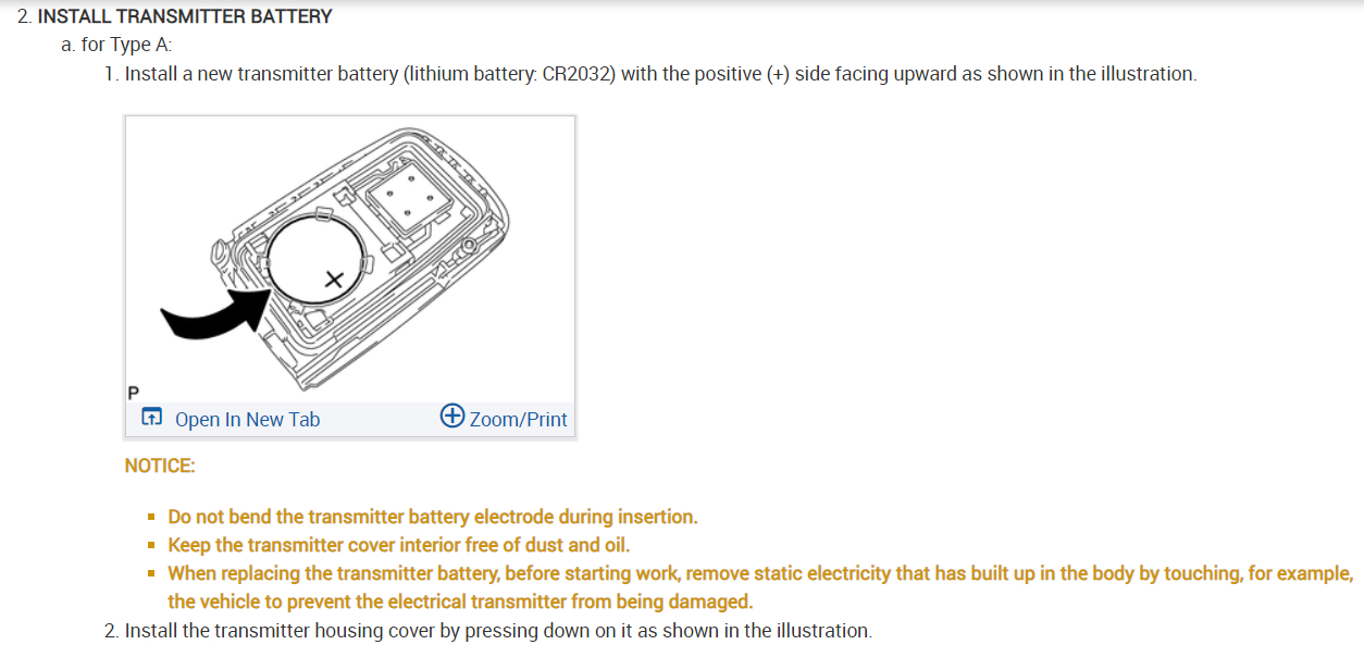

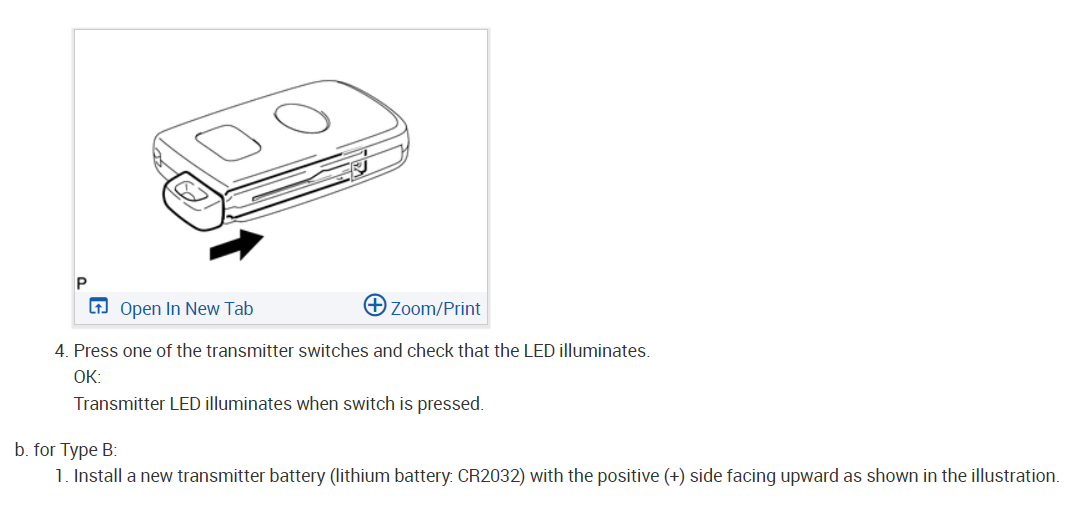

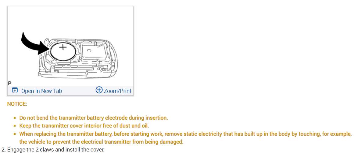

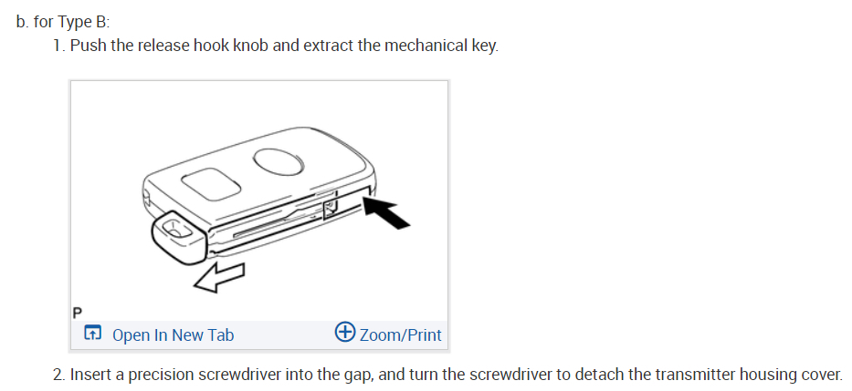

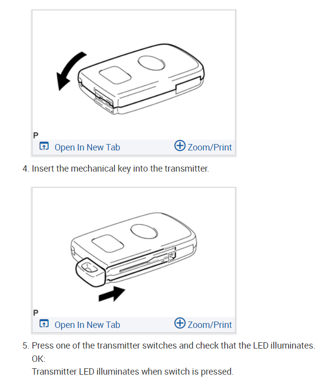

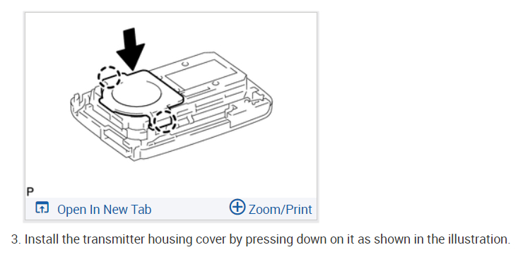

Yep this happens when the key fob battery needs to be replaced, here is the instructions on how to do so. Check out the images (below). Please upload pictures or videos in your response of the problem so we can see what's going on.
