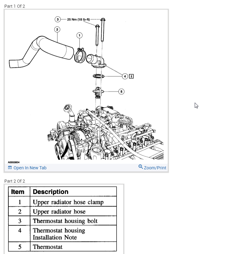

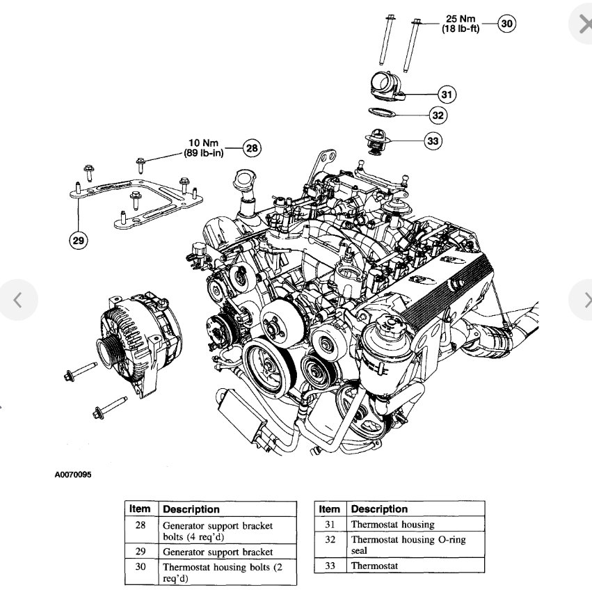

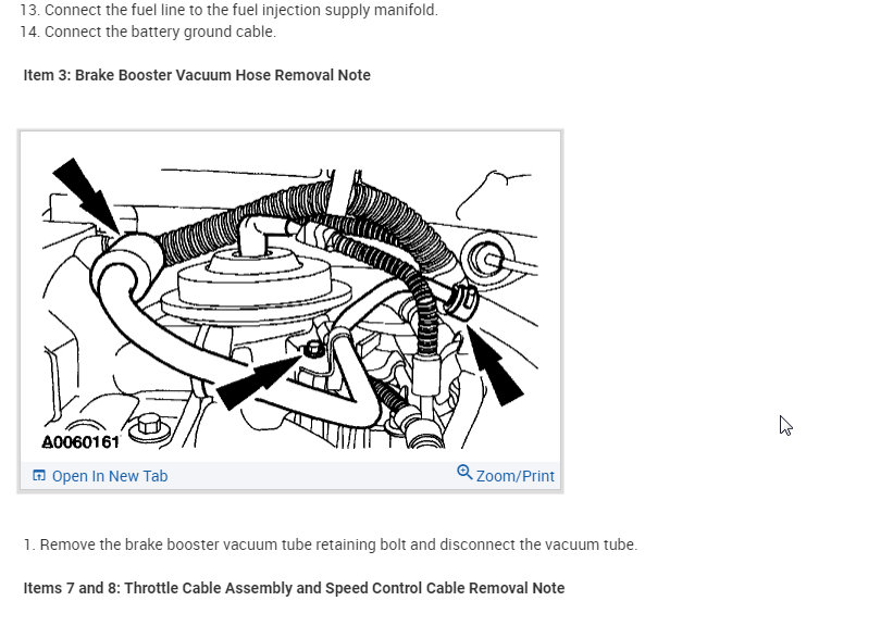

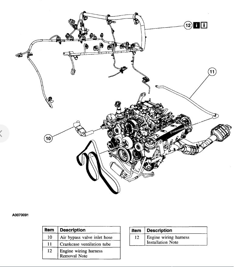

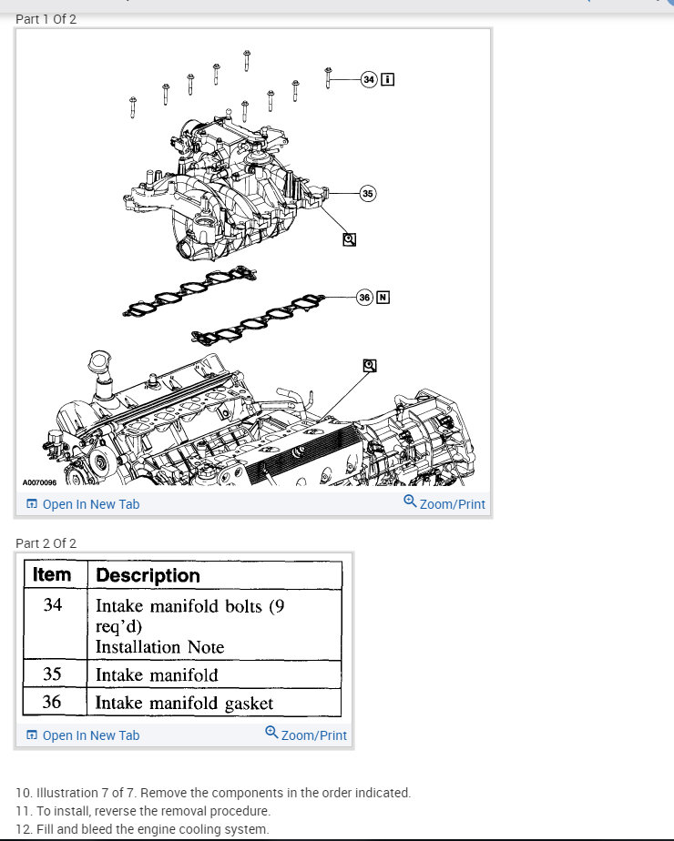

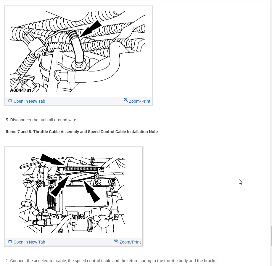

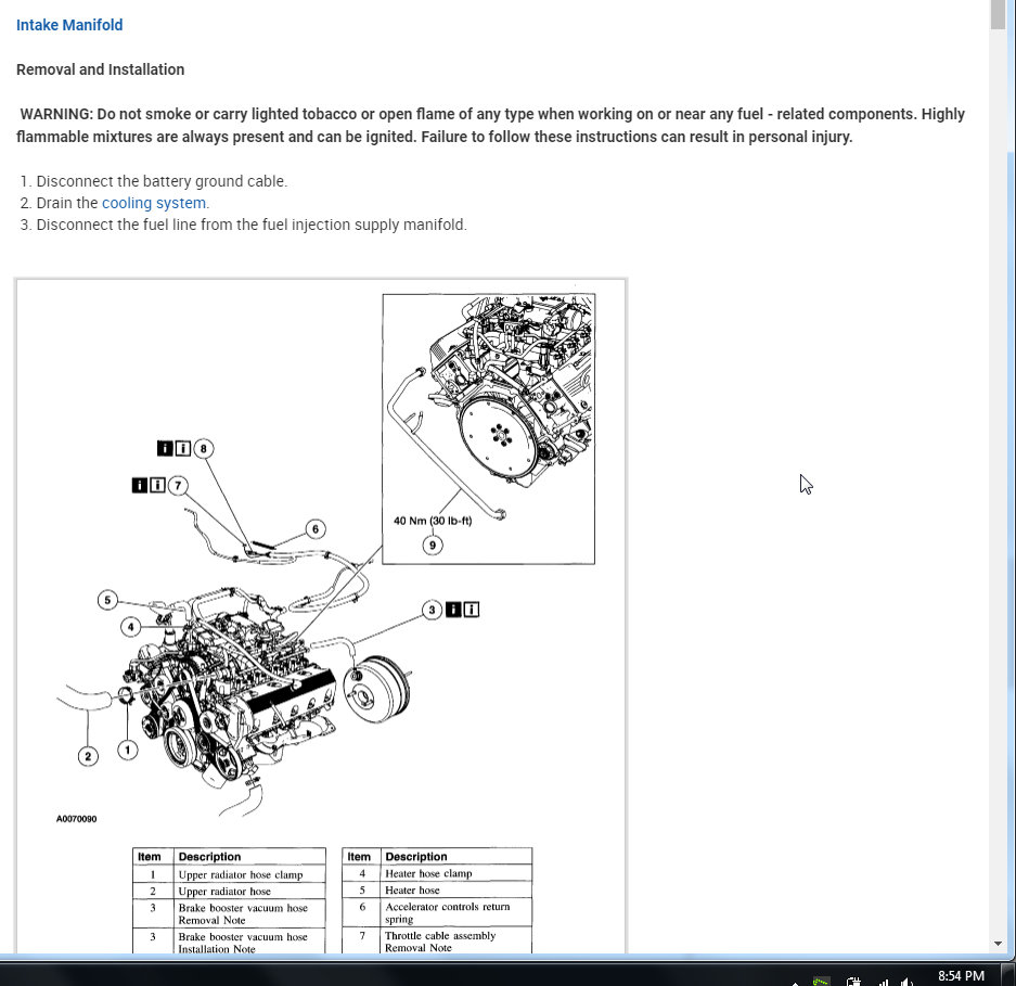

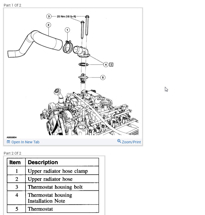

I asked what the part was that the thermostat housing was bolted to, and a mechanic answered it was the water pump. I disagreed and after researching it looks like the crossover. Could this be right?
