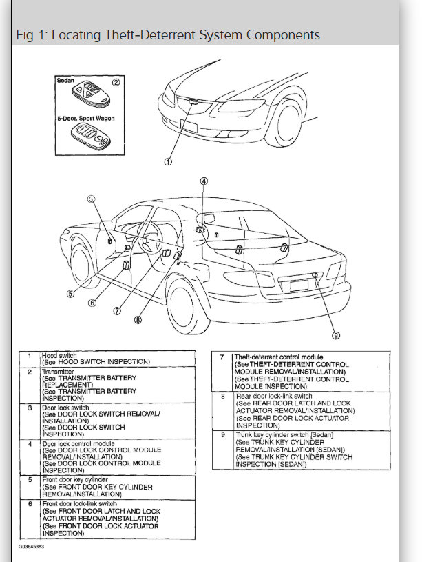

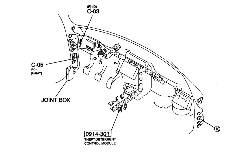

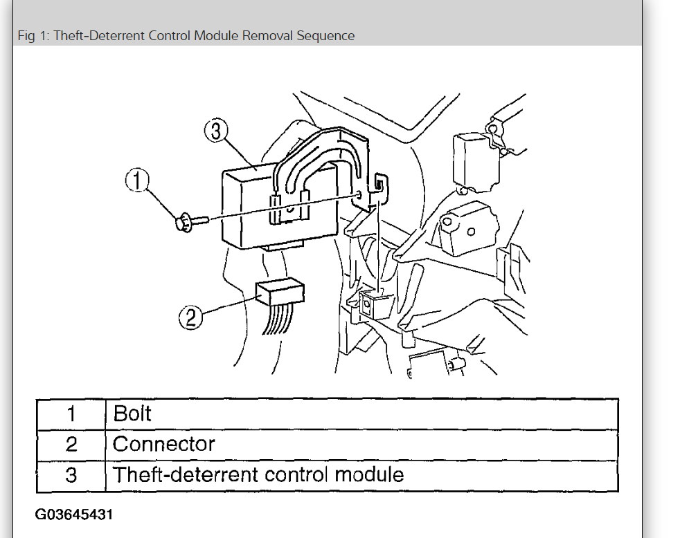

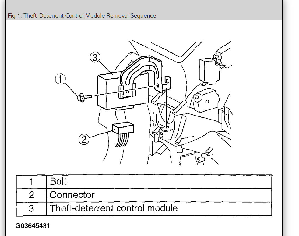

It sounds like the theft deterrent module is going out. but we should remove the electrical connector and check for corrosion before replacing it. Here is the location so you can check it out. If the module is bad a shop will need to program the new unit which should cost about $130.00. Check out the diagrams (below). Please let us know what you find. We are interested to see what it is.
