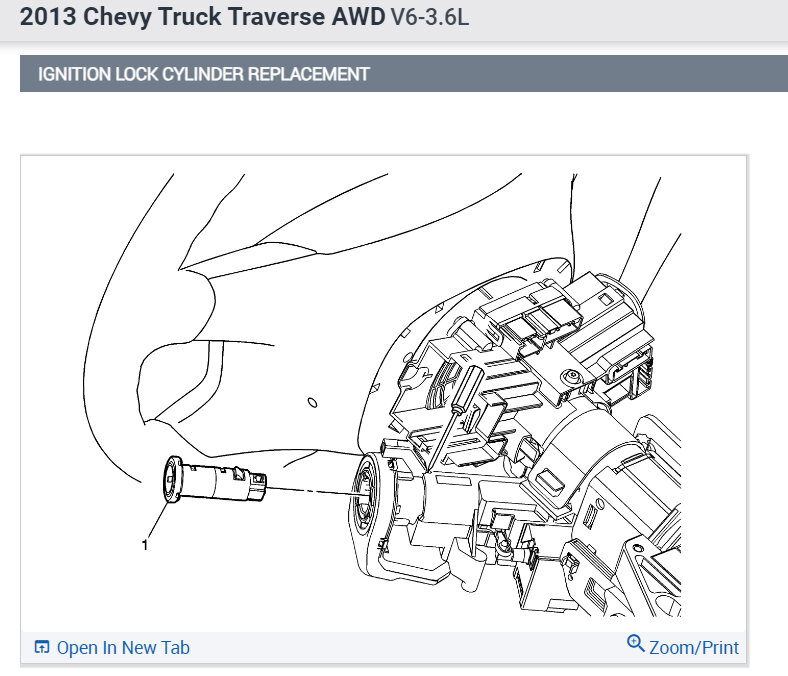

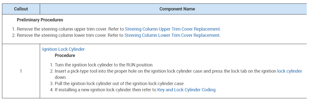

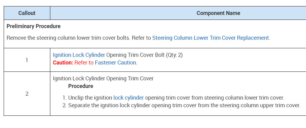

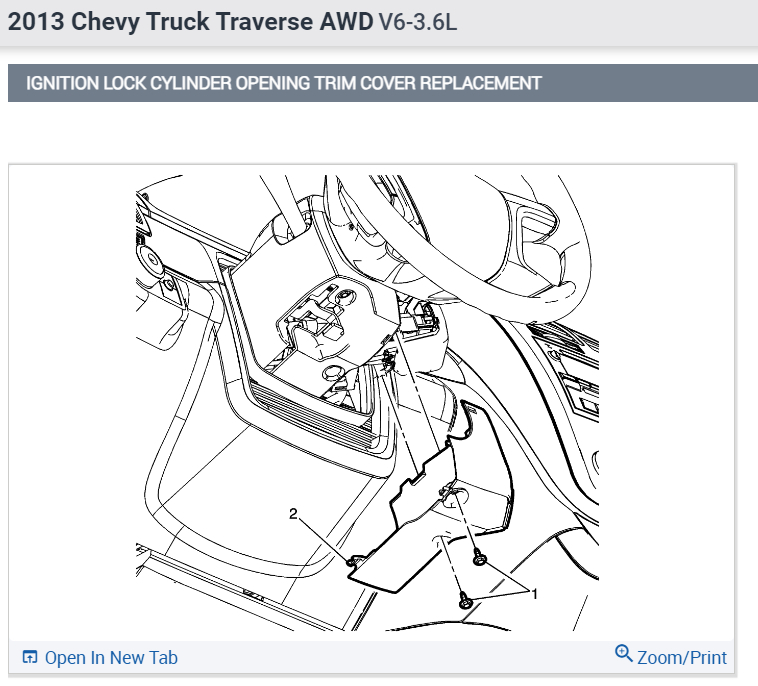

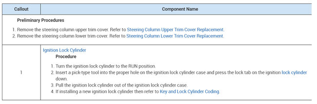

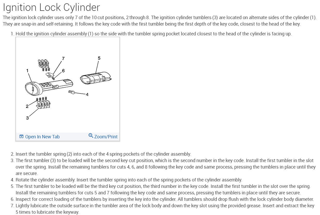

It sounds like the ignition lock tumbler has come apart internally. Here is how to change it out. Check out the images (below). Let us know what happens and please upload pictures or videos of the problem so we can see what's going on.
