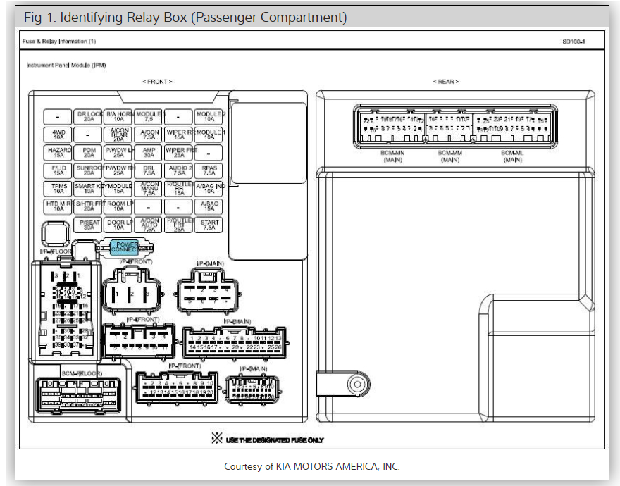

My anti theft siren is sounding as I'm driving my car. The fob locks and unlocks the car as well as set it into panic. The car has a push to start button.
Nov 2, 2019 at 4:26 PM

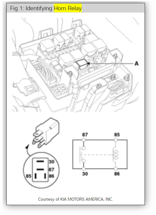

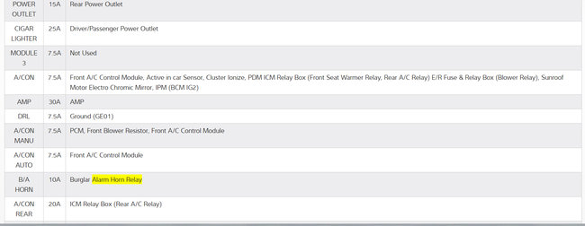

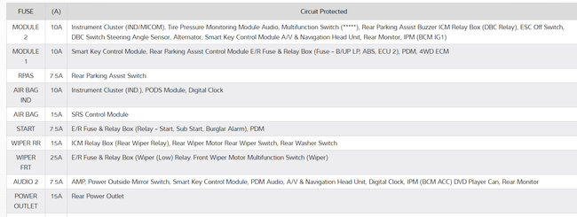

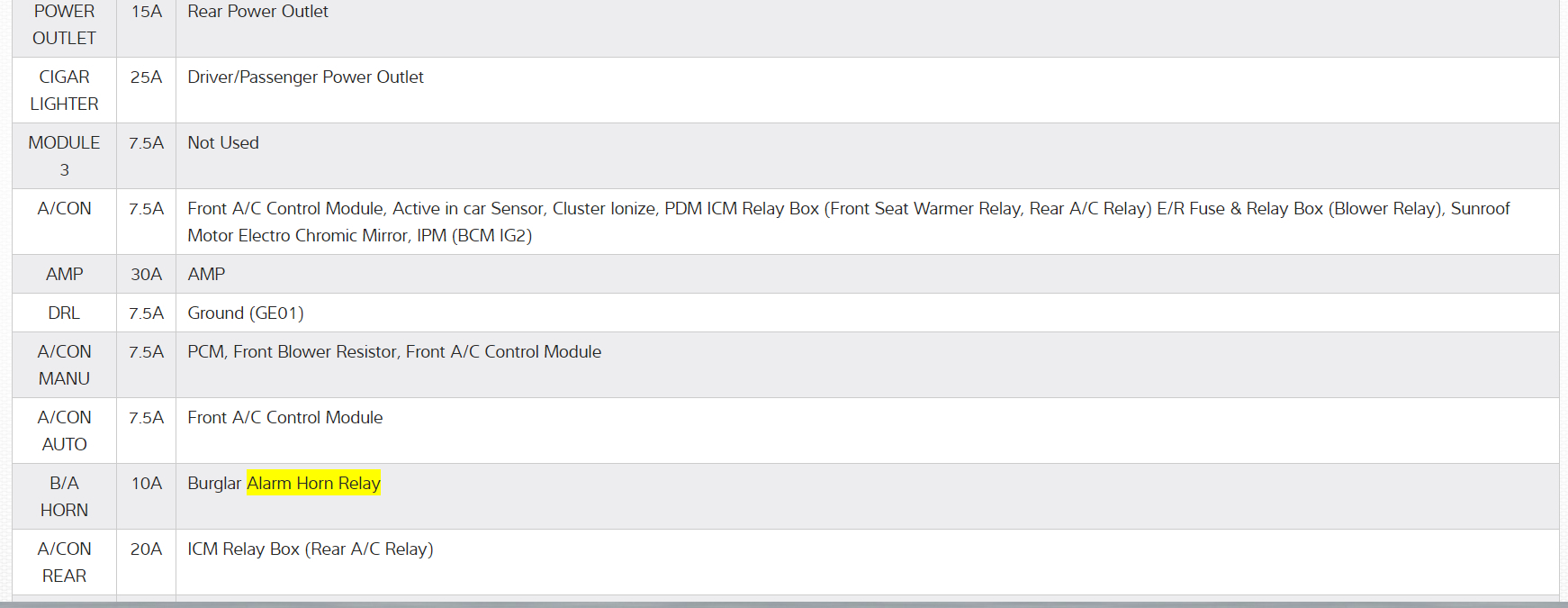

There is a security system horn relay that sound like it is stuck. To be sure here is a guide to help you test it with the relay location in the diagrams below (ba horn):
Nov 4, 2019 at 1:32 PM
FDELACRUZ21
Thanks, I had already tried this and it still kept ringing. Is there something else i should know? Unplug the battery? Wait a few minutes? Or is it another horn/alarm that is ringing and I'm missing it? I'm taking it to the dealer tomorrow morning unless i can figure it out before my appointment. Can't test it now since I'm home alone with the little kids.
Nov 4, 2019 at 4:07 PM

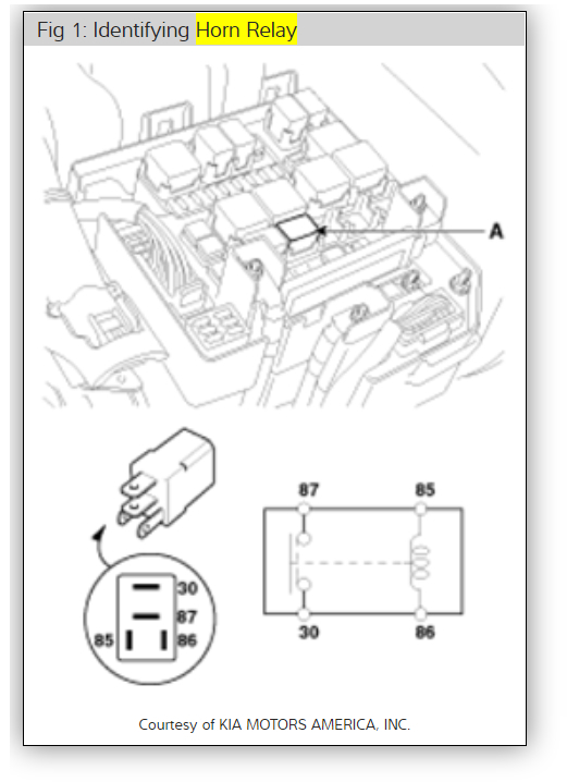

If you pulled the relay and it is still sounding it must be the main horn that is going off. Here is the location please remove it to see if the noise stops. Check out the diagrams (below). Please let us know what you find.
Nov 5, 2019 at 10:00 AM
FDELACRUZ21
I tried pulling that relay out the day it happened, but wouldn't budge and I gave up on that one. However, I did press the horn that day while the alarm rang and I heard an addition horn. I ended up taking it to the dealer and they stated that it was an after market alarm and the tech disabled it. They referred me to an after market shop if I wanted to get it fully functioning again, I guess they won't configure third party equipment even though they sold me the car with it installed. Anyway, the most important thing was that it was "fixed" and free of charge. Thank you for your prompt response and instructions. Will answer any questions if asked.
Nov 5, 2019 at 12:49 PM
I am sorry I had no idea it had an aftermarket alarm. Those are typically not very good, I would of had you do the same the tech did. Use 2CarPros anytime, we are here to help. Please tell a friend.
