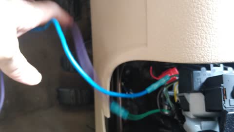

The transceiver module is the "ring" around the ignition key cylinder that will talk to the key then transmit a signal to the PCM as to the code that is embedded in the key, the PCM will determine if that code is programmed for this vehicle or not. Now with code B1681, either the transceiver is not doing it's job, the circuit is open or grounded, or the pcm is not doing it's job. If this pastime tracker is wired in to the transceiver, the wires could be cut if they wired it in series. Also put back any fuses that were removed. I remove a lot of aftermarket theft devices because #1 they don't work anymore #2 they are wired incorrectly. either way, I always take the vehicle back to stock form before I proceed, with that said I cannot see what the tech has done to "remove" the system. He may have cut it out but did he restore the wiring? Can you upload a picture of what he has done? I could give you the entire pinpoint test procedure, but that would not be doing you any good if the wiring is chopped up! I'd like to get you fixed quickly and efficiently!

I just reset the computer by unplugging negative battery and put a wire from negative to positive and it cranked up, but when I shut it off again it want crank. so please tell me what to do anyone. thanks

Hello and welcome to 2CarPros. Just to jump in, that bypass wire does not look like it needs to be there? You need to have the car lot you bought it from restore the circuit back to factory, and that does not look factory.
Any type of aftermarket equipment installed that affects the key will result in problems. The car lot you bought your vehicle from needs to correct this. You may need to call the Bureau of Automotive Repair to get involve to get this repaired properly but every State has there own laws that govern stuff like this. If your in California you have a pretty good chance to have the car lot pay for the wiring repair/new harness if needed. But I would recommend you call them first to see what your options are.
