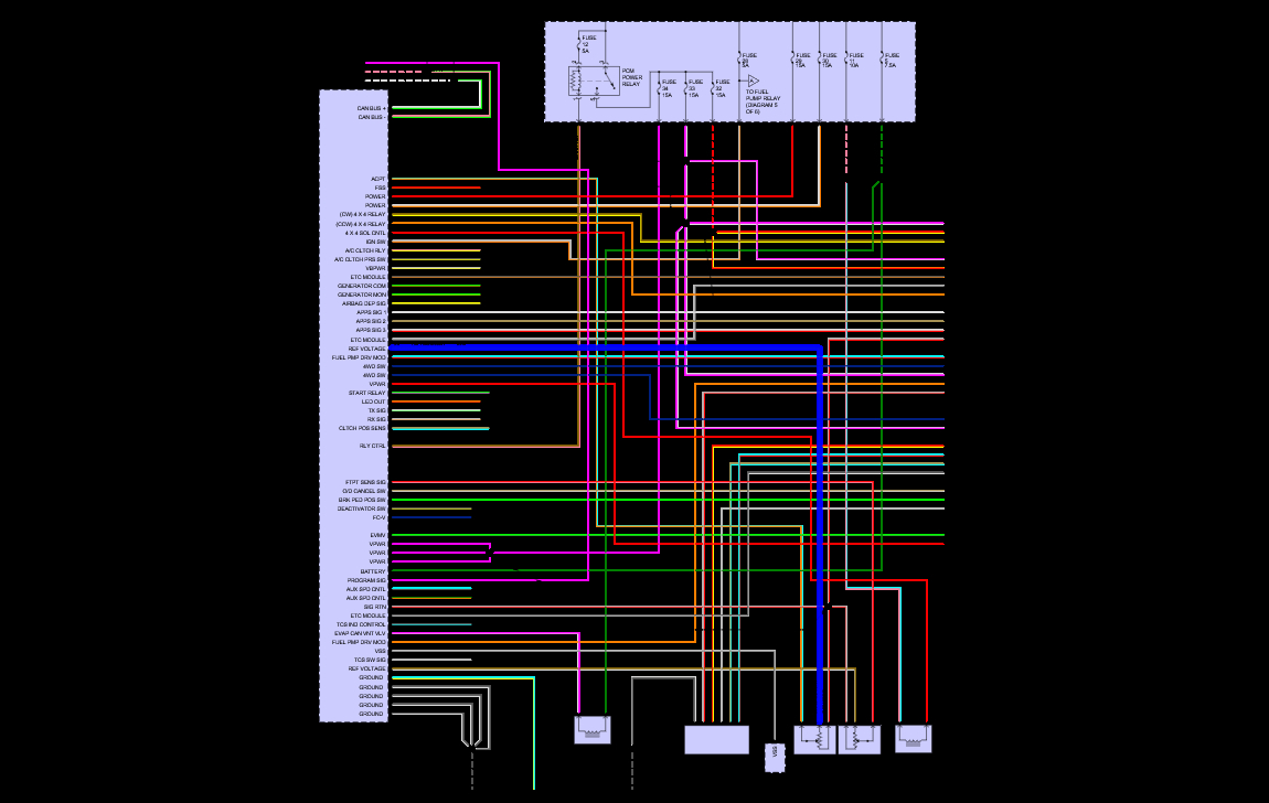

Somehow I did not see the reply. Thank you for the reply! Since I wrote this, I have confirmed that there is no ground going to the PCM relay which in turn powers fuses 32, 33 and 34. When I put a good ground to the ground wire from the PCM to that relay I had power at the fuses above. So with the help of a local friend, we have determined the PCM needs to be replaced. Please see picture. However, I would welcome any comments...
Apr 16, 2025 at 7:47 PM
Can I ask where you got this wiring diagram from? Yes, if the PCM is not grounding the relay then power will not be transferred. I would replace the PCM which should fix it.

Here is the link to the site I found the wiring diagram. https://www.ford-trucks.com/forums/1539213-2004-2008-f150-wiring-schematic.html
I ordered a pcm and will report back on how that goes. Thanks for you help. David
