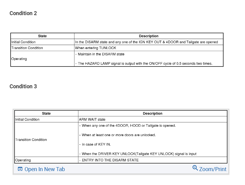

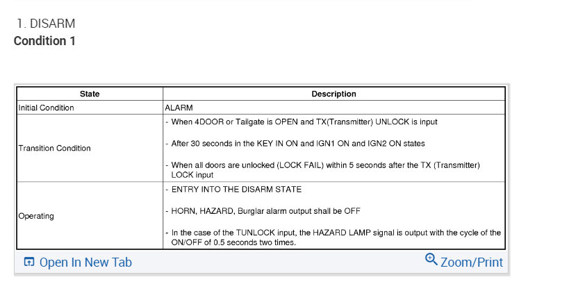

Check out the images to reset the system (below). Please let us know what happens.
