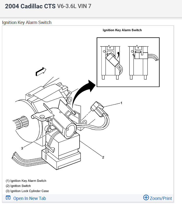

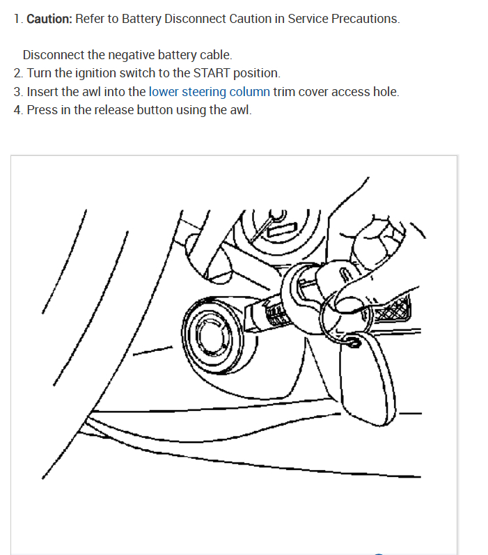

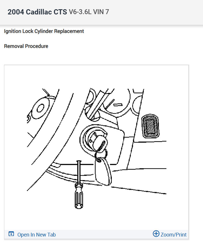

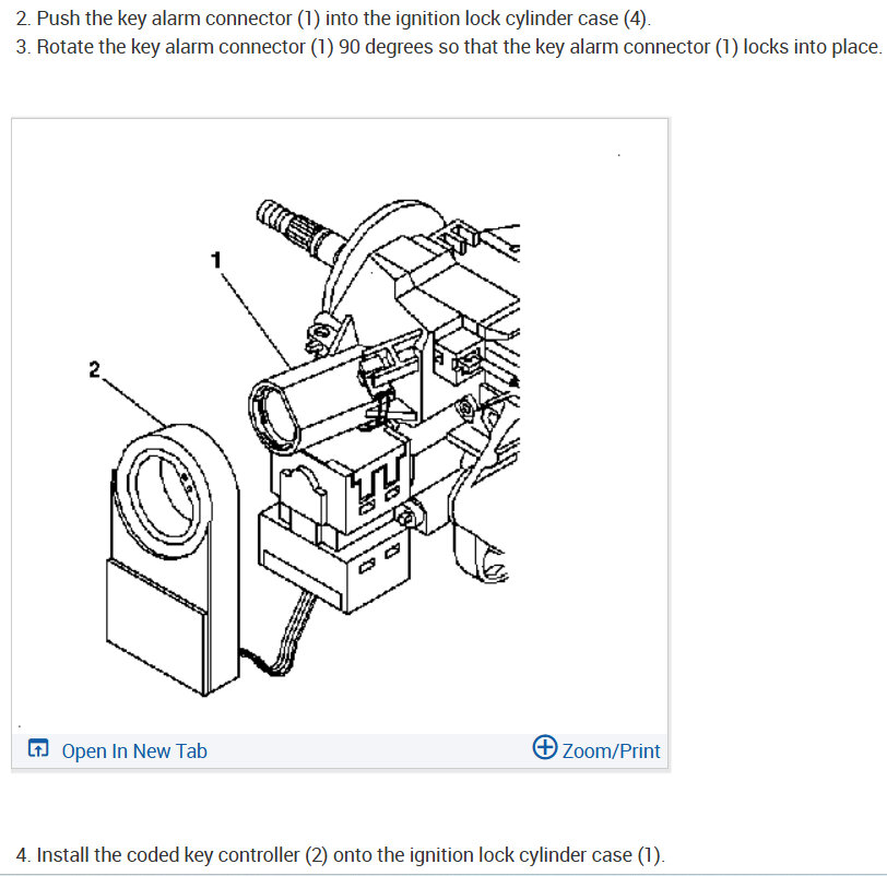

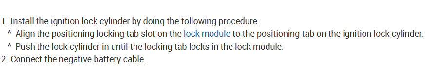

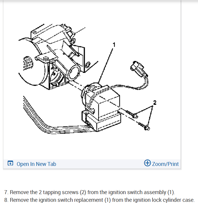

I am sorry to hear about your troubles, you can't bypass the security system. You will need to replace the lock and key and then do a relearning procedure. Here is how the job is done, if the column is too badly damaged, I would get a used one by searching eBay, if you upload images, I can help you decide.

Check out the images (below). Please upload pictures or videos in your response of any problems so we can see what to help you with.
