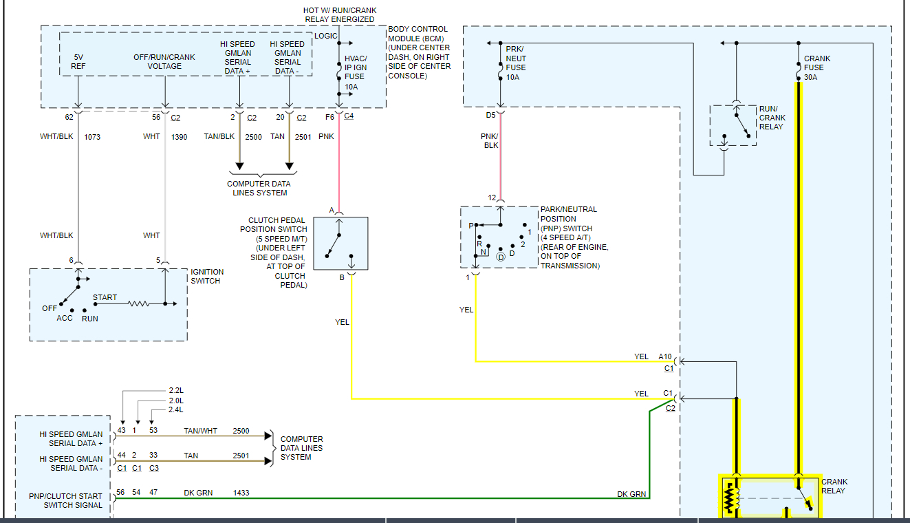

The antitheft come up when i first turn key but is hone after 5 seconds. tried all suggestions still will not start.
Dec 8, 2020 at 1:46 PM

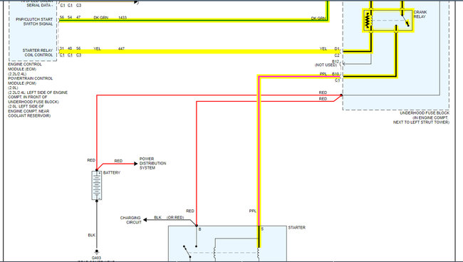

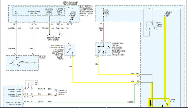

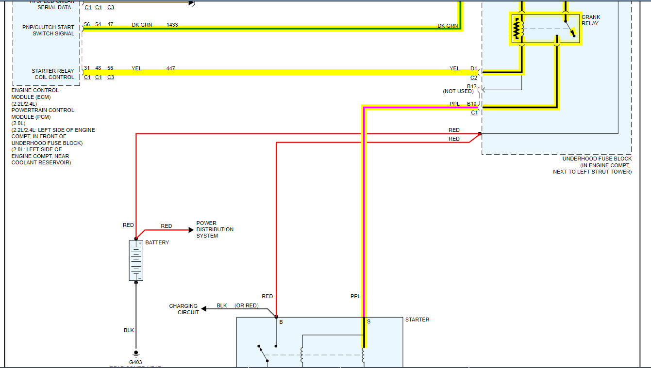

Good evening,
If the light goes out, it is not the security system at all.
I attached a diagram of the starting system for you to view. We need to do some testing at the relay.

I never saw the light until i hot boost from a truck then light was there. reset it once then when i was tighten battery cable socket touch other terminal and now light is back.
Dec 9, 2020 at 4:06 AM

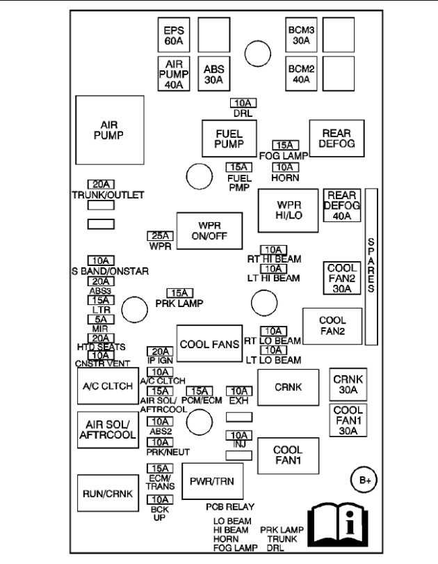

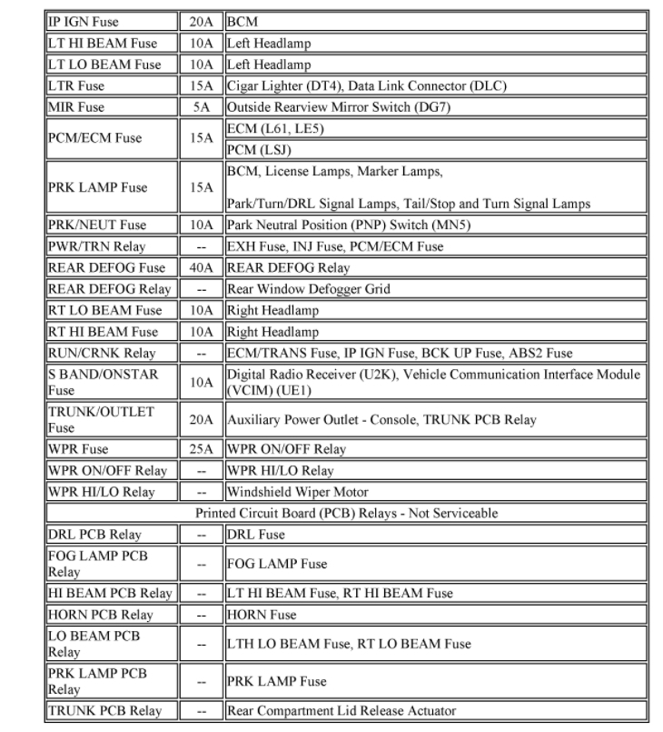

Check all your fuses with a test light to see if any have failed.
Hopefully the only damage you did was blow a fuse.

What main fuses should i be checking?
Dec 9, 2020 at 8:50 AM

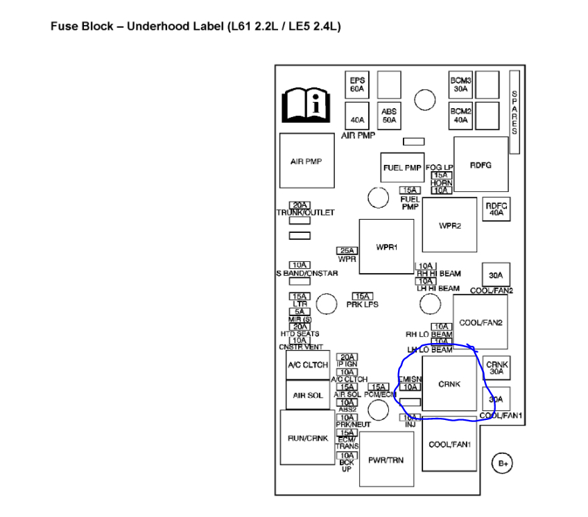

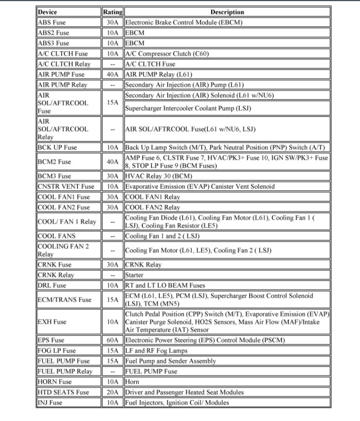

I would check every fuse in the fuse block.
I attached the diagram of the fuse block for you to view.
