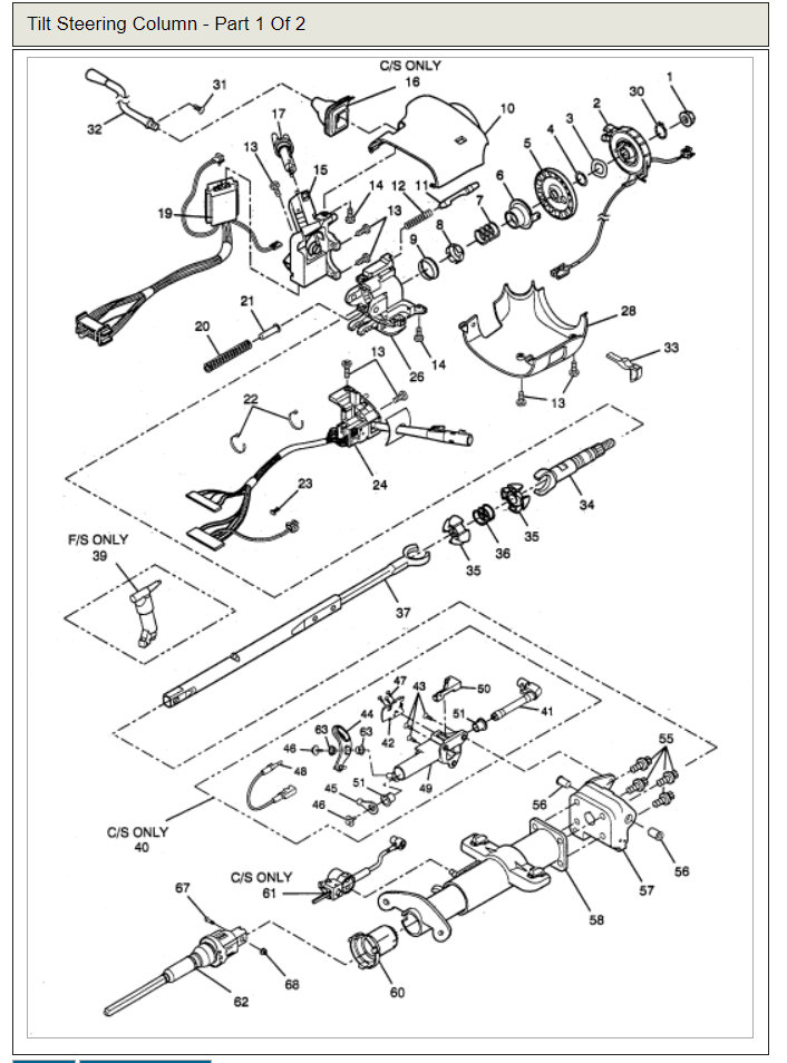

otherwise it may need a different key if you have one. Not a new one. Check out the diagrams (Below). Please let us know what happens.

Even if you get the fuel pump to run it still will not start becasue of the security system. If you have not changed the key or lock and tumbler then there are two small wires at the ignition tumbler that break inside the steering column. Here is a guide and some diagram (below) to help you get the problem fixed.
https://www.2carpros.com/articles/how-to-reset-a-security-system
(Check out the diagrams below) The wires that break are attached to item #19
Please let us know what you find.
