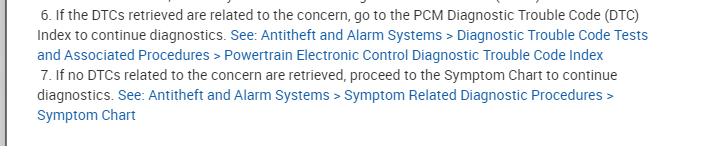

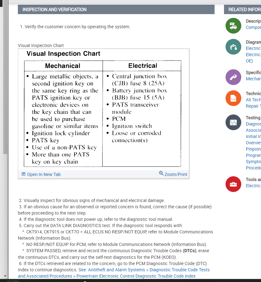

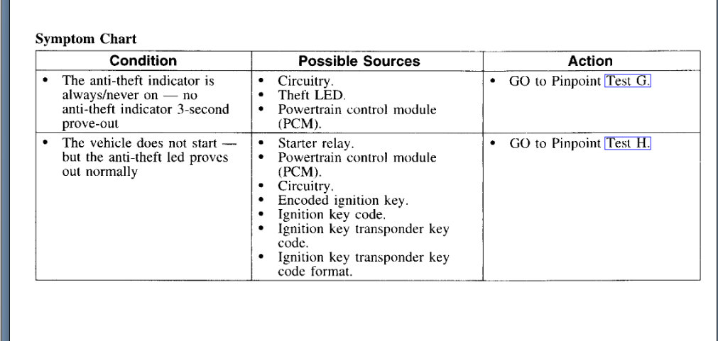

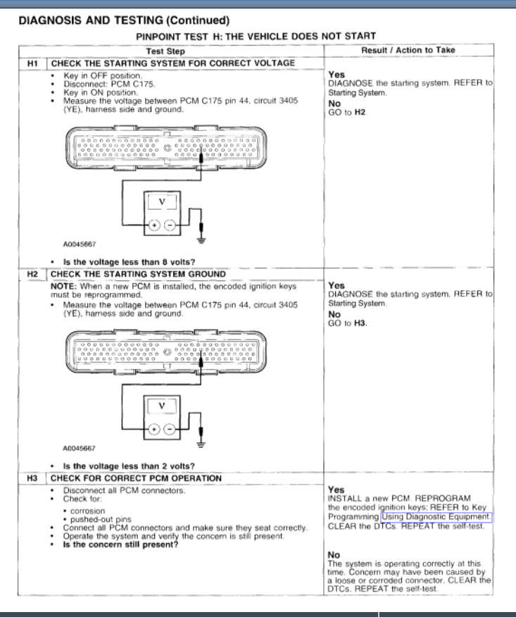

If there are no codes, then I am attaching some info that will help with this.
Let's run through this info and let me know what questions you have. Thanks
