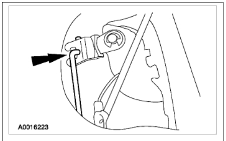

First two things I would check are:
The door latches on these need to be well lubed with a thin penetrant like wd-40. The switch does not think the door is shut. Often a symptom of this is the dome light or door ajar light staying on abnormally. After spraying, open and shut the doors ten times or so.
Second is to check for a collapsed grommet in the hood on the left side corresponding with the hood pin switch along the left edge of the fender. They tend to rot through, allowing the pin switch to extend. This makes the anti-theft system think
someone has opened the hood. If you find this to be the case, be sure to replace the grommet with the correct part, which is made of very stiff rubber.
If this is the case you may have to fabricate something out of metal? To keep the height correct as the original part may no longer be available.

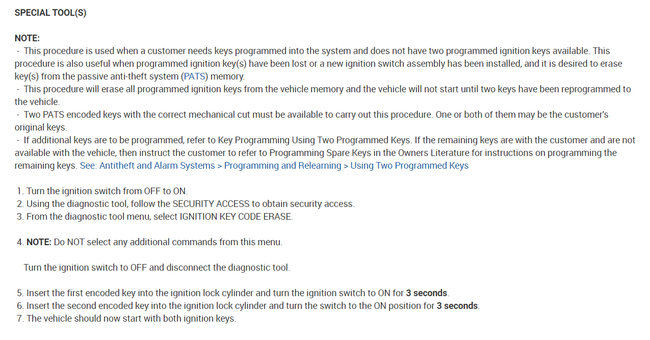

I took the PATS receiver, ignition lock, and ignition switch off of my car. I put them back on and now have a flashing theft light in the instrument panel. The car cranks but dies immediately. How can I reset the anti-theft system?
Dec 16, 2020 at 8:03 AM (Merged)
BMRFIXIT
  • 19,053 POSTS
1st step should be to check for codes
Check fuses
Reset and programming keys require dealer equipment or check with local lock smith as some may have that scanner tool too

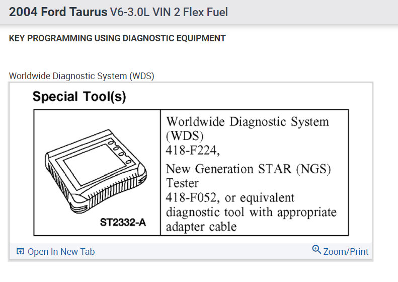

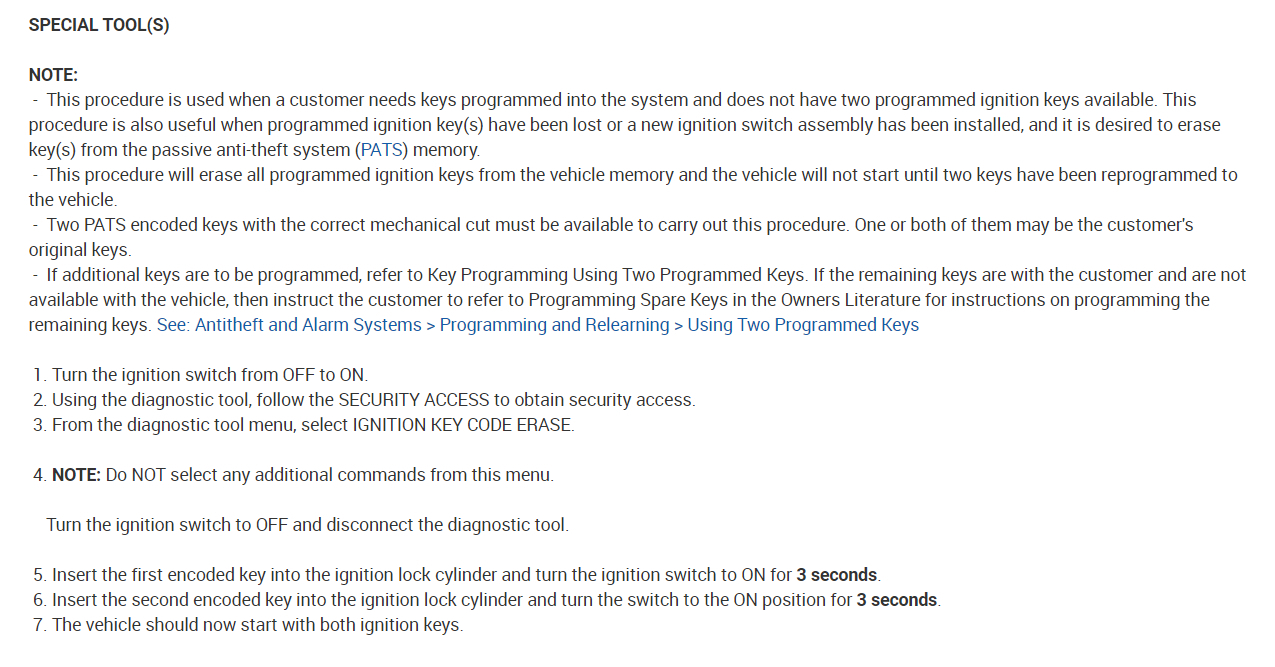

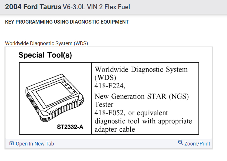

KEY PROGRAMMING USING DIAGNOSTIC TOOLS
PROCEDURE #1
1 key required. Cycle key to RUN. Enter "Ignition Key Code Erase." Disconnect Tool and leave key in RUN for 20 seconds. Cycle key to OFF and then RUN.
PROCEDURE #2
2 keys required. Cycle key 1 to RUN. Enter Security Access on the PATS control function module. Select "Ignition Key Code Erase." Disconnect Tool and leave key in RUN for 20 seconds. Cycle key 1 to OFF, then RUN, and back to OFF. Cycle key 2 to RUN.
PROCEDURE #3
2 keys required. Cycle key 1 to RUN. Select "Ignition Key Code Erase." Disconnect Tool and leave key in RUN for 20 seconds. Cycle key 1 to OFF, then RUN, and back to OFF. Cycle key 2 to RUN.
SPARE KEY PROGRAMMING USING DIAGNOSTIC TOOLS
PROCEDURE #4
Cycle an unprogrammed key in ignition to RUN. Enter Security Access on the PATS control function module. Select "Ignition Key Code Program." Disconnect Tool and leave key in RUN for 20 seconds.
SPARE KEY PROGRAMMING USING PROGRAMMED KEYS
PROCEDURE #5
1 key required. Cycle key 1 to RUN, then OFF. Cycle new key to RUN.
PROCEDURE #6
2 keys required. Cycle key 1 to RUN, then OFF. Cycle key 2 to RUN, then OFF. Cycle new key to RUN.
REPLACING PATS CONTROL MODULE OR PCM
PROCEDURE #7
Cycle a key in ignition to RUN. Enter Security Access on the PATS control function module. Select "Parameter Reset" and then Exit Security Access. Perform a PCM Keep Alive Memory (KAM).
PROCEDURE #8
Cycle a key in the ignition to RUN. Enter Security Access on the PATS control function module. Select "ICM/PCM Parameter Reset." Select "PCM/TCM Parameter Reset" and then Exit Security Access (type F) .

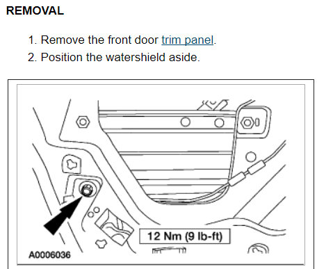

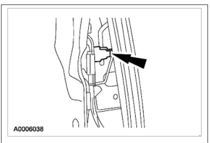

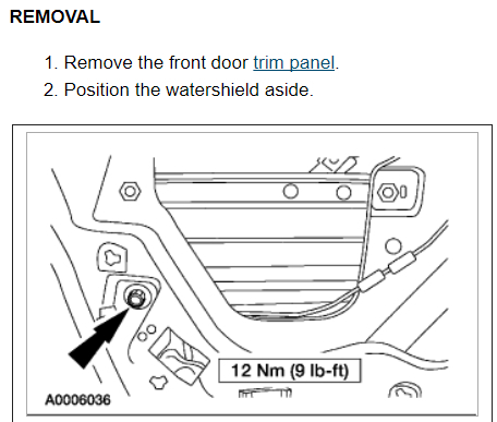

My 2004 Ford Taurus, has a factory car alarm. I have noticed that when the outside air tempature goes below 40 degrees, the alarm will go off. I have to go outside turn the alarm off. It maybe another 30 or 45 minutes then it goes off again. What could be causing the problem. Is their away to turn the alarm system off completely? I know my neighbors are getting upset that my alarm keeps going off.:(
Dec 16, 2020 at 8:04 AM (Merged)

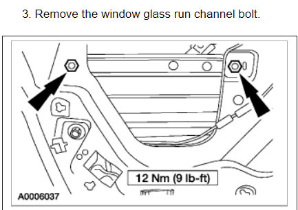

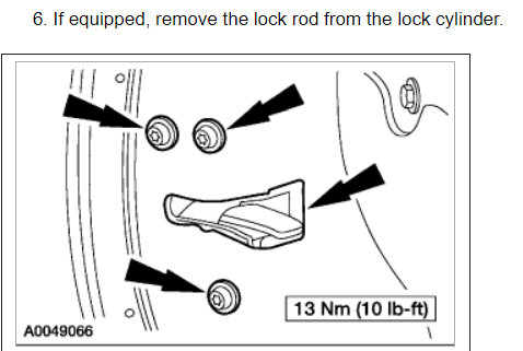

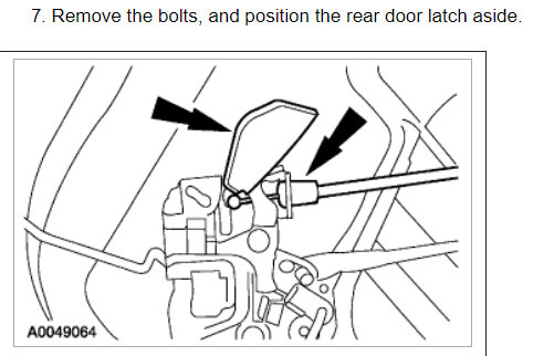

9 times out of 10 it is the drivers door door latch which needs to be replaced because the switch inside malfunctions causing the alarm to go off. You will need to remove the door panel to get to the latch to change it. Here is a guide that will give you an idea of what yo are in for when doing the job.
https://www.2carpros.com/articles/door-panel-removal
Here is a diagrams to help you see what you are in for when changing the latch.
