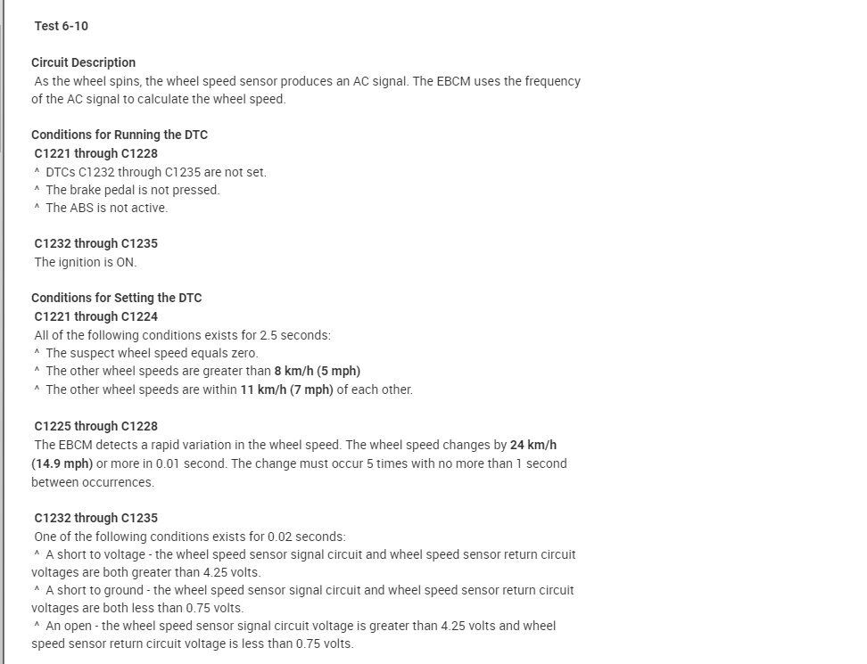

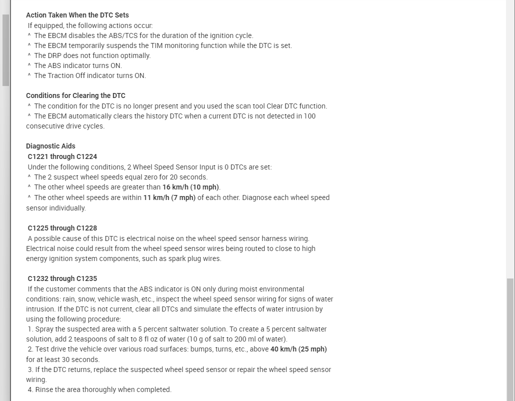

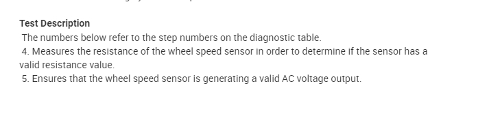

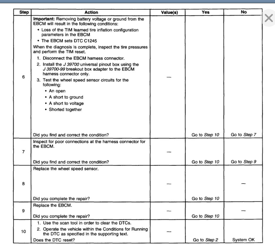

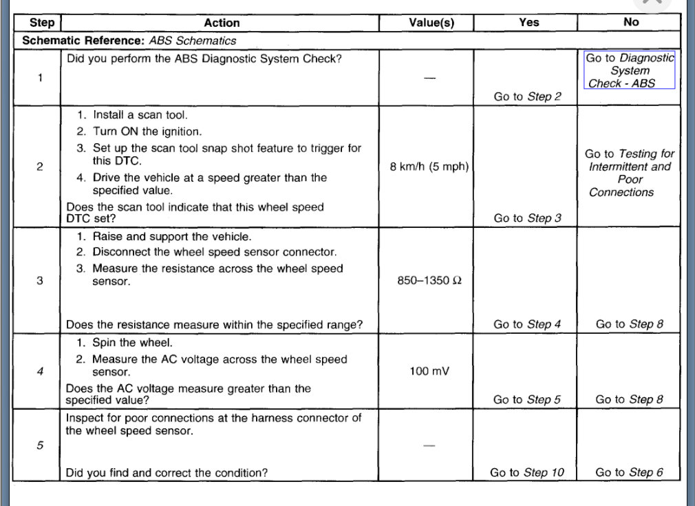

I am attaching the testing for the first code as this is the primary code that we need to track down and make sure we don't have other issues or confirm a wiring issue.
Please run through this and let me know what you find, and we can go from there. Thanks
