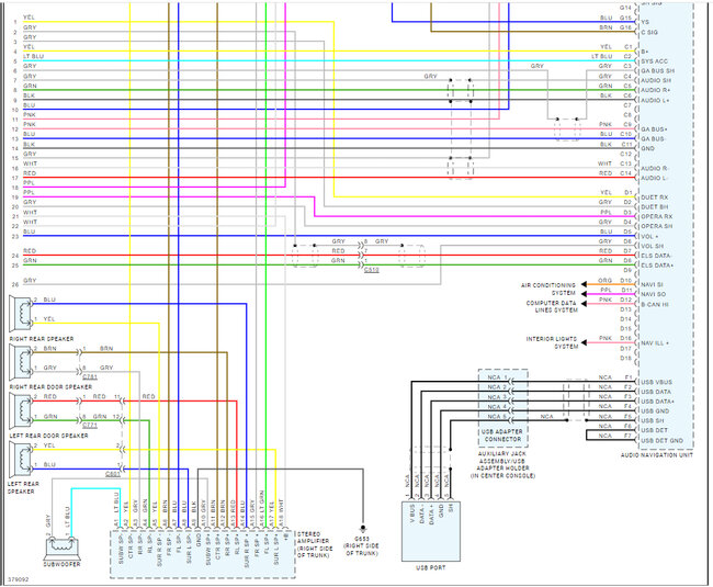

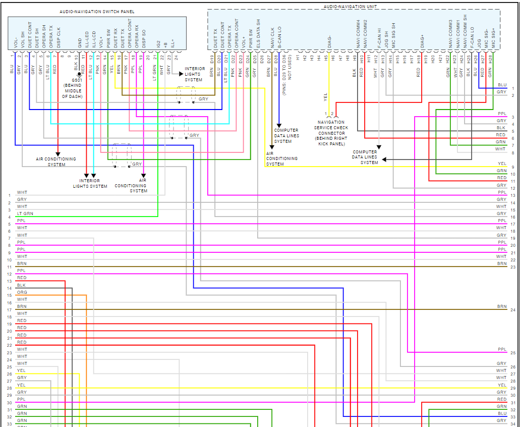

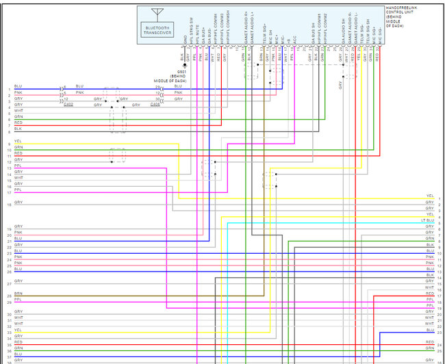

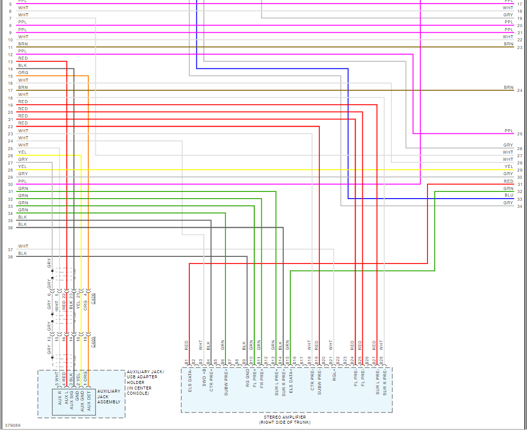

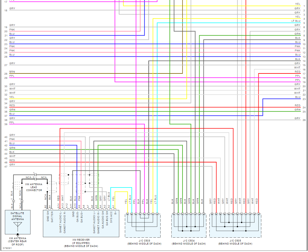

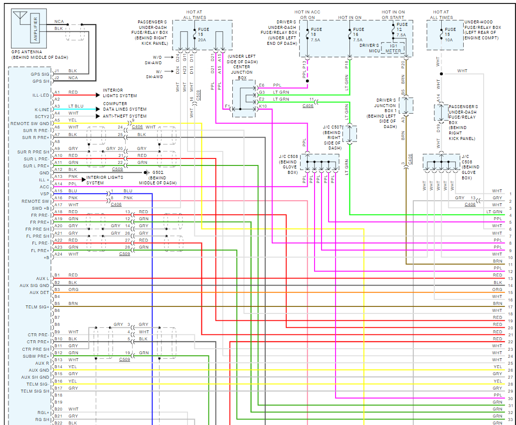

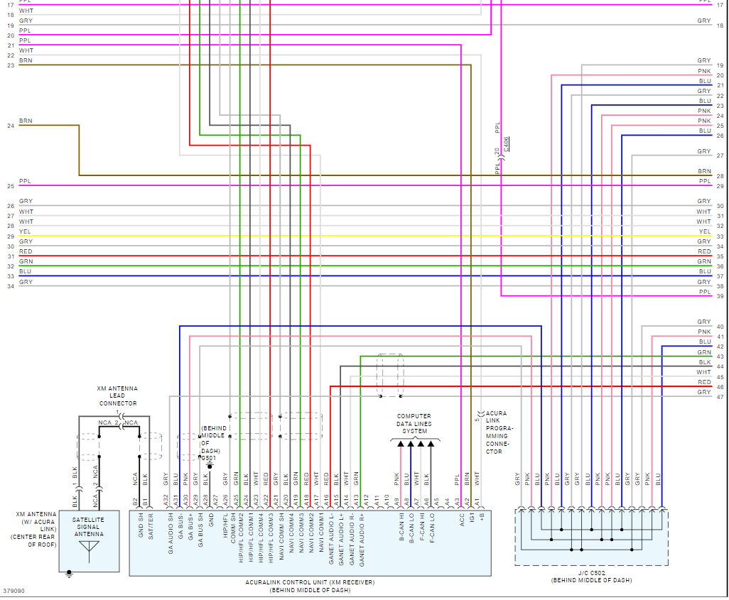

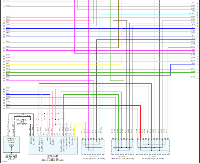

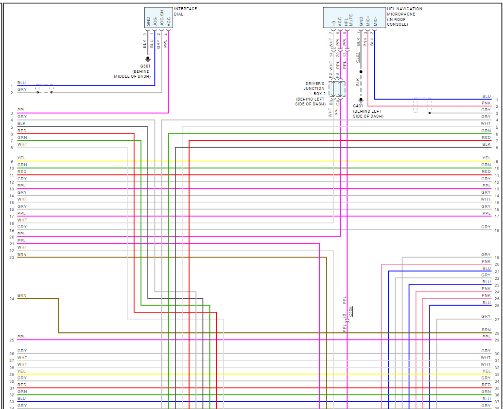

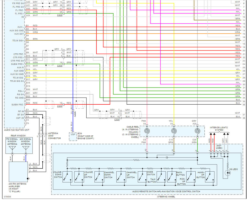

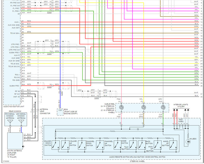

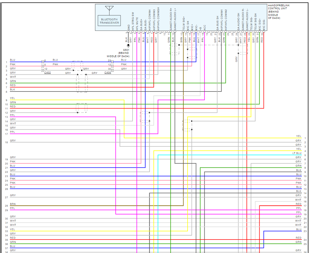

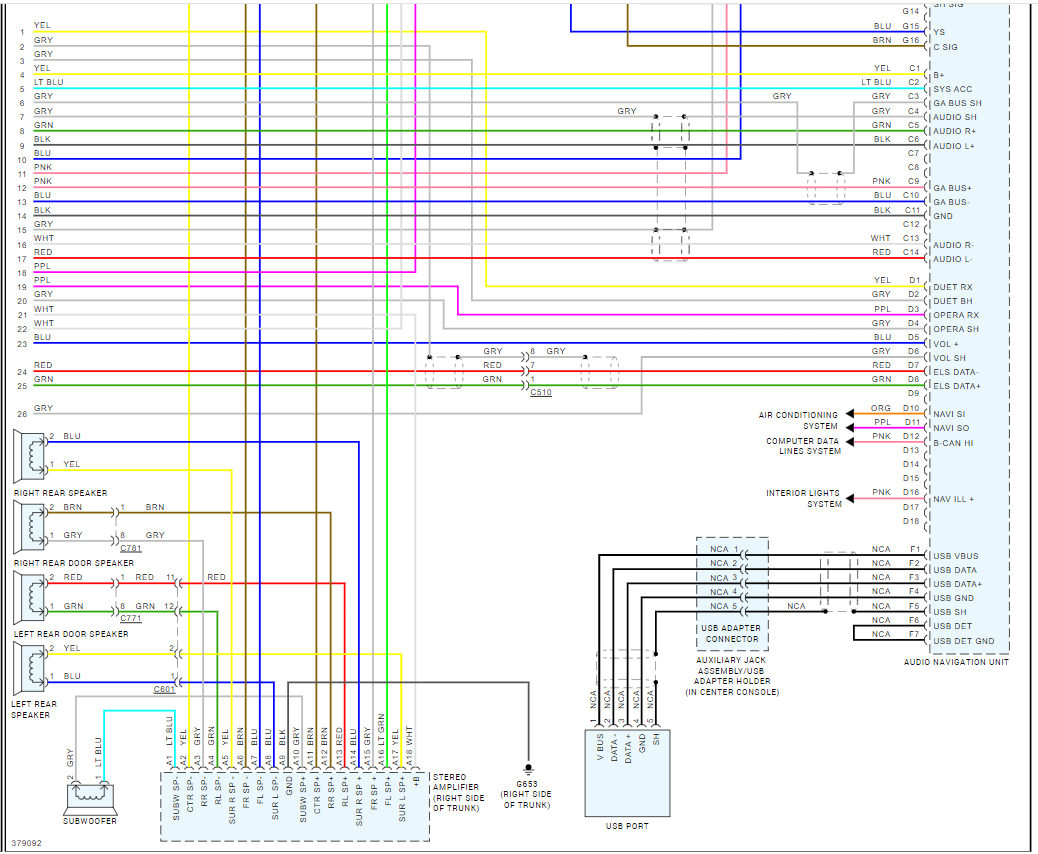

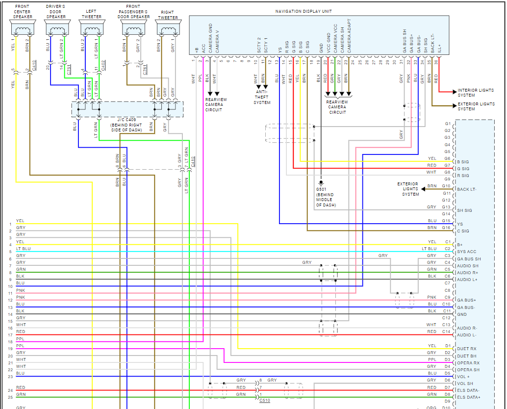

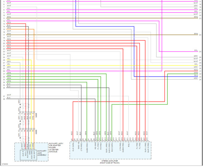

There is no ANC module i can find, there is a microphone, but it is for the navigation. The ANC feature is built into the radio system. Were you able to go through the screen prompts and find the option to turn off? Here are the radio system wiring diagrams so you can look them over to see what I am talking about. Check out the images (below). Let us know how it goes.
