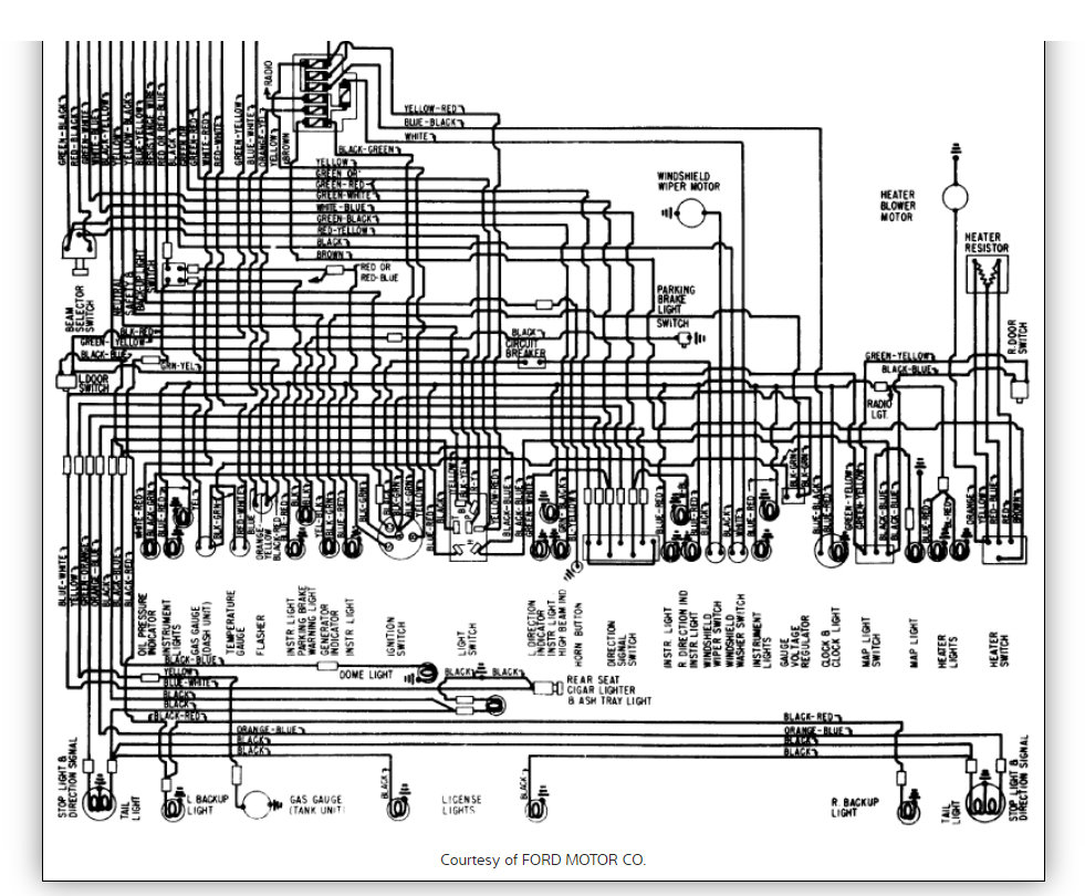

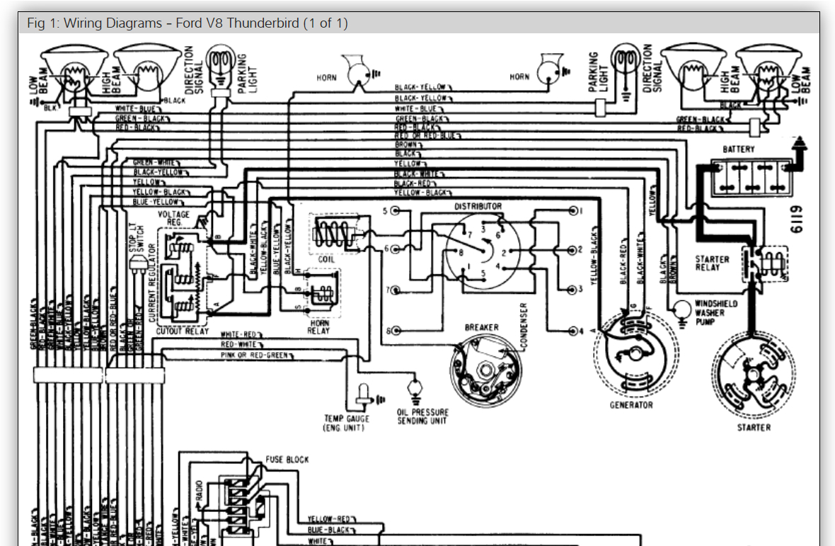

Here is a guide to help check the wiring with the alternator wiring diagrams as well:
Check out the diagrams (below). Please run this test and get back to us.
