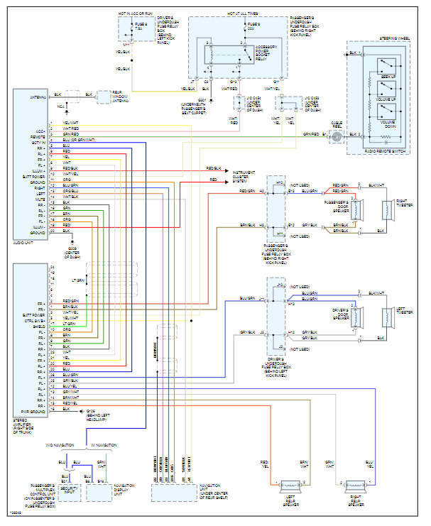

The amp is draining the power from the battery
2001 ACURA CL
163,000 MILES • 2.4L • 6 CYL • TURBO • 2WD • AUTOMATIC
ALICE BROWN-WARD
How can I fix this problem?
Oct 15, 2020 at 11:54 AM

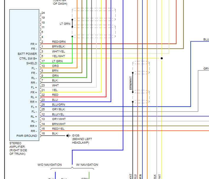

I assume you say the amp you mean the stereo amplifier? You may have to replace the amp but let's confirm this by doing the following.
If this is the case then we need to find out for sure that it is causing the draw by checking the ignition off draw and then unplug the amp to ensure the draw goes away.
If this happens then you may have a shorted component coming off the amp that is keeping the amp on. We check this by preferably de-pinning the connector one wire at a time until the draw goes away. Then you know what specific circuit it is. If this is a circuit going to a speaker then you need to unplug that speaker to see if the draw goes away.
Let me know what questions you have and we can go from there.
