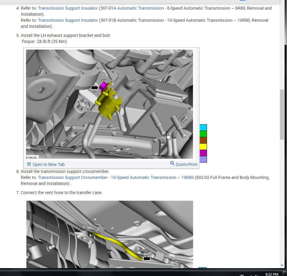

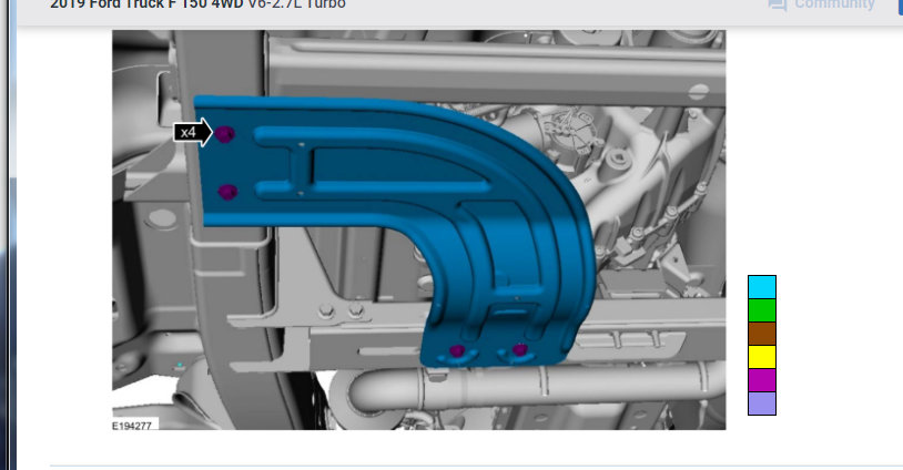

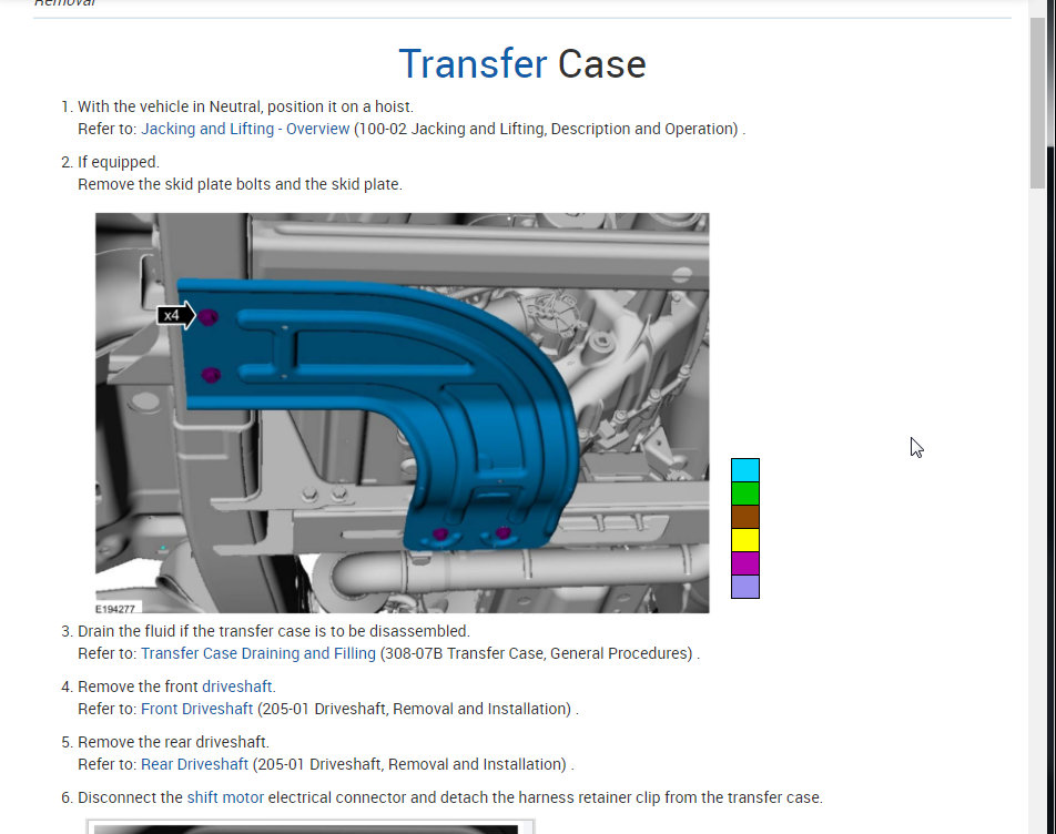

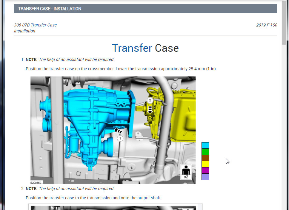

You do not need to support the transmission as you will leave the crossmember in place that will keep the transmission in place.

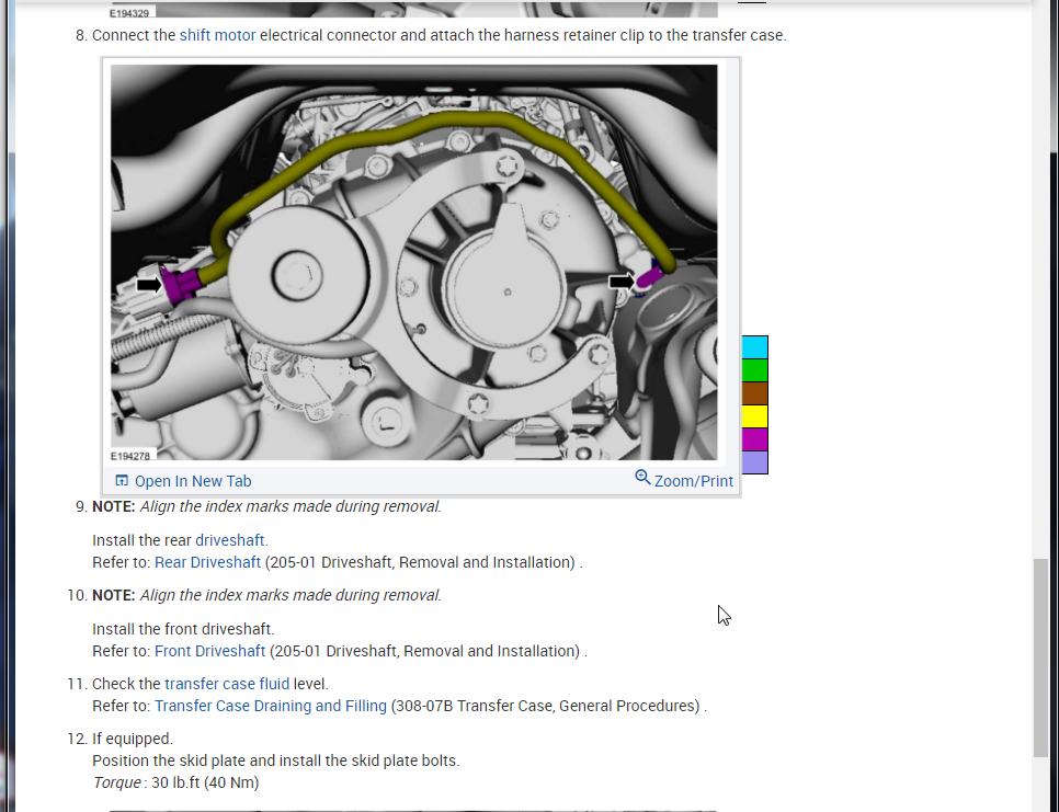

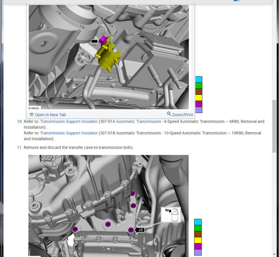

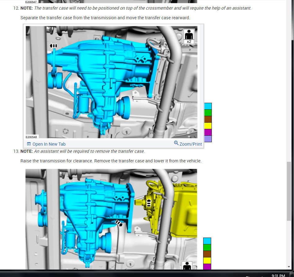

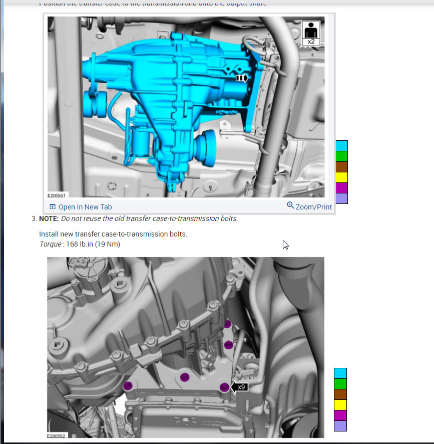

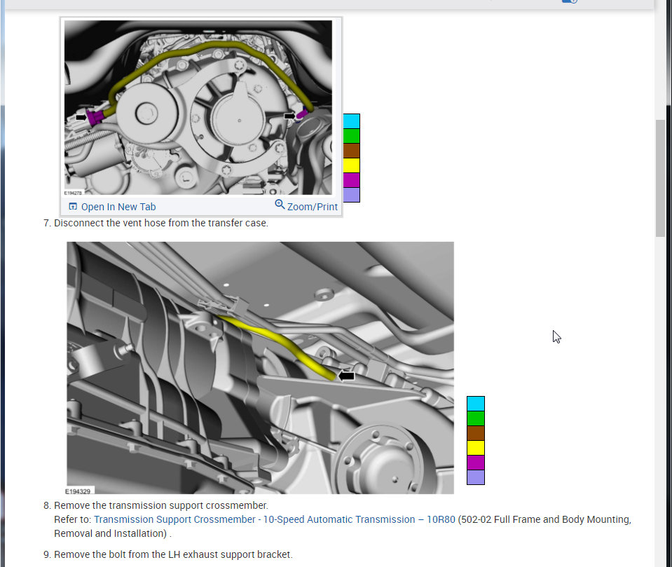

I attached the entire process below. Please review this material and let me know if you have questions. Thanks
