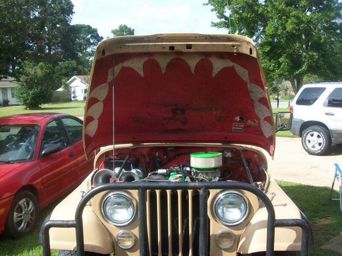

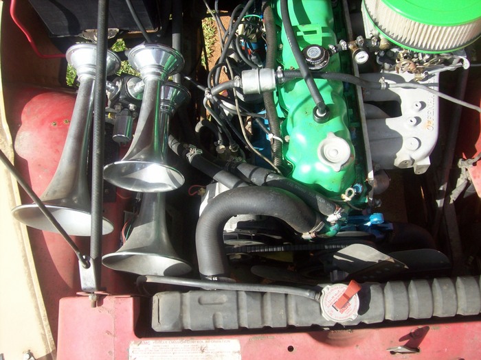

Here's a peek at "Mr. Jeeps" Heart...w/ 4 barrel 390 HOLLEY and a OFFY intake.
