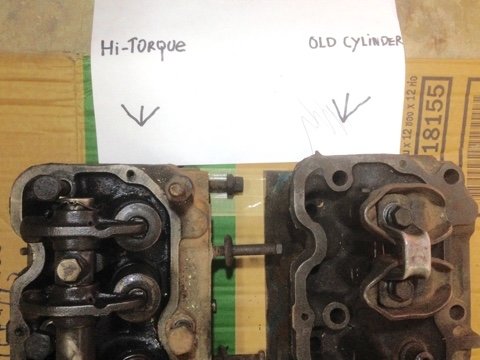

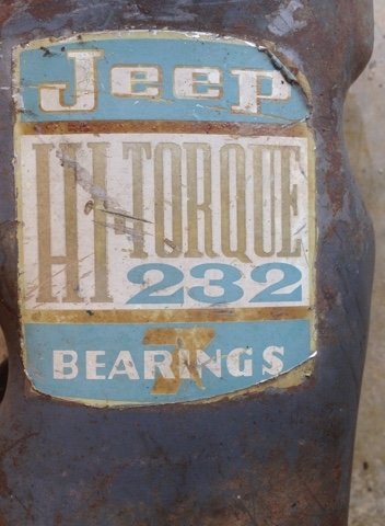

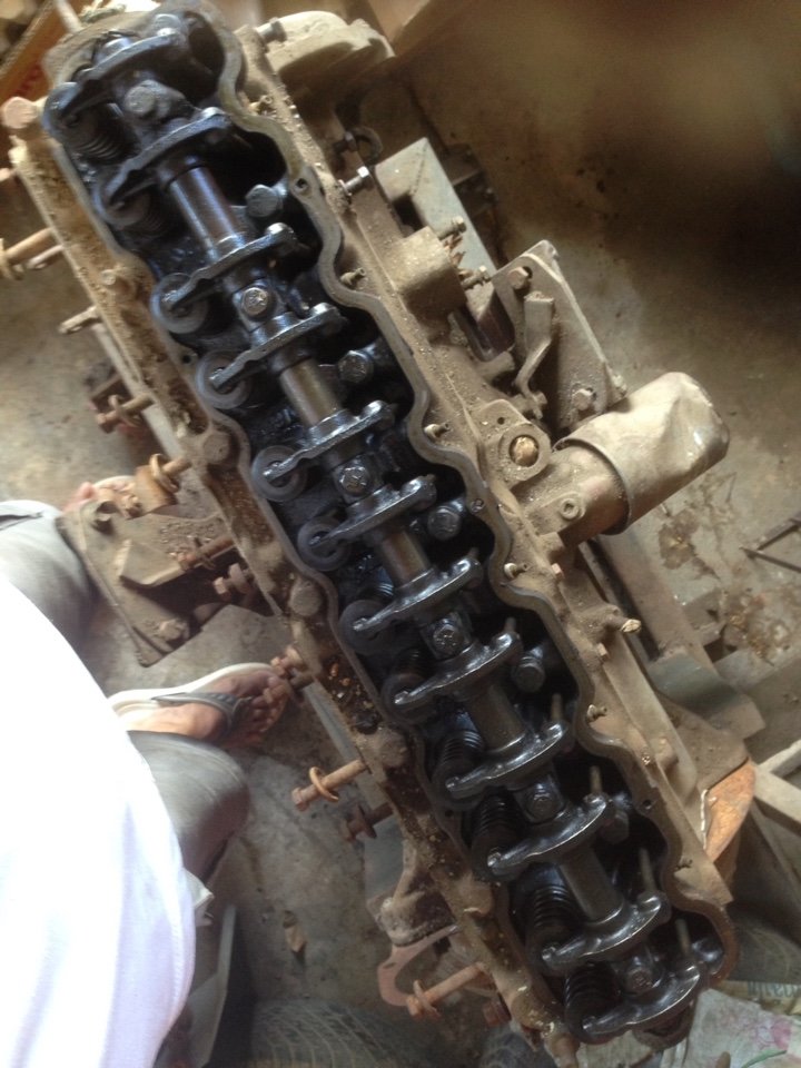

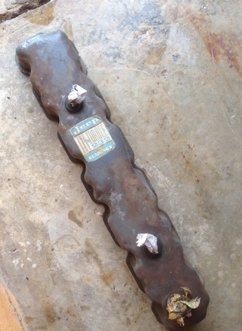

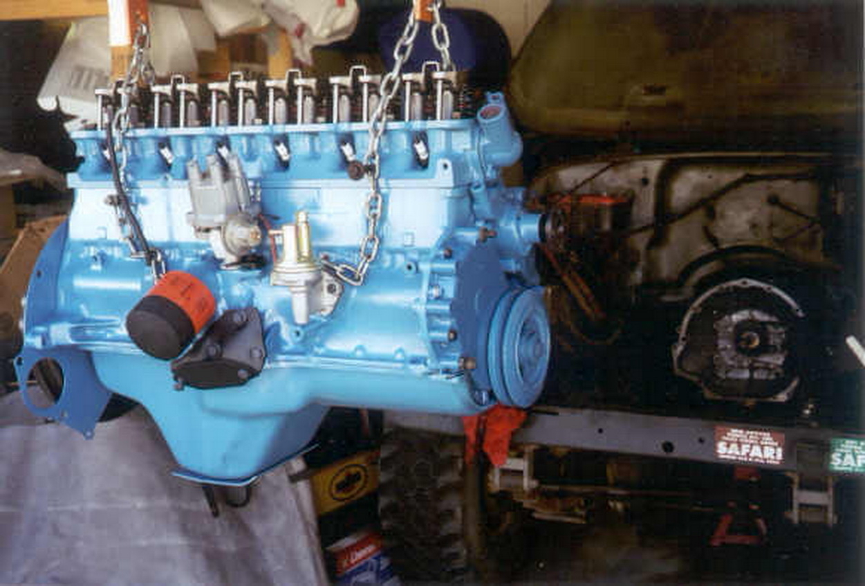

What is AMC 232 OR 258 ? I got AMC Hi-torque from junk that installed in Jeep Wagoneer. I think this engine was AMC 232 because it has sticker on valve cover ,shown in pic #1and#2 .

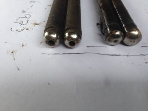

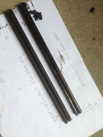

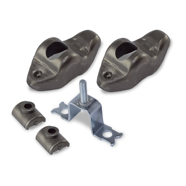

Rocker (pic #3and#4 .)and push rod (pic #5and #6 .)could not switching ,it is different type.
Note: AMC 232(CJ6)'s push rod are bigger , longer with hole all the way down.
If it was the same series (AMC 232) I can switch hi-torque cylinder set to my old one. What about push rod which one should be use?

which head to use is up to you use the pushrods that fit is the only thing I can advise. if the one set of pushrods are to long then you will need to use NEW lifters that fit that cylinder head to try to make the difference up. you cannot use a rocker arm set up on a single rocker set up. you could try the shorter pushrods, but then there is an oil hole for rocker arms through the head that may not be on other try to have a local mechanic look at this to sort it out or if an engine rebuilder near check with them as they may know already

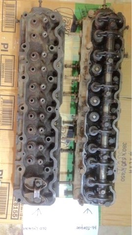

I had decided to use Hi-Torque Head to install on my old AMC 232. After all parts has been checked I found a new problem about rocker arm lubricating oil path ,old engine- no lube path from cylinder jacket flow through the cylinder head to lubricate rocker arms shaft.Finally ,I could not switch cylinder head only valve set will do. Do you have any idea ?

check into a head rebuild you don't need valves if they are not bad, only exhaust seats which I said in second reply I think I figured that the rocker arm set up would not work as I said in last reply. check with a machine shop or auto parts for head work.
