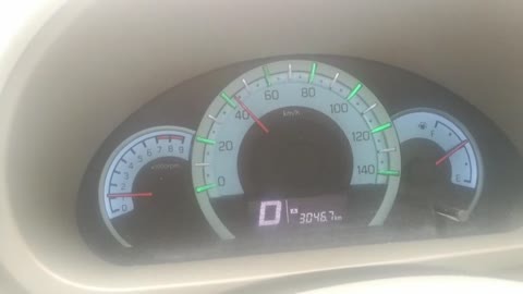

Marked A is continuous blinking

The Marked A is blinking orange continuously. Furthermore when I used to press brake it used to display battery health as to how much it is charged. That is also not showing up. Is it a battery problem? Appreciate urgent feedback. Enclosed is the video I just made.

Now the video.

That is a warning that the autostart/autostop function of is off or disabled due to a problem. That could be a low battery or other system failure. Without connecting the car to a scan tool to see what the system is showing as the error it would be guesswork. Anything from a loose connection to a failed battery or starting motor could be the cause.
