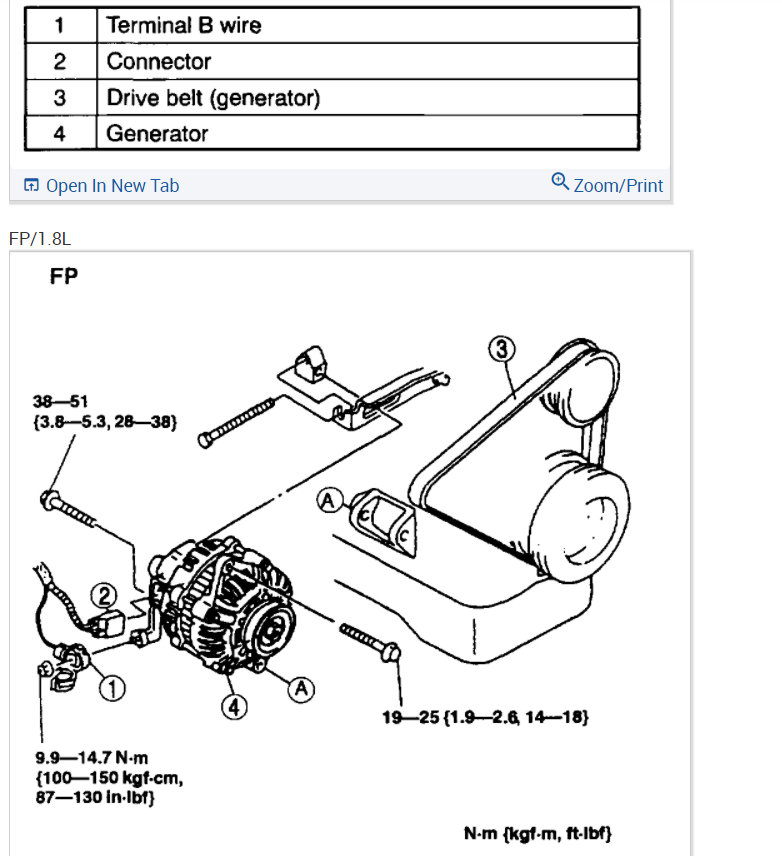

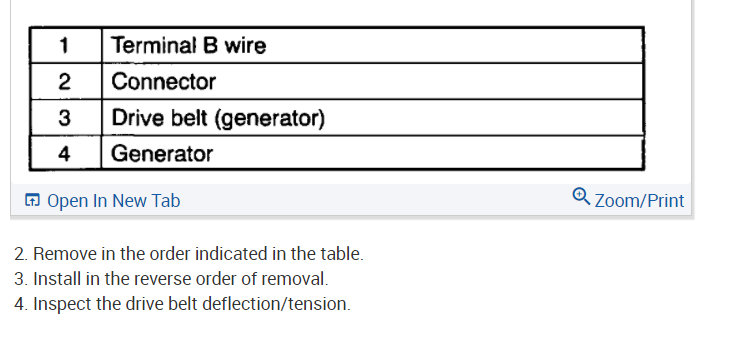

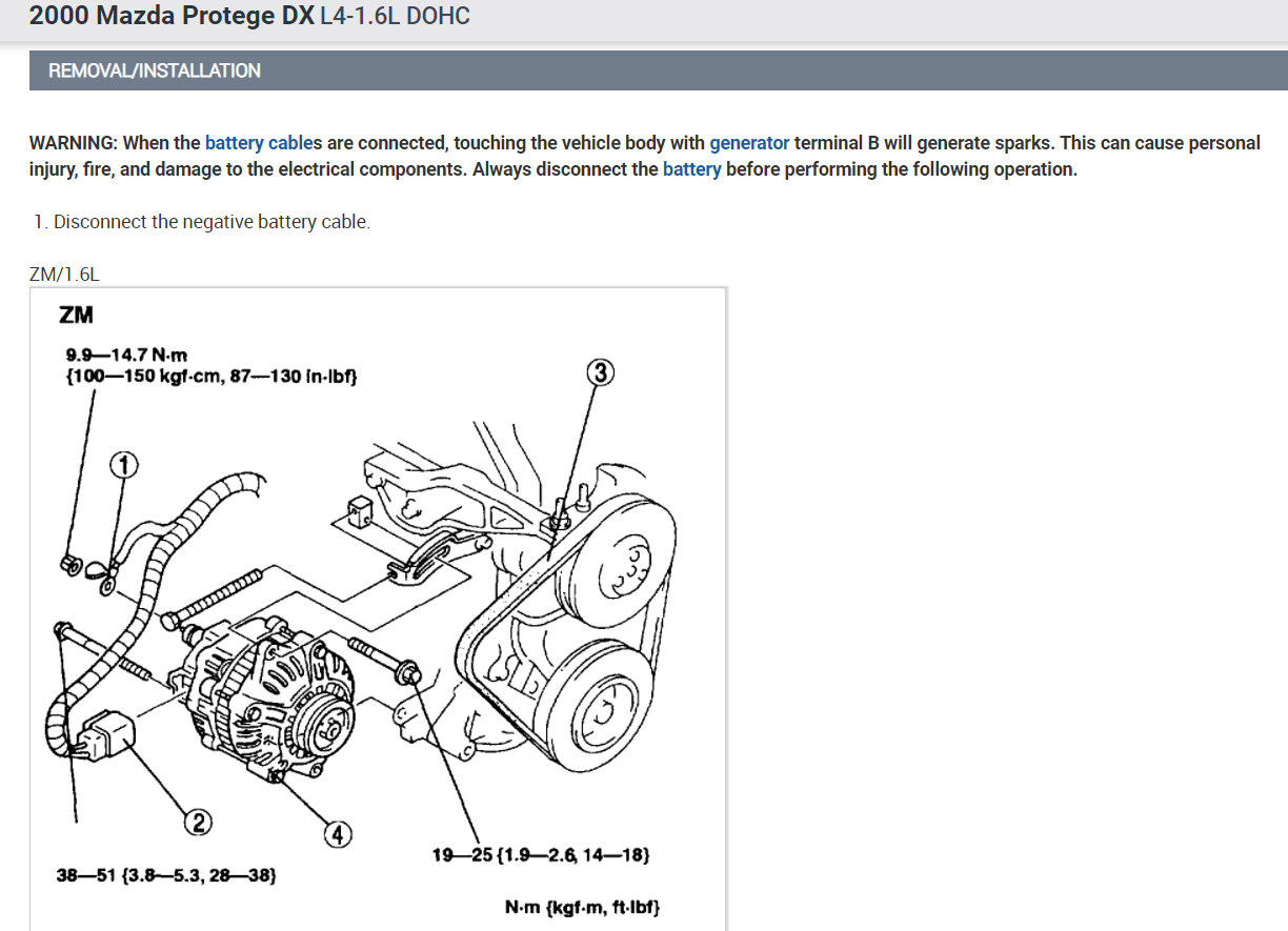

You are welcome we are here to help. Here are the instructions to replace the alternator so you can finish up and get back on the road. Check out the diagrams (below). Please let us know if you need anything else to get the problem fixed.
