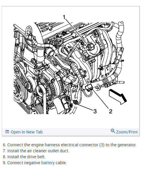

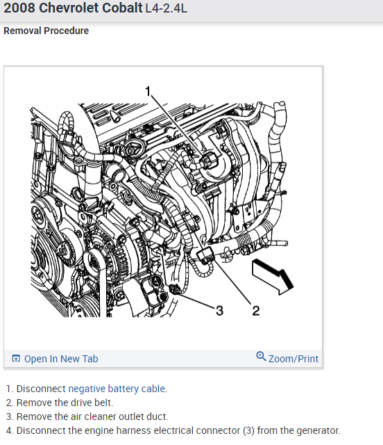

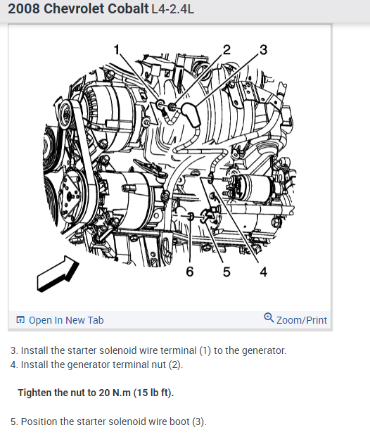

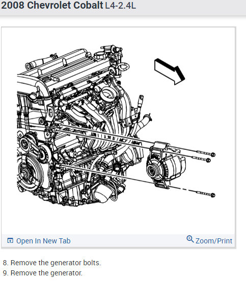

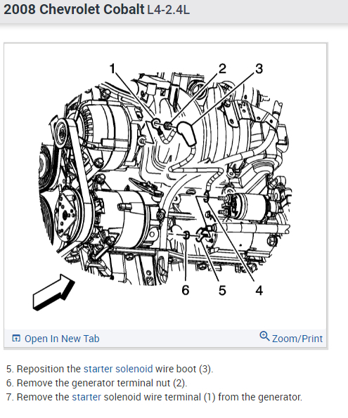

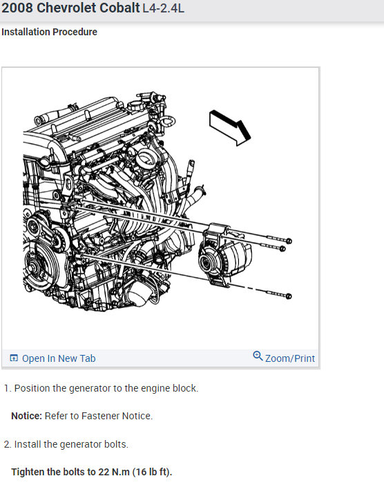

Also attached replacement procedure of the alternator on your car.
