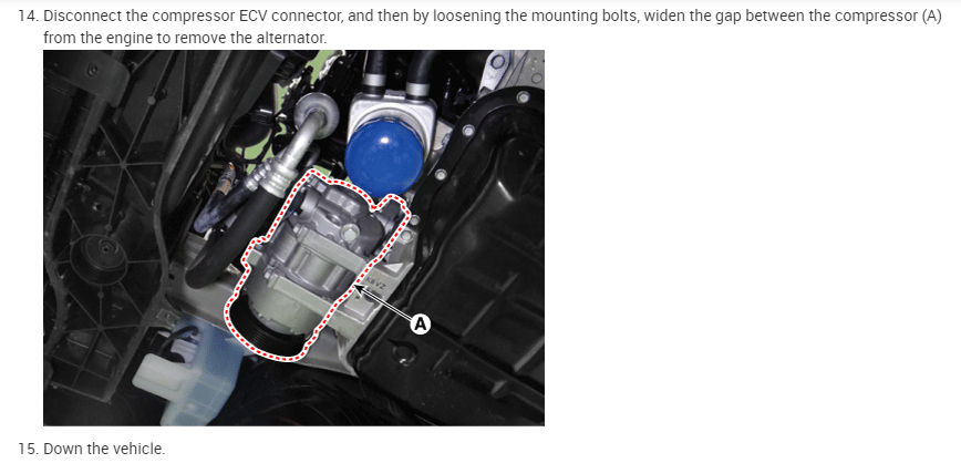

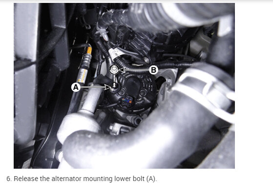

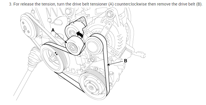

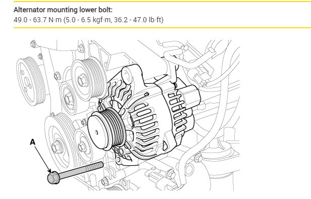

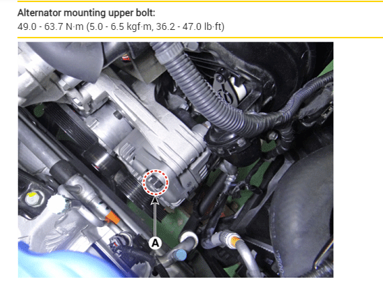

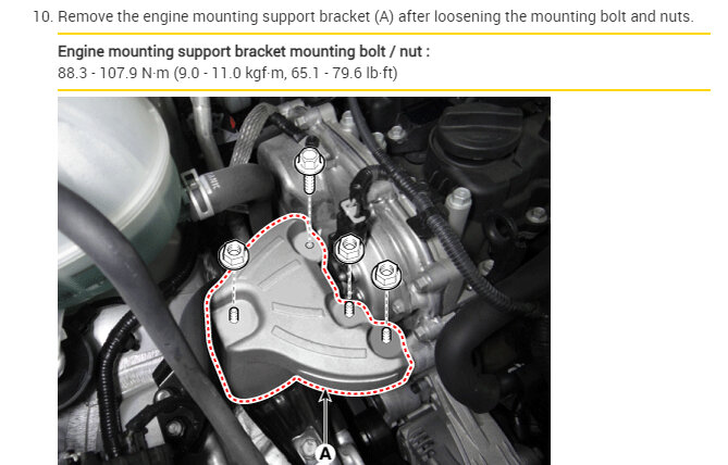

Hi, tomorrow I'm replacing an alternator in the vehicle listed above SX. Can you please provide me with detailed steps with pictures? Also, which is better? To remove the engine mount or A/C compressor? If I remove the A/C compressor, does anything need to be flushed? Please give any warnings ⚠️ or precautions when lowering the engine so I don't seriously mess it up. Thanks, I really appreciate it.
