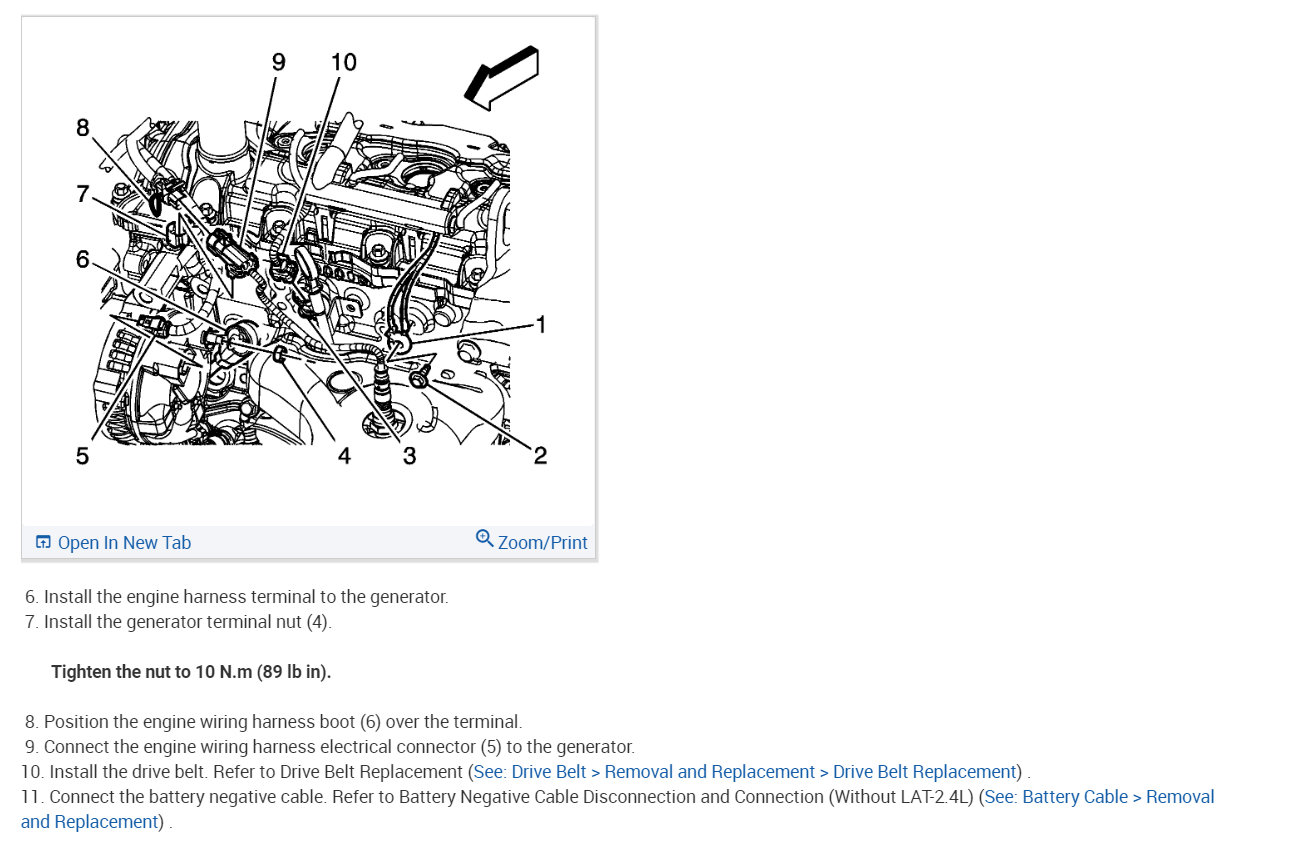

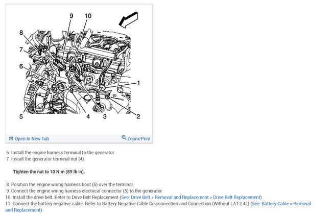

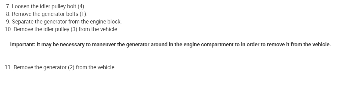

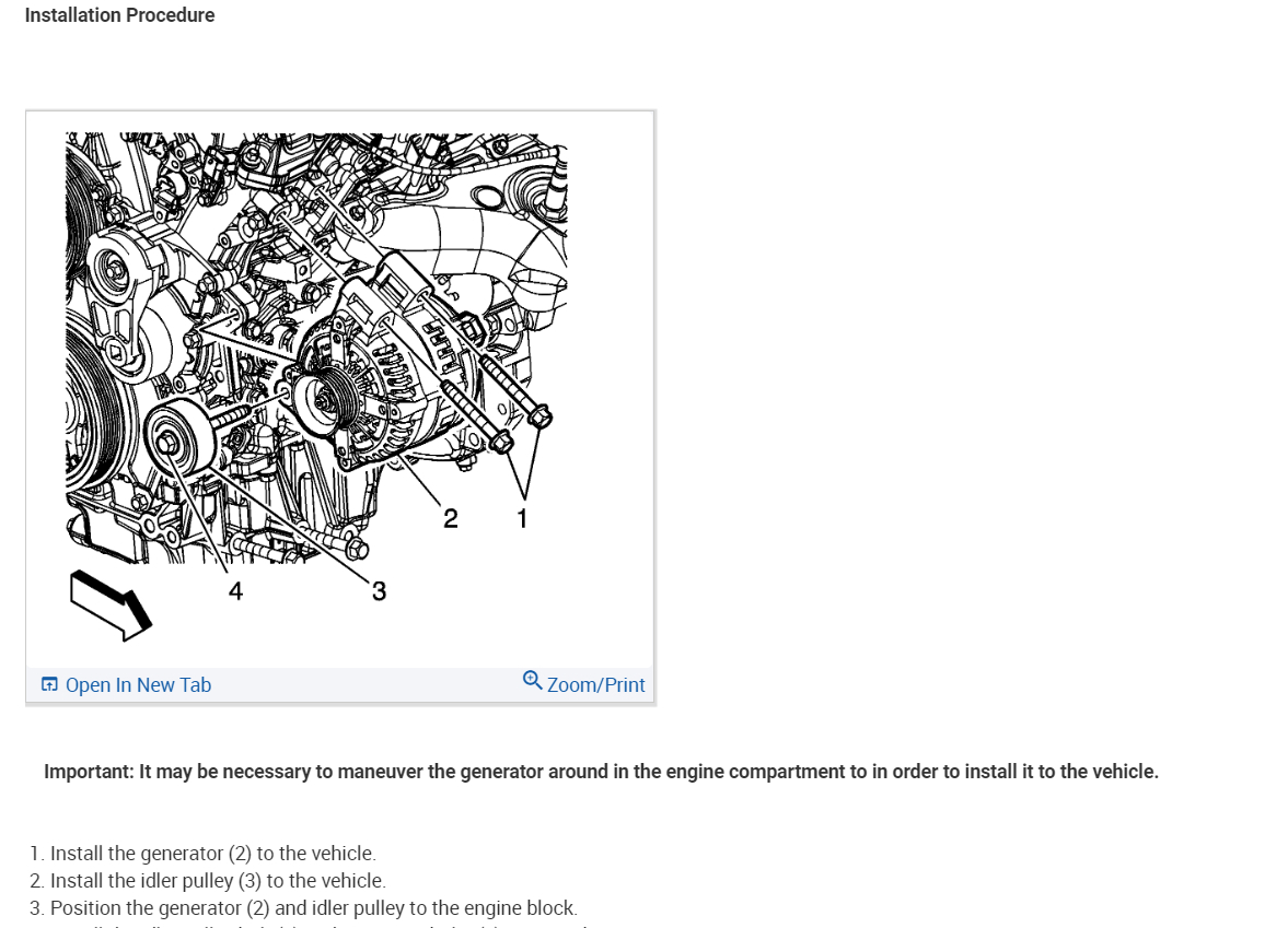

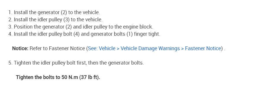

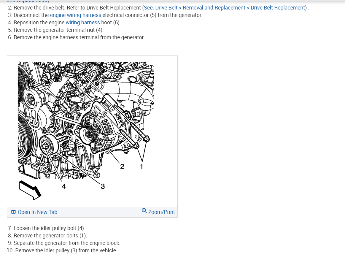

I assume you have the 2.6-liter engine; I have included the alternator replacement instructions in the images below. Starter by disconnecting the battery (negative side). Also, here is a generic guide to help you see what you are getting yourself into when doing the job:
https://www.2carpros.com/articles/how-to-replace-an-alternator
Check out the diagrams (below). Please let us know if you need anything else to get the problem fixed.
