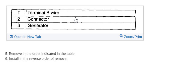

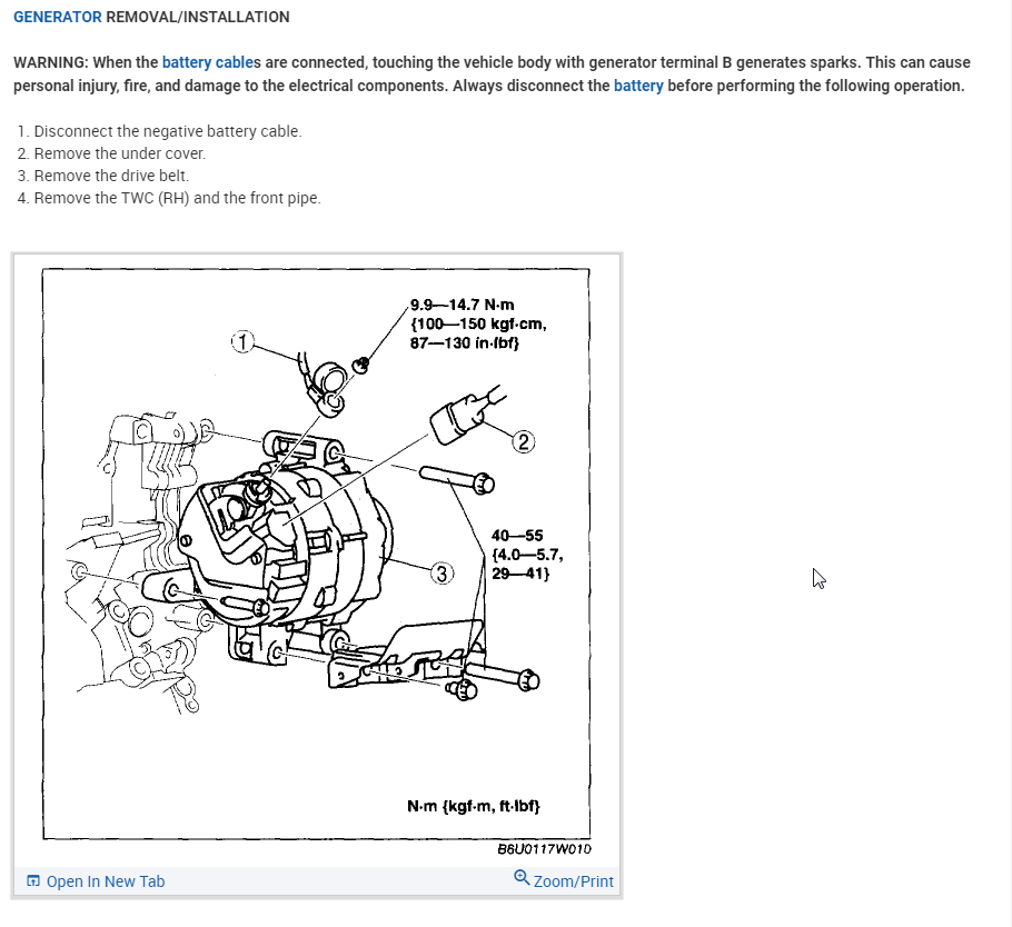

I can’t find a video on how to replace the alternator. I guess my question would be, is changing the alternator any different from the 2003-2005 model because that’s the only model that have video to show you how it’s done.
Aug 23, 2019 at 9:02 AM
I attached the process for your vehicle. I also checked the process all the way back to 2003 and it is the same so if you have a video for those. I think you are safe to follow that process.
Let me know if you need anything else. Thanks
