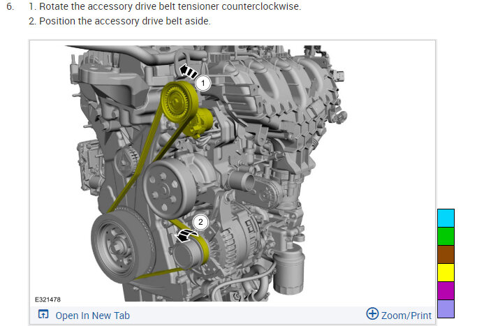

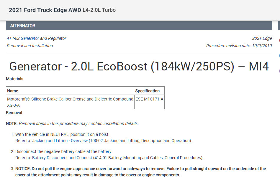

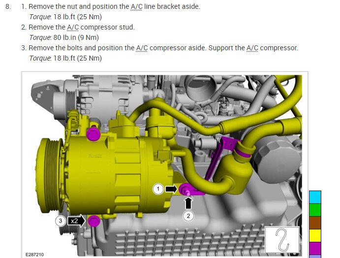

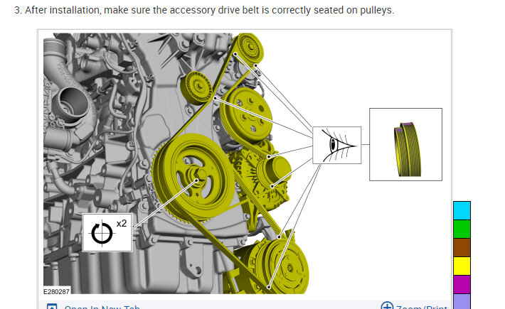

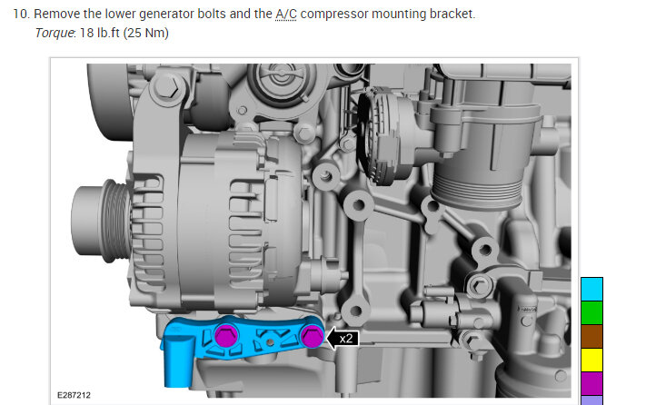

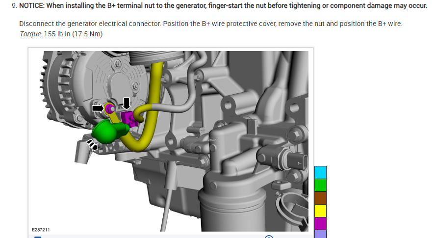

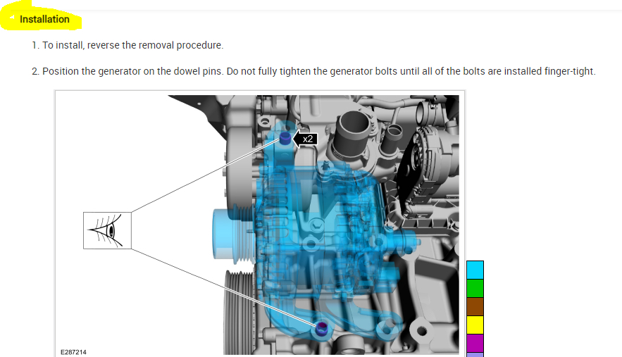

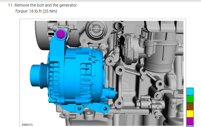

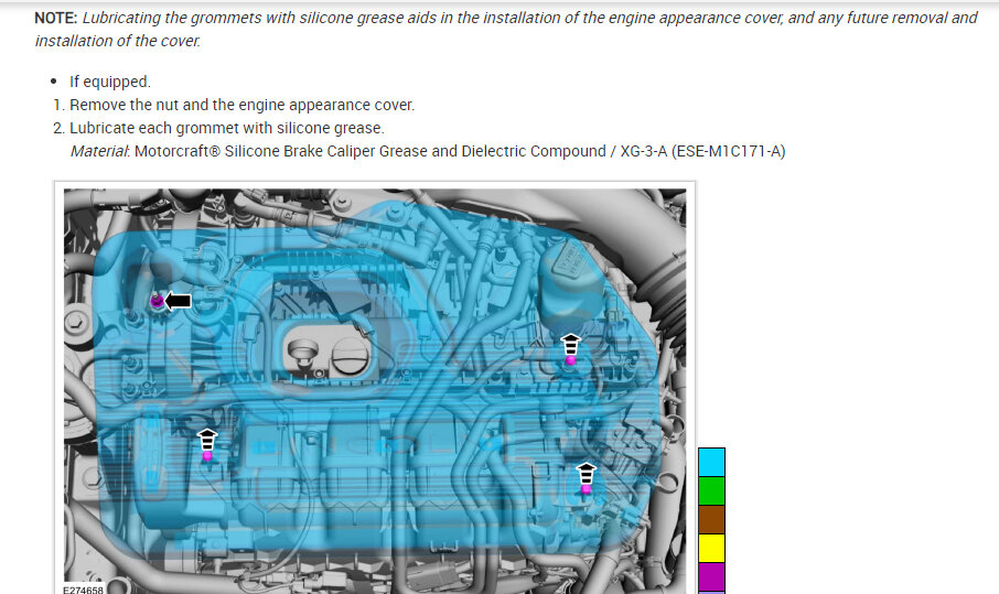

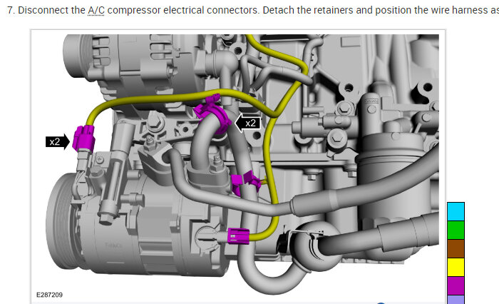

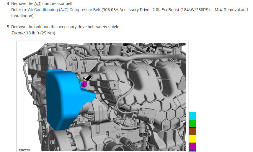

To replace the alternator, you will need to work from under the vehicle. Also, before you start this job, make sure the battery negative terminal is disconnected.
Here is a link that explains in general how it is done:
https://www.2carpros.com/articles/how-to-replace-an-alternator
If you look below, I attached the directions specific to this vehicle. Take a look through them and let me know if you have questions.
Take care and let me know how things work out for you.
See pics below.
