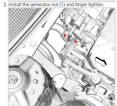

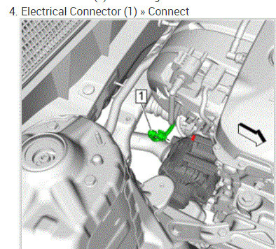

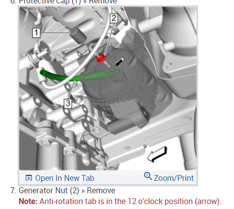

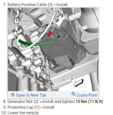

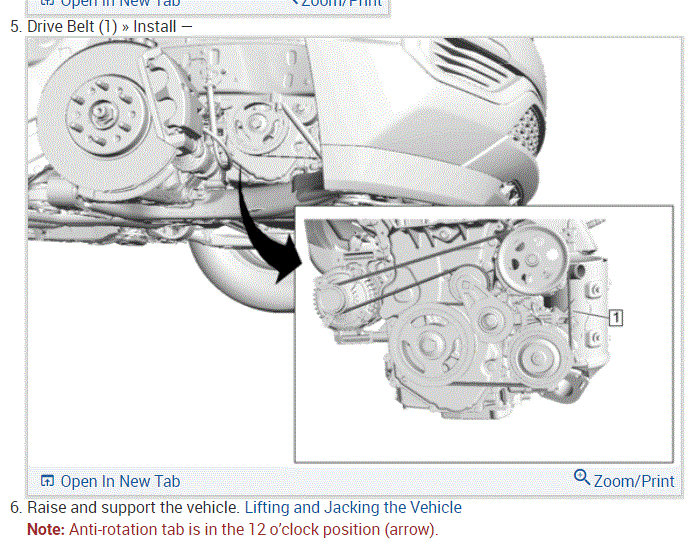

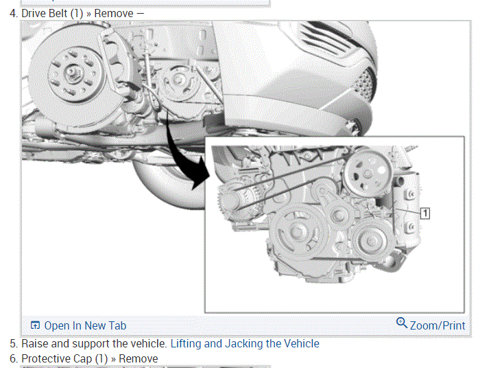

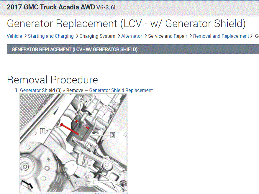

It does sound like the alternator isn't charging. Also, if it failed, it could be placing a constant draw on the battery.
Here is what I suggest: Take a look through this link and test the alternator's output.
If you find the alternator is bad, here is a link that shows in general how one is replaced:
https://www.2carpros.com/articles/how-to-replace-an-alternator

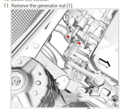

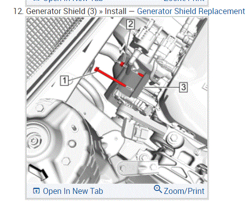

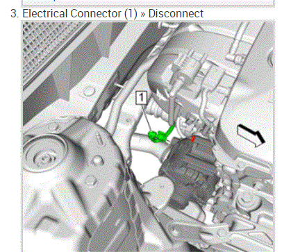

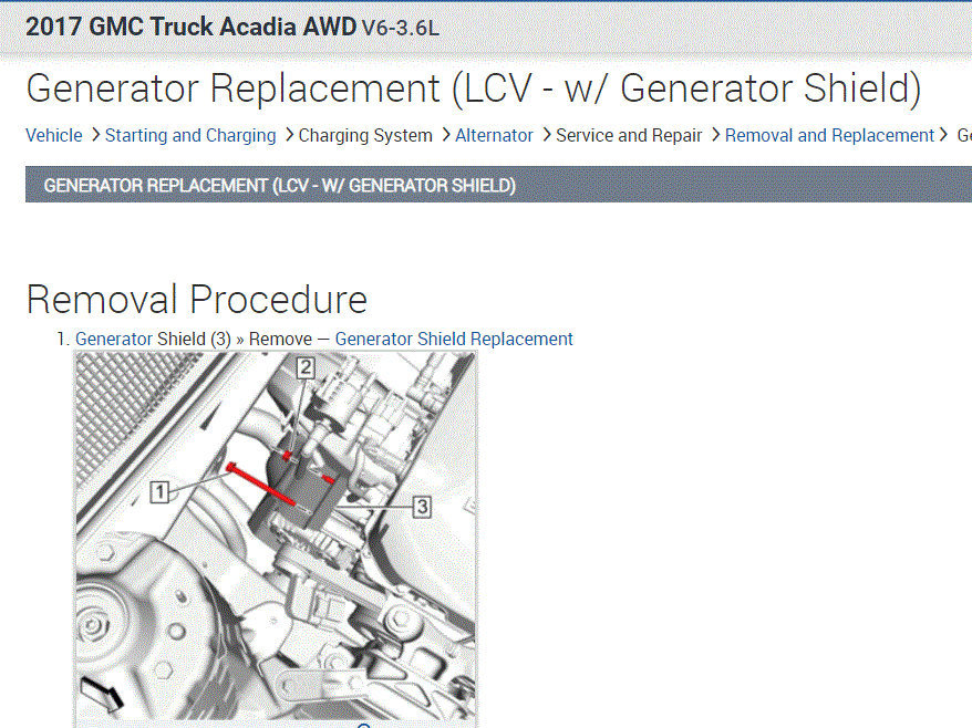

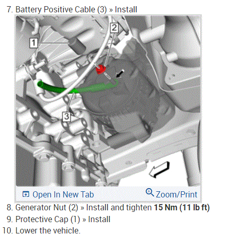

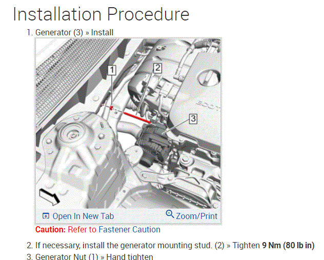

The pics below are directions specific to your vehicle for removal and replacement.
I hope this helps. Let me know if you have other questions.
See pics below

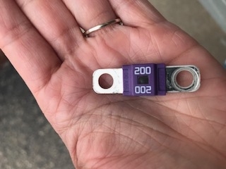

My husband found that the 200 amp fuse that was connected to the wire of the battery post to the alternator is bad. Hopefully a much easier and less expensive fix. He went to multiple dealers yesterday afternoon and none of them could figure out which part to order based on entering the VIN. They printed off a list with part numbers, but when I search the GM part numbers online they all use a generic picture so I have no clue which is correct. This can't be that hard, right?! It's a 200amp/58V SBFW-L M6 bolt type fuse.
Apr 6, 2021 at 6:45 AM
That is the correct part number. That is a bolt in fuse. Please keep an eye on things. It takes a lot to blow a 200 amp fuse. Tell your husband to check all the main wiring to and from the alternator.
