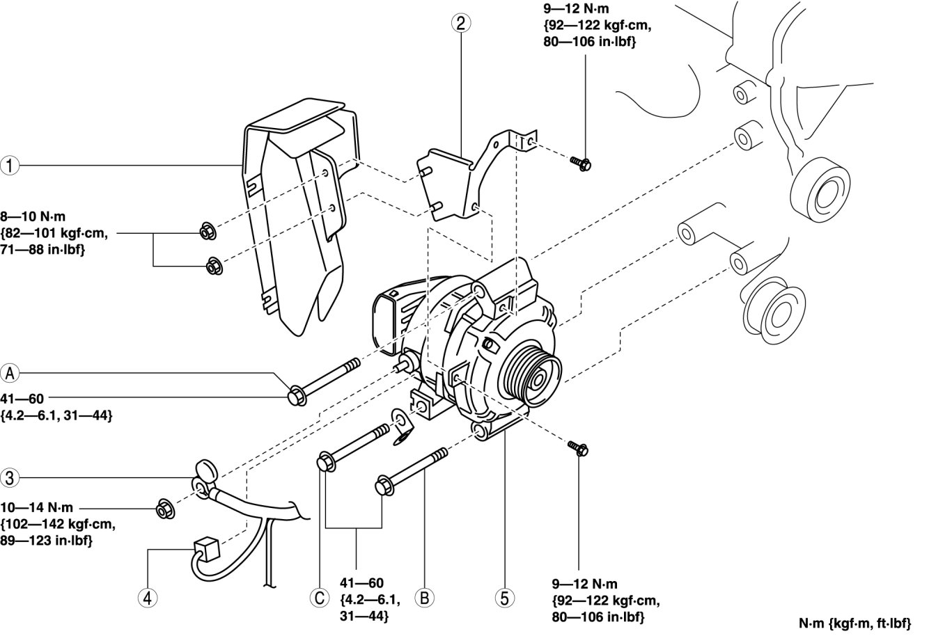

I just ran through the procedure, and see no need to remove the mount or disconnect the AC. Based on the directions, you should be able to move it out of the way.
Here are the directions. The attached pictures correlate with these directions.

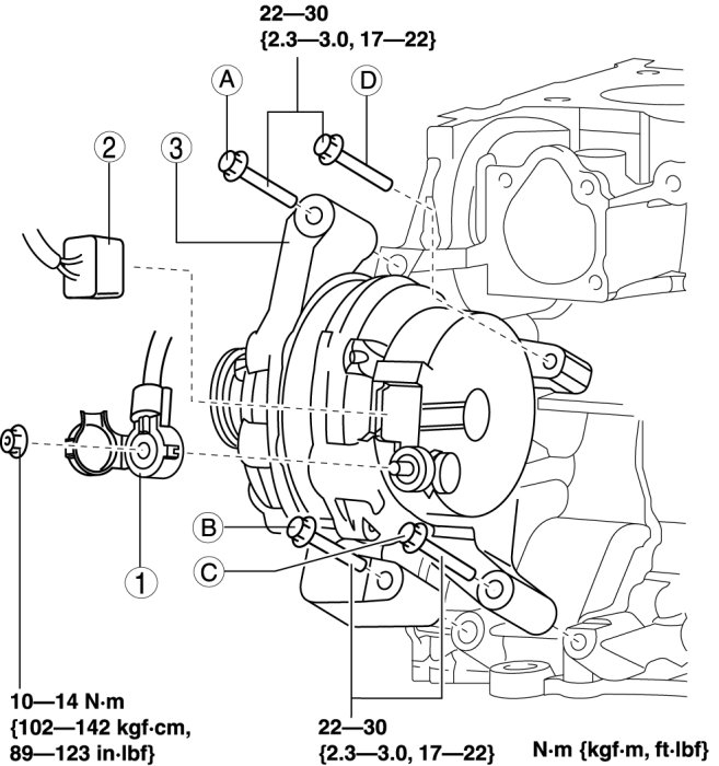

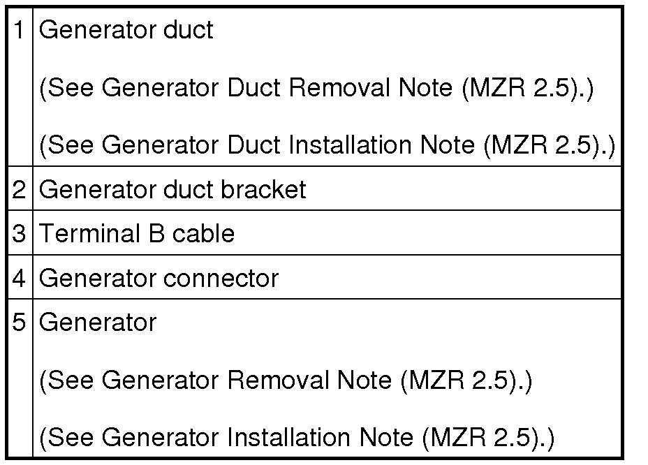

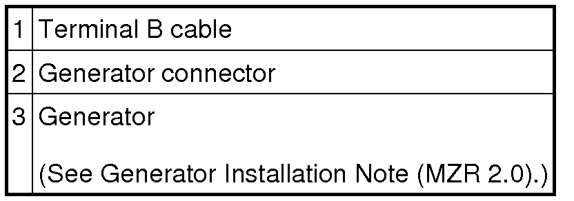

MZR 2.0
pic 1
pic 2

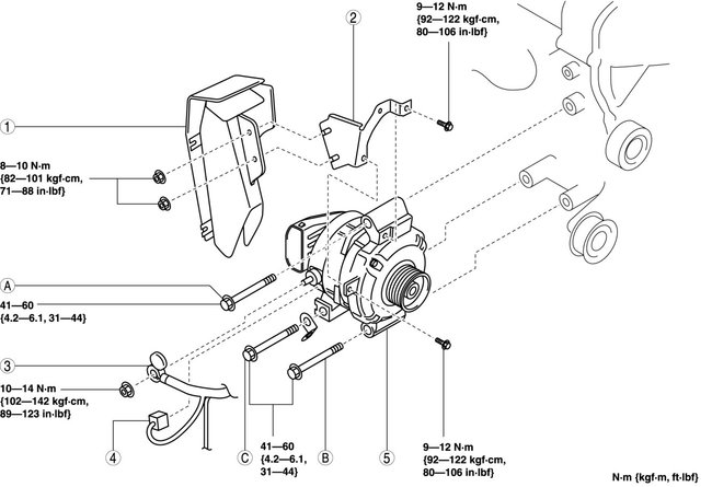

MZR 2.5
pic 3
pic 4
Generator Installation Note (MZR 2.0)
1. Align the generator fixing hole with the engine side hole, then temporarily tighten the generator installation bolts in the order of A, B, C, and D.
2. Securely tighten the generator installation bolts in the order of A, B, C, and D.
Generator Duct Removal Note (MZR 2.5)
1. Remove the generator duct from above the engine compartment.

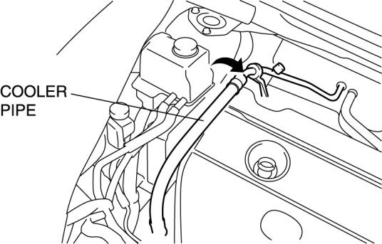

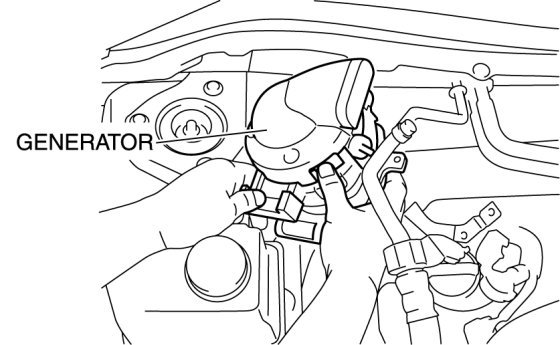

Generator Removal Note (MZR 2.5)
1. Set the cooler pipe out of the way. See: Hose/Line HVAC > Removal and Replacement > Refrigerant Line Removal/Installation
pic 5
2. Remove the generator from above the engine compartment.
pic 6
Generator Installation Note (MZR 2.5)
1. Tighten bolt A temporarily.
2. Tighten bolt B, C to the specified tightening torque.
3. Tighten bolt A to the specified tightening torque.
Generator Duct Installation Note (MZR 2.5)
1. Install the generator duct to the generator duct bracket and tighten nuts temporarily.
2. Tighten nuts to the specified tightening torque.
