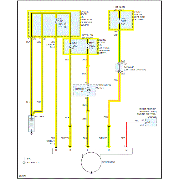

By removing the battery cable while running, the engine should shut off. The alternator requires battery voltage to work.
Besides, by doing that you could damage other modules.
I attached the wiring diagram for you to view.
Why are you testing the alternator? Is there an issue?
