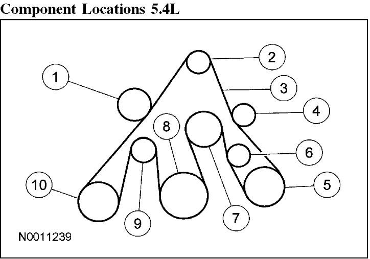

You know, since the batter light was flashing and you smelled something burning, do me a favor. There is a chance the serpentine belt is damaged, came loose and cause the light to come on and the smell. If it is frayed, it may have hit or damaged the crankshaft position sensor causing a no start. The serpentine belt is the long belt at the front of the engine which runs the alternator, power steering pump, water pump and so on. I attached a picture of it below.
