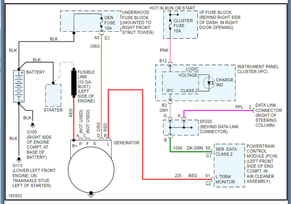

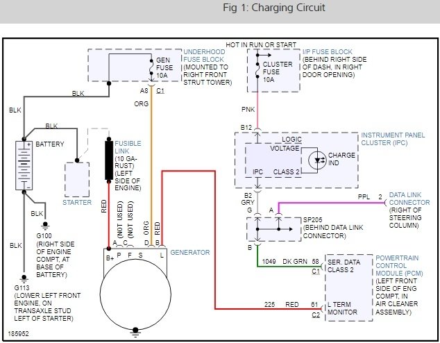

I grabbed you a charging system diagram for your rig. (Below)
On the diagram, the red wire on the left side of the generator (alternator) has a fusible link in it.
More or less, this is a "wire fuse", it's the last line of defense when something really bad happens to the circuit. (ex. crossed jumper cables, etc.)
Test for power right at the alternator on that wire. If it's good there, but not on down the line, you'll need to replace the fusible link.
It is important to replace it with the exact same animal!
It is labeled "10 Gauge", locations of things are labeled on the diagram.
Attempting to bypass this "couple of dollar" item, might have you fighting fire under your hood/ your whole garage!
Do it right!
Return with good news!
