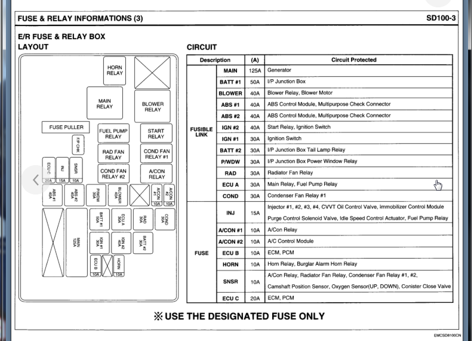

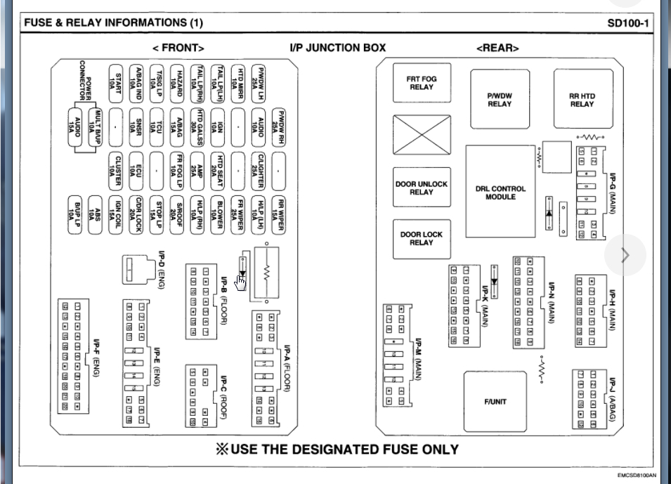

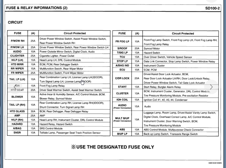

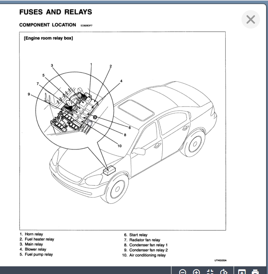

i accidently cross battery terminals and then replaced alternator. alternator wont charge still. i cannot find any fuses?
May 14, 2013 at 3:29 PM
CERTIFIED EXPERT
18,907 POSTS
Below is the info you are looking for.
However, here are a couple guides that will help with testing fuses and relays:
Please see below for the fuse info. Let us know if you have other questions.
