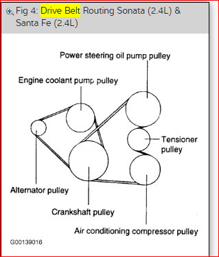

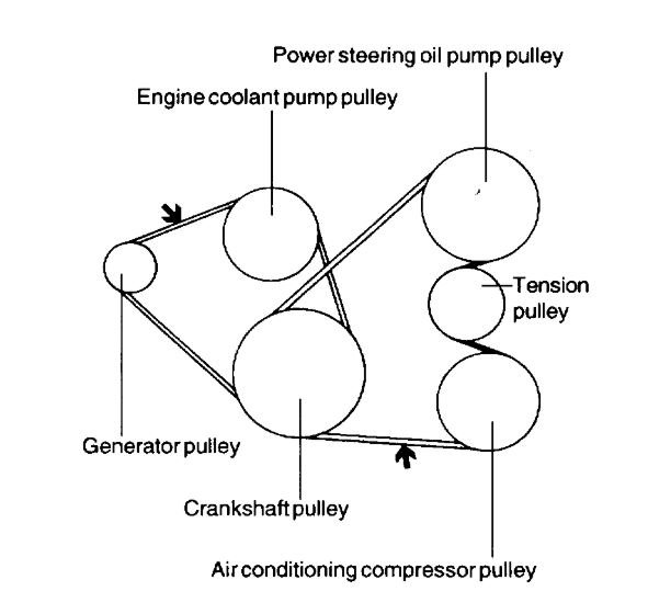

Alternator will not adjust. It hits the block before will go on. Neither one has been removed from the car. Pulley bolts came out, were replaced, alternator will not adjust enough to reinstall belt even with adjuster removed.
