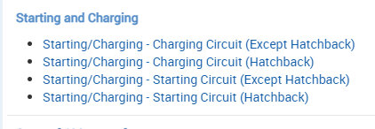

For some reason, there is a difference between a hatchback and a sedan. So, I went with the sedan. If that is wrong, let me know. (See pic 1 below)

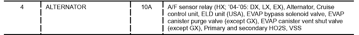

The fuse you are referring to powers several different things. (See pic 2 below) You indicated the wiring harness was replaced. Was it the harness for the alternator only?

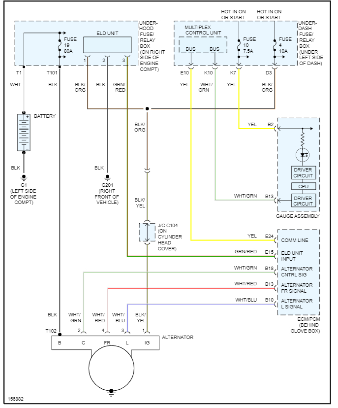

The number 4 fuse 10 amp feed the ELD unit in the fuse panel and the alternator so there is a chance the alternator is defective or the wire from the fuse panel it is touching ground or the ELD unit is going bad. here is the alternator wiring diagrams and a guide to help you test the circuit in the images below.
