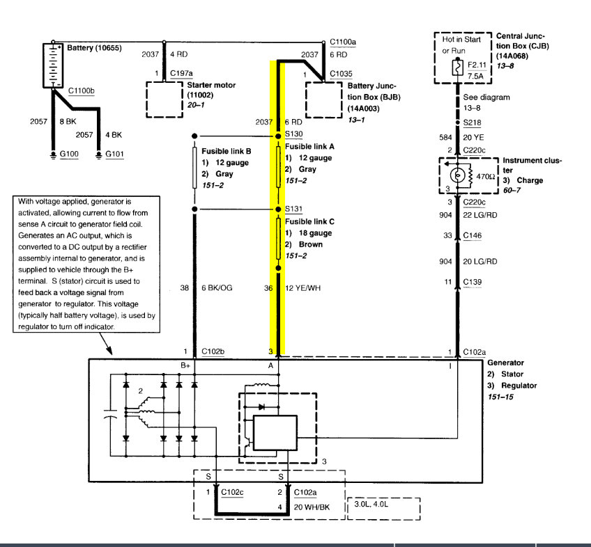

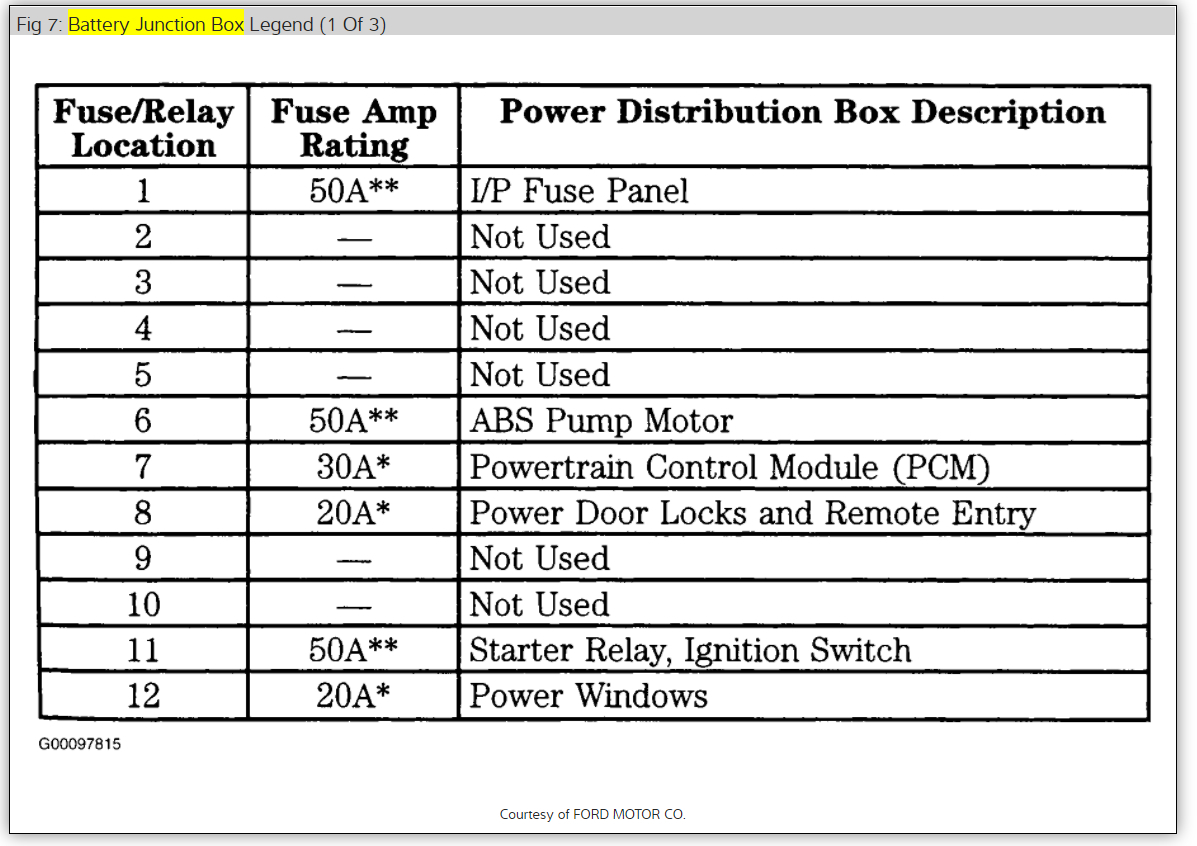

i was in barstow last weekend and i was running the truck prety hard in the dirt, i then later at night we went for a small drive, about a half mile away and parked the car car with my hellas left on. the lights started to dim about five minutes in... went to start it.. nothing, push started it... it would idle very rough and instead of revving" it would die, battery light on, gauge says low. towed back to camp. charged battery for an hour. car starts fine, battery says low and light stil on. the next day we headed home started fine, drove about three miles then it died.. so i figured the alt is bad. my friend followed me suspecting this wold happen so we changed batteries. i used his truck battery all the way from barstow to huntington beach (90miles) low battery gauge, battery light on, made it home... truck doesnt have a manual, its just about impossible to find fuses and relay locations online. wut do u think?
