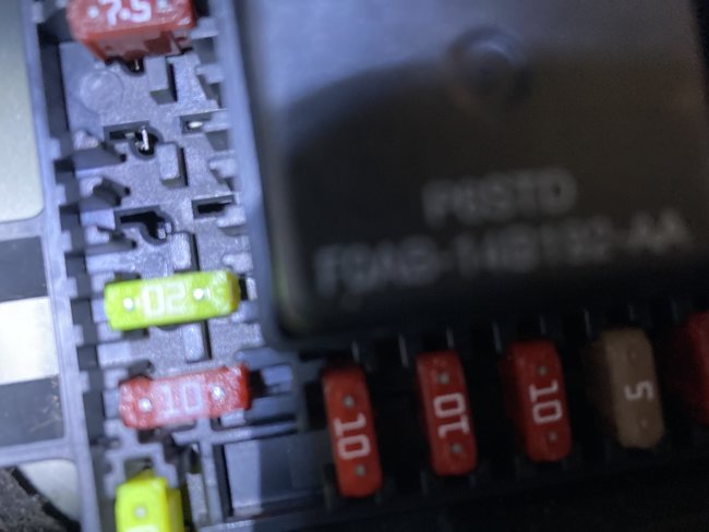

Apparently, Ford changed over to their Smart Charge system in the 2004 model year with the Expedition. Mine was made July 2003, lists as a 2003, but I'm wondering if it might have the 2004 charging system? If so, I might have the wrong alternator even though it's supposedly the correct one for a 2003 Expedition. Looking at photos of allegedly compatible remanufactured fuse panels, some show a fuse in the #9 slot and some don't. Part number is 3L7T-14A067-AC. The user manual that came with the car shows a 10A fuse in that slot. Am I just wasting time trying to get a fuse in there? Photo of fuse panel attached. I pulled the fuse above it for comparison.
Aug 20, 2022 at 2:02 PM

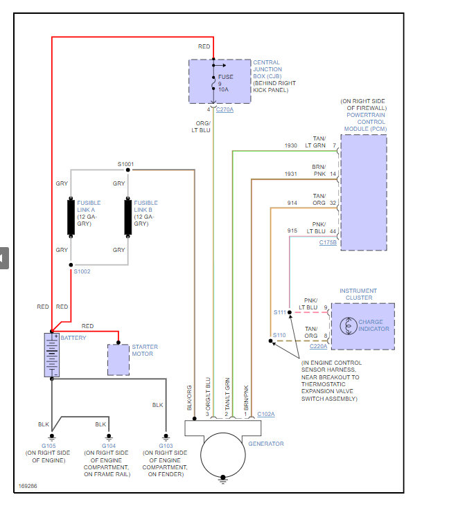

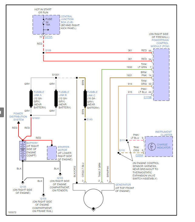

Yep, I think you have the 2004 system which doesn't have a # 9 fuse. I would check the alternator plug terminals and look for signs of overheating, if so, you need to get a new pigtail and wire it in. Also check the condition of the fusible links, here are both the 2003 and 2004 wiring diagrams for the alternator and charging system. Also, what brand alternator are you using? Check out the diagrams (below). Please let us know what you find. We are interested to see what it is.

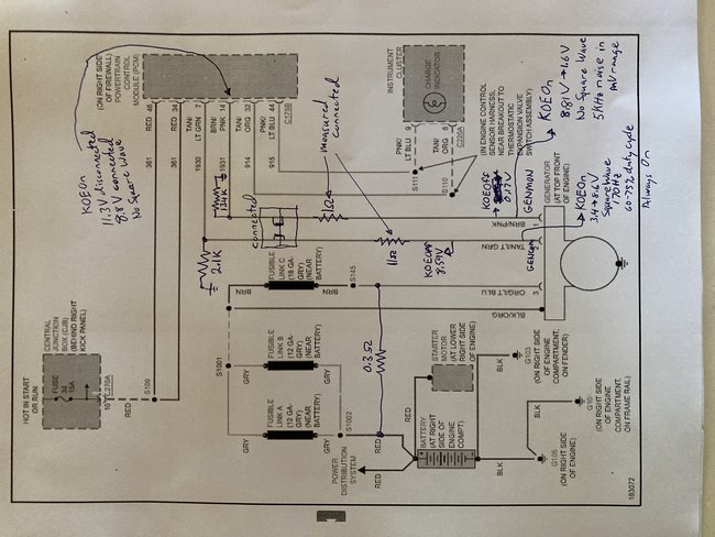

I am pretty sure at this point that the alternator is defective. It seems to be the correct type, but never sends an amp output square wave (duty cycle) back to the PCM. See image below:
I don't know why your software rotated it. Hopefully you can copy and rotate it vertically as intended.
